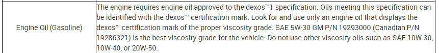

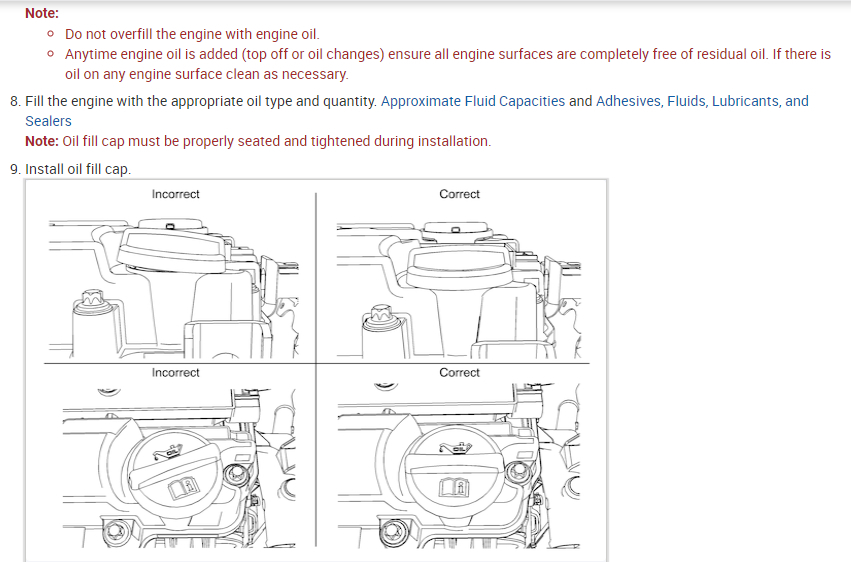

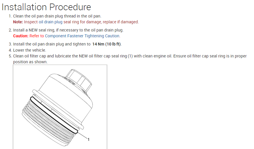

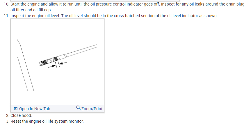

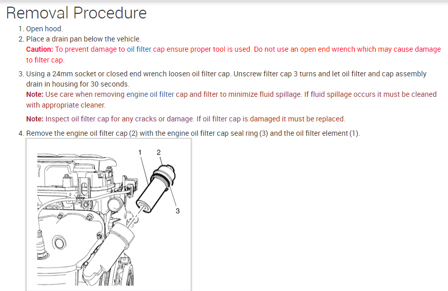

What is needed for changing oil?
Aug 7, 2021 at 4:20 AM
DANNY L
  • 5,648 POSTS
Hello, I'm Danny.

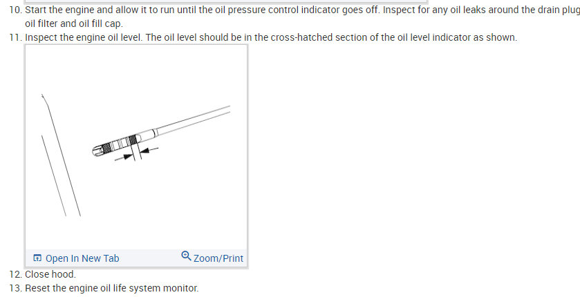

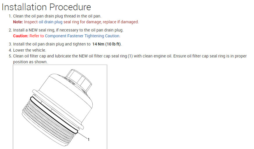

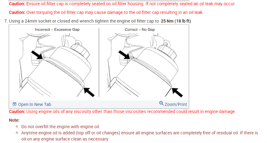

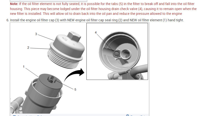

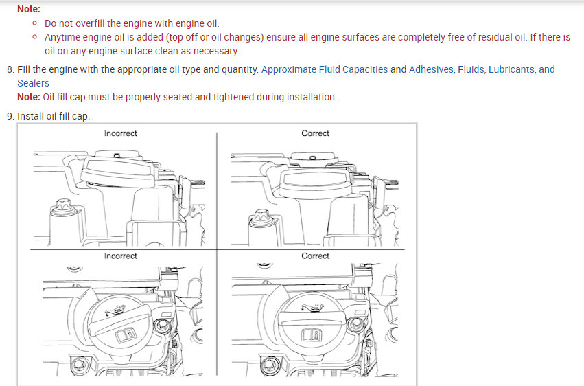

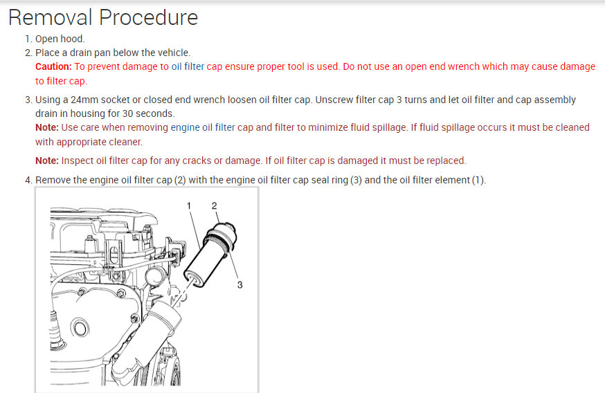

Here is the information you requested. This is a tutorial for you to view on how to change engine oil:
https://www.2carpros.com/articles/how-to-change-engine-oil-and-filter
I've attached picture steps below on how to change the engine oil on your car. I've also attached a picture below showing the specified engine oil required for your vehicle. Hope this helps and thanks for using 2CarPros.
