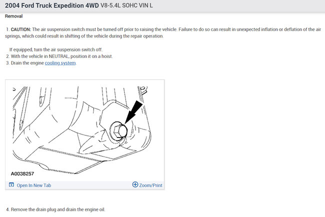

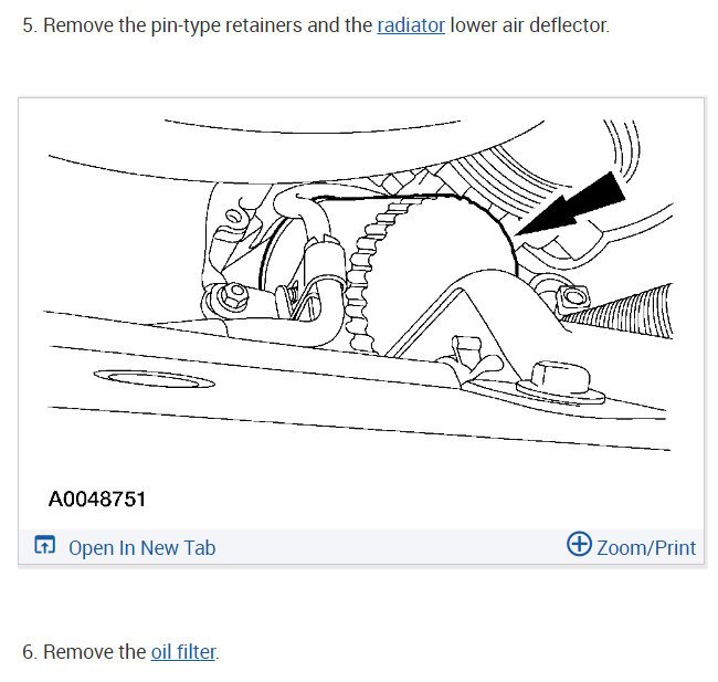

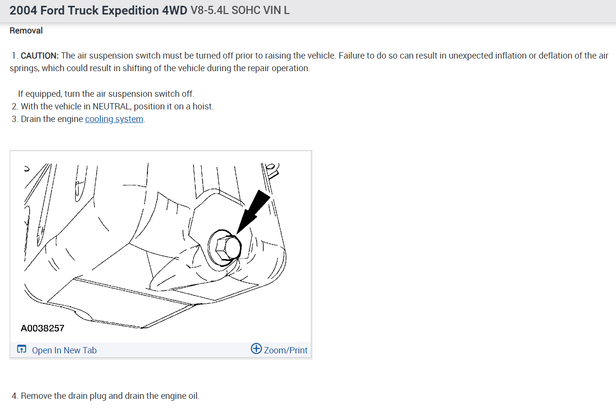

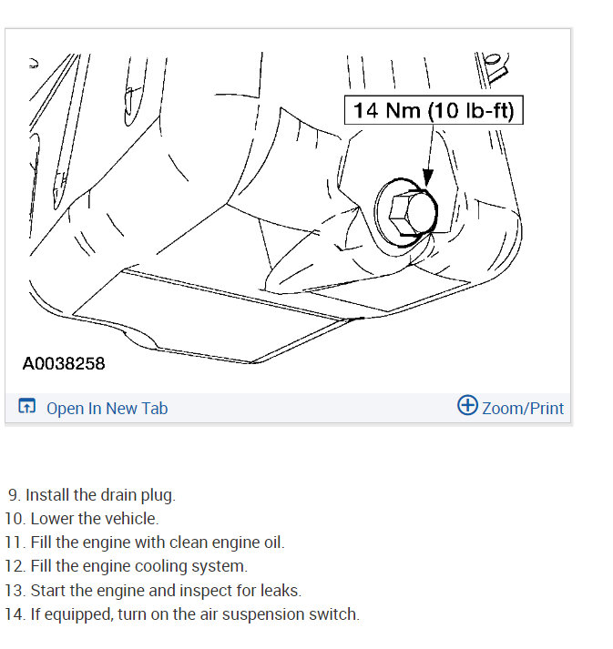

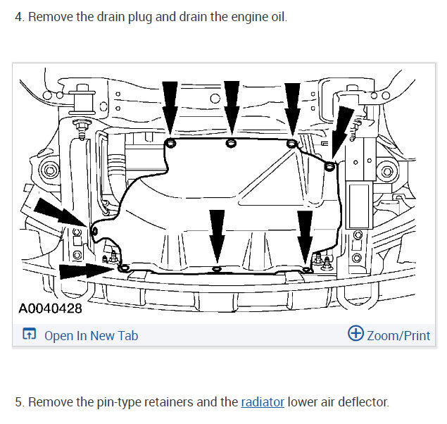

I have the vehicle listed above XLT model. I need a complete list of how and the placement of the old filter.

Yep, here is the instructions and a video on how to change the engine oil and filter for your vehicle:
https://youtu.be/IanGHAdATkA?si=drWthkx8Os16wiv1
Fluid Types
Ford Part Name
- SAE 5W-20 Premium Synthetic Blend Motor Oil
Ford Part #
- XO-5W20-QSP or equivalent
Ford specification
- WSS-M2C153-H
Capacities
Engine Oil Capacity
4.6L and 5.4L Engine .................... 5.7L (6.0 qt)*
5.4L (4V) Engine .................... 6.62L (7.0 qt)*
* With filter.
Check out the images (below). Let us know if you need anything else.
