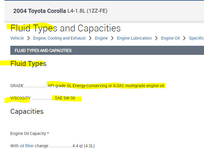

Is a Synthetic oil change or conventional oil change better for the car listed above?
May 25, 2024 at 11:25 AM
  • 110,244 POSTS
Please understand, this question prompts a personal opinion from me. Nothing is listed indicating one over the other.

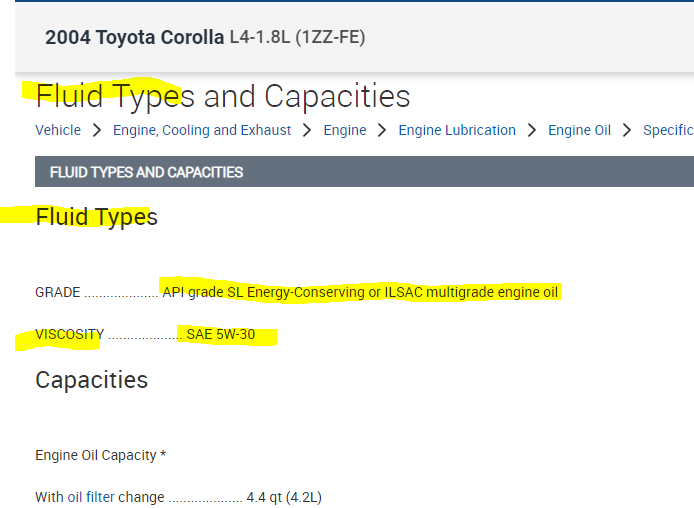

Because of the model year and what the vehicle came with originally, I would recommend using a conventional oil in the vehicle or even a synthetic blend oil. A full synthetic isn't required and is not cost-effective.
I attached the manufacturer's oil type specifications below. That is what I would recommend.
Let me know if this helps and if you have other questions.
See pic below.
