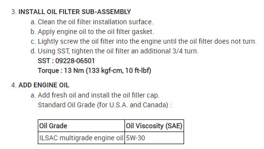

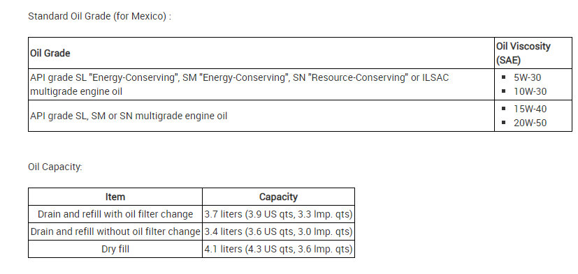

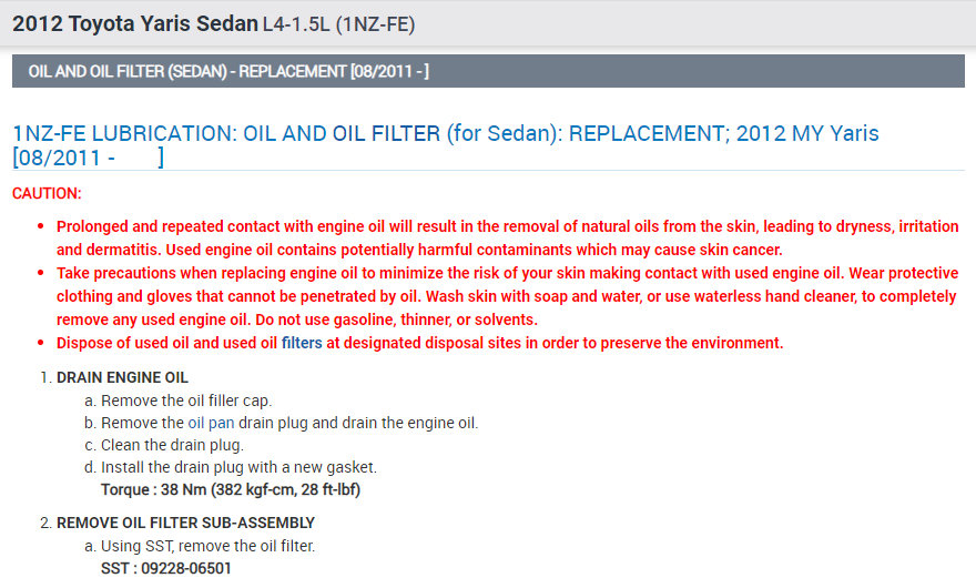

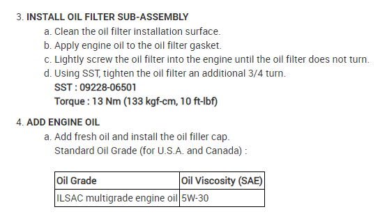

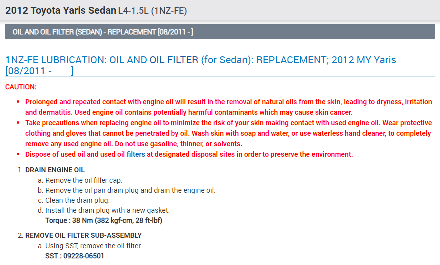

I'm trying to change the oil on the vehicle listed above and I'm trying to find the repair manual instructions.
Mar 3, 2021 at 12:52 PM
DANNY L
  • 5,648 POSTS
Hello, I'm Danny.
Here is the information you requested. This is a tutorial for you to view on how to change engine oil and the filter:
https://www.2carpros.com/articles/how-to-change-engine-oil-and-filter
I've attached picture steps below on how to change the engine oil and filter on your vehicle. Hope this helps and thanks for using 2CarPros.

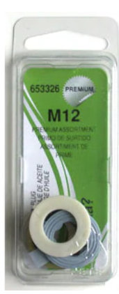

What kind of drain gasket goes on?
Mar 3, 2021 at 9:44 PM
DANNY L
  • 5,648 POSTS
Hello again.
You can find it at your local auto parts store to save money instead of going to a Toyota dealership. The drain plug is size M12. I've attached a picture below from AutoZone auto parts of what it looks like. Hope this helps and thanks for using 2CarPros.

Is that 2 different kinds and does it matter how it goes on?
Mar 4, 2021 at 6:30 AM
DANNY L
  • 5,648 POSTS
Hello again.
That was just a picture from an assortment pack. Any M12 drain plug gasket will work. If the gasket has ridges then put the flat side towards the oil pan. Just be sure to not overtighten the drain plug to prevent stripping. Hope this helps and thanks for using 2CarPros.
