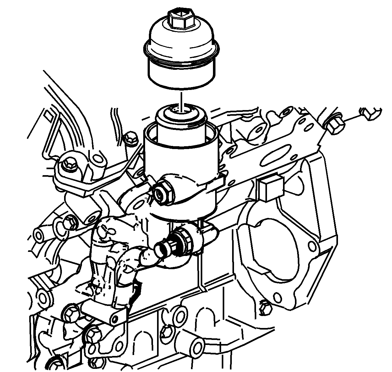

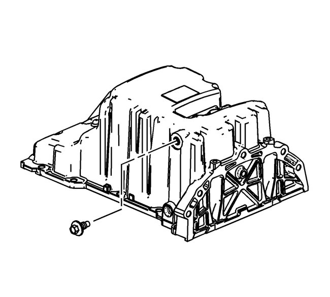

I can"t locate oil filter or oil pan/drain plug.
Aug 5, 2019 at 5:59 AM
BMDOUBLE
  • 1,139 POSTS

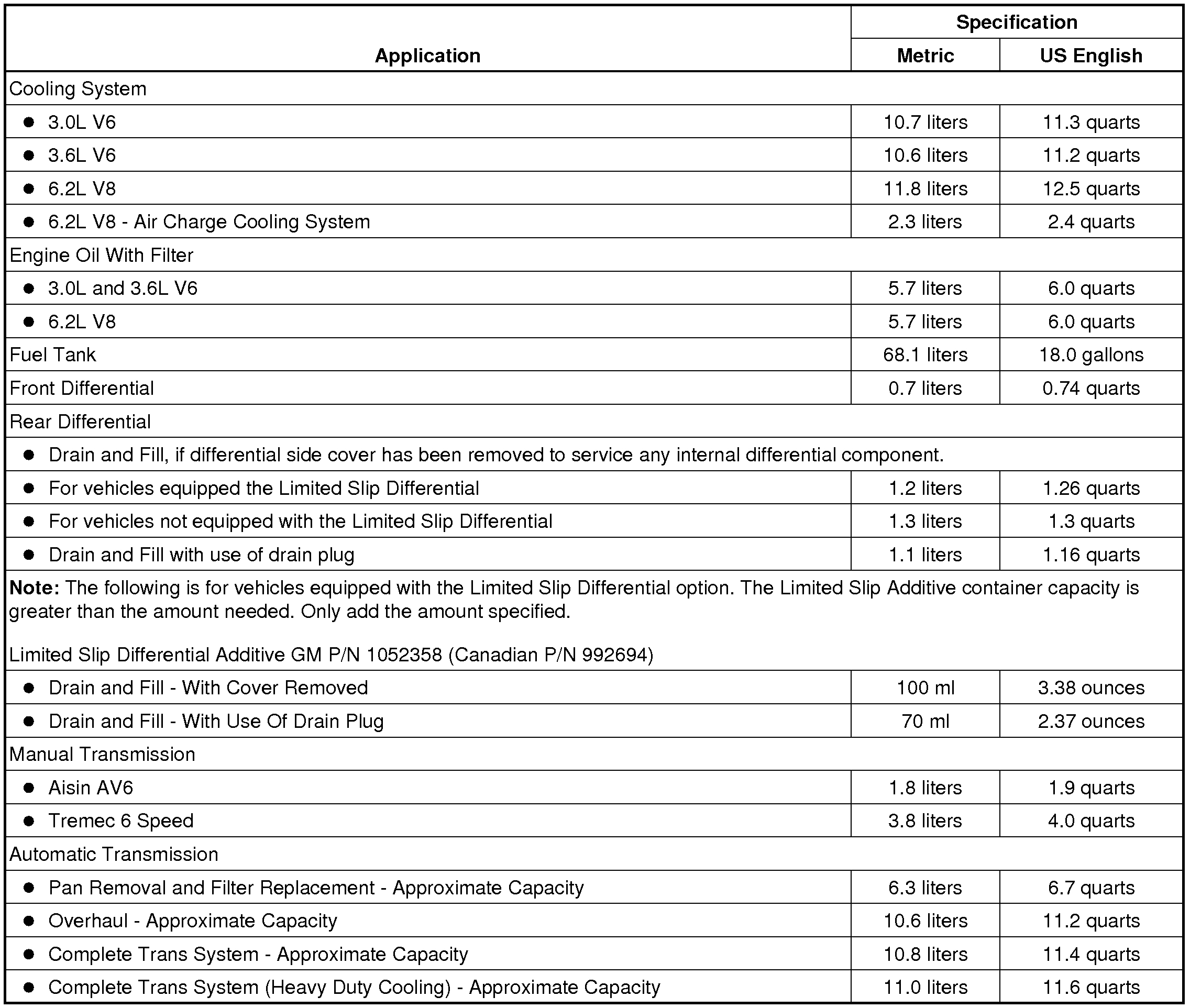

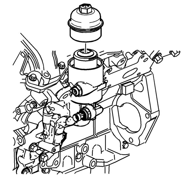

Here are some pictures of the locations of the drain plug and oil filter. I also included the oil capacity chart.
Aug 5, 2019 at 7:00 AM
T-BONE16
  • 6 POSTS
Is the filter location on the drivers side next to the dipstick?
Aug 5, 2019 at 11:47 AM
BMDOUBLE
  • 1,139 POSTS
Yes.
Aug 5, 2019 at 11:49 PM
T-BONE16
  • 6 POSTS
Is the drain plug underneath the front drivers side axle?
Aug 6, 2019 at 4:26 AM
BMDOUBLE
  • 1,139 POSTS
Yes and it should be a 15mm head on it.
