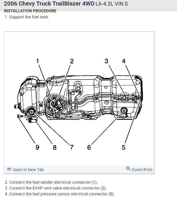

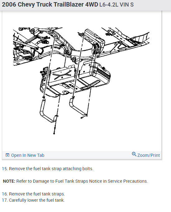

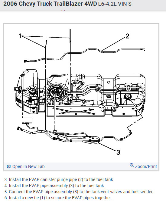

gas tank removal and flush?
2006 CHEVROLET TRAILBLAZER
85,000 MILES • 4 CYL • 4WD • AUTOMATIC
KHOEFLING
I put oil booster in the gas tank, have not started car.
Sep 17, 2018 at 8:48 PM
SQM
  • 6,383 POSTS

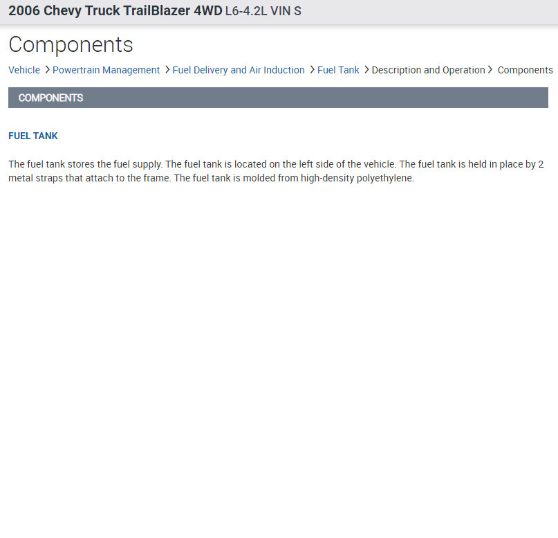

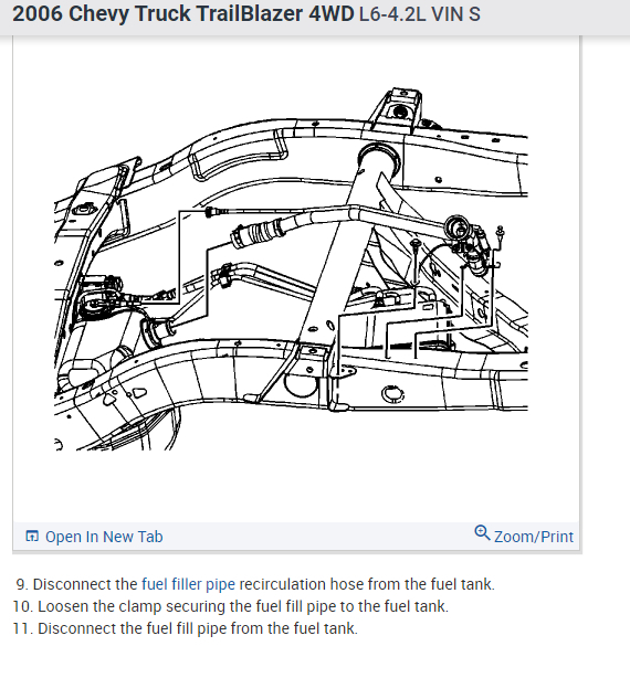

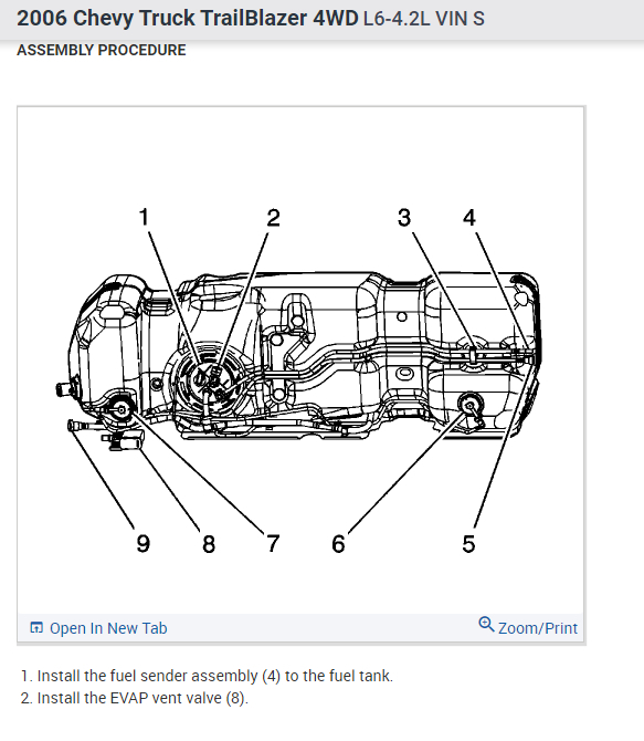

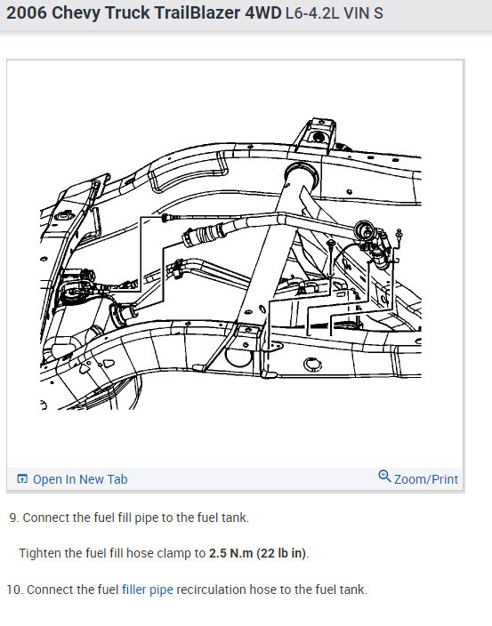

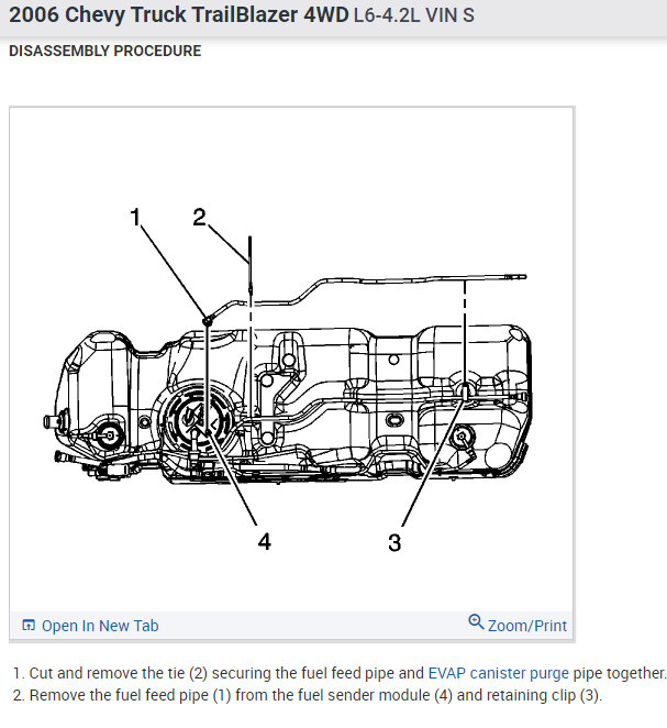

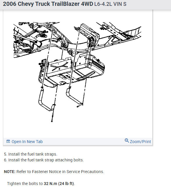

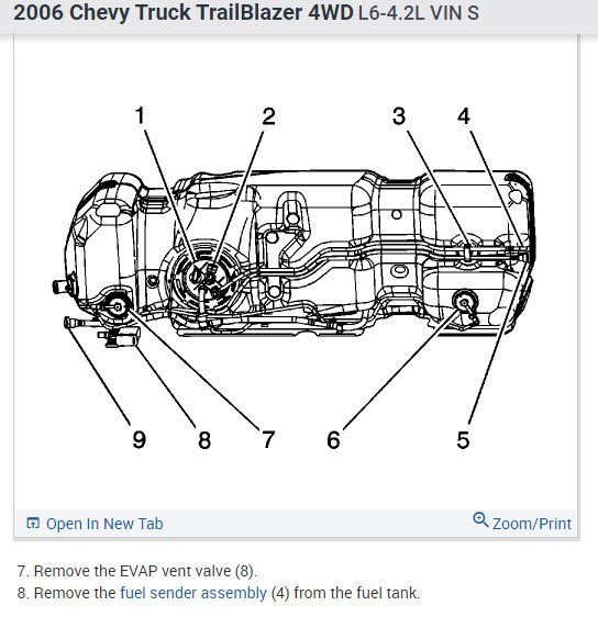

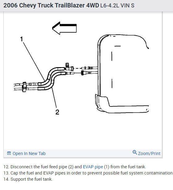

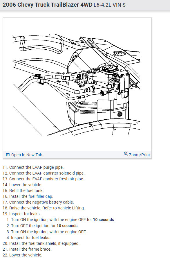

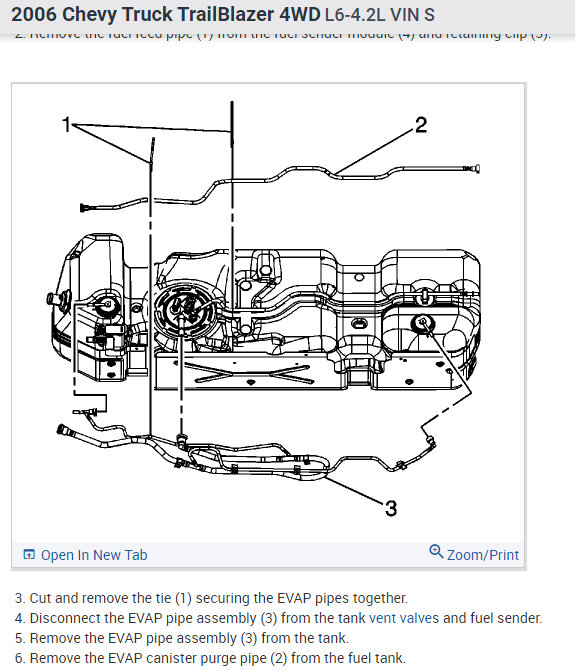

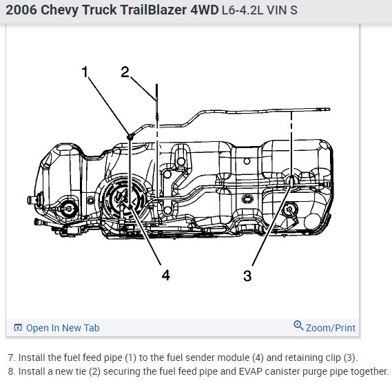

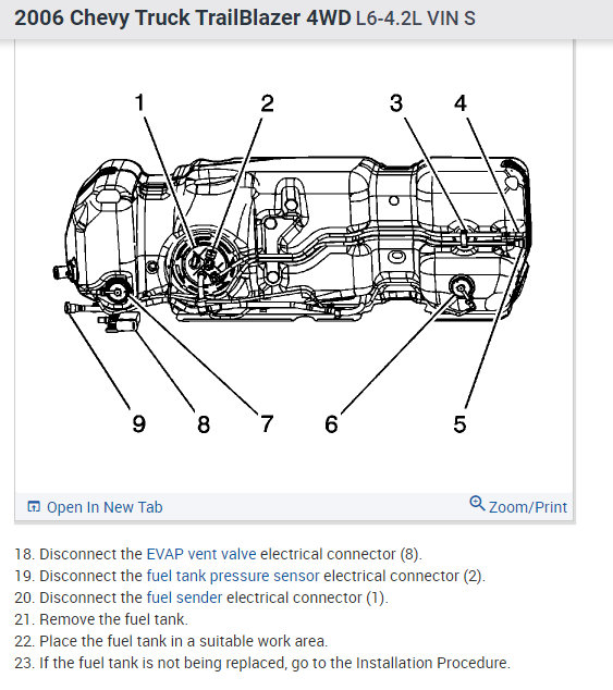

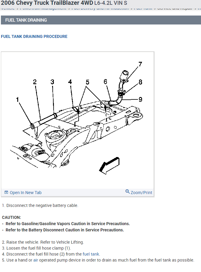

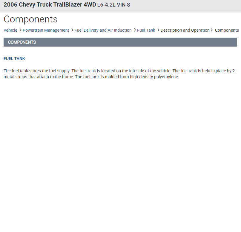

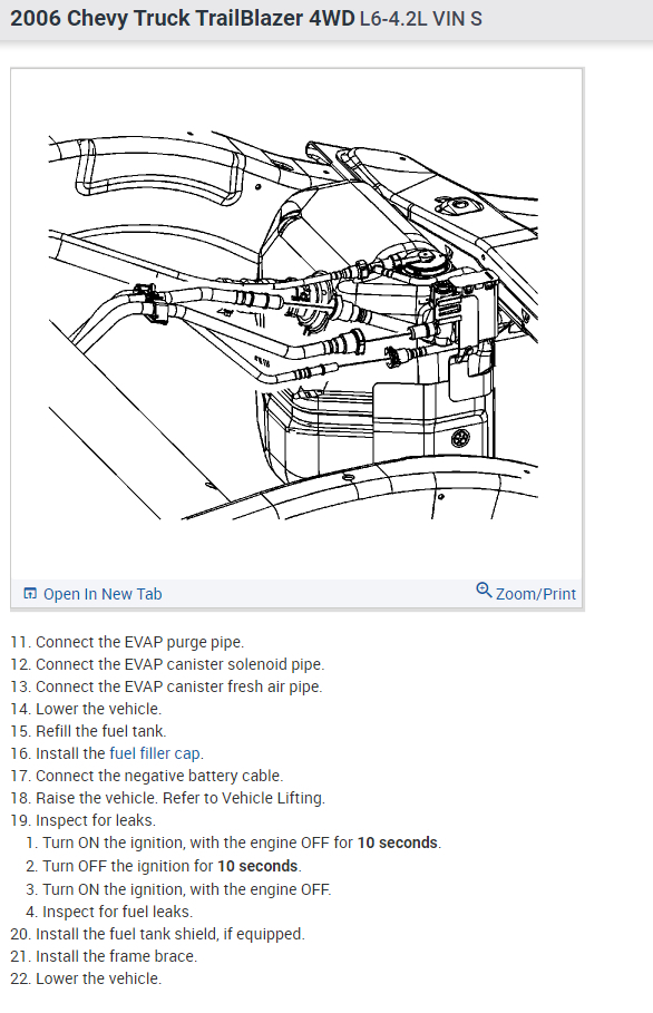

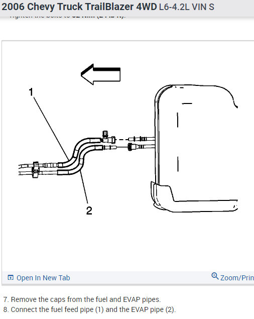

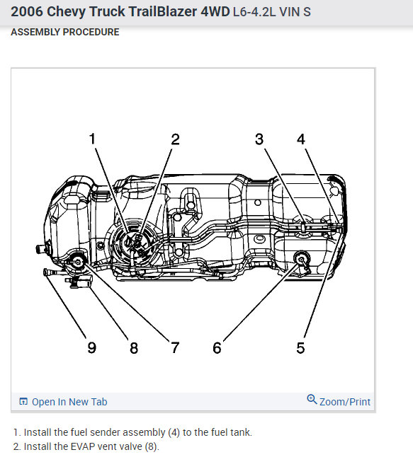

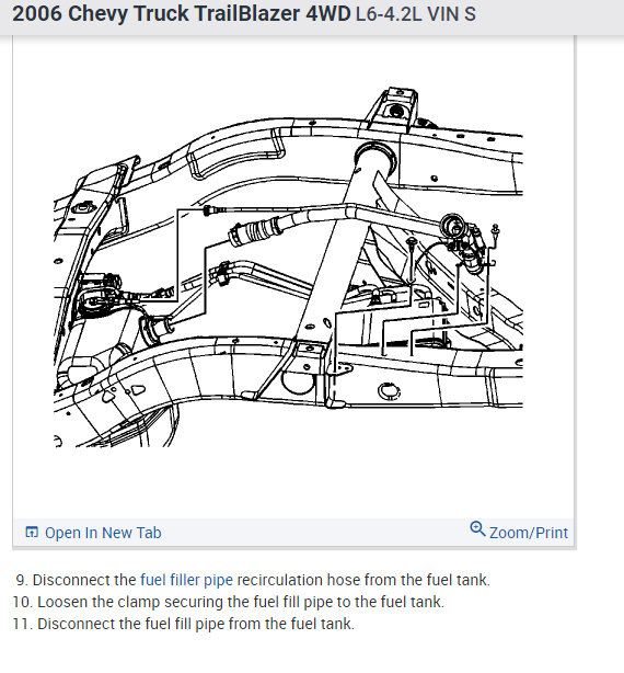

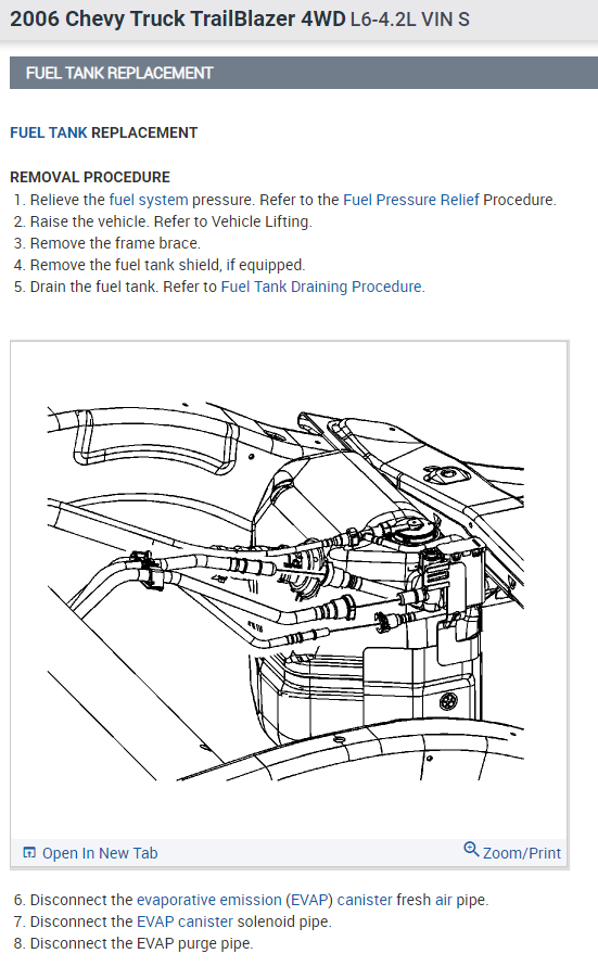

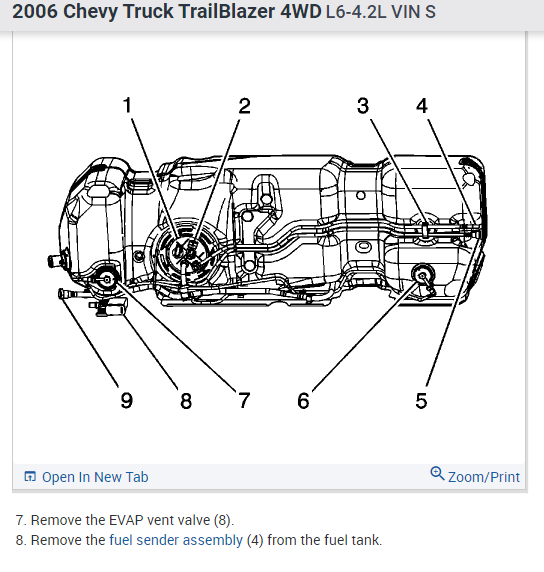

The fuel tank is held in place by two metal straps that attached to the frame.
You will have remove those straps along with all the fuel lines in order to remove the tank.
Also it is ideal to get the fuel drained before getting started.
I have included the fuel draining as well as complete replacement procedure for your reference (Look below).
https://www.youtube.com/c/2carpros/featured
