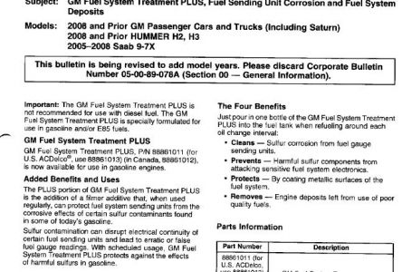

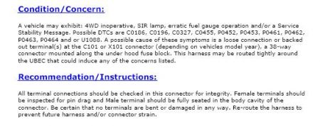

2006 Chevy Trailblazer 6 cyl Four Wheel Drive Automatic
my gas gage is reading below e and it is filled with gas, some times it is hard to start.

I found the above bulletins for the fuel gage. Also, 40 ohms resistance, the gage should show full. 250 ohms resistance, the gage should show empty. If you use resistor on the proper terminals at the fuel pump connector, the gage should react accordingly, if it does, the problem is the tank sending unit.
