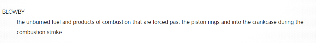

What is the best way to stop oil blow by on a 5.7 1989 Corvette motor?
May 9, 2019 at 3:49 AM
SCGRANTURISMO
  • 4,897 POSTS
The best way to stop oil blow by is to install new piston rings in the engine. This is where oil blow by comes from. I have included a factory description of blowby for you in the diagrams down below.
