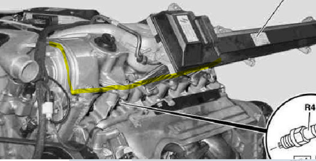

oil around spark plugs, only around the plugs not on the tips?
100,000 MILES • V12 • TURBO • 2WD • AUTOMATIC
BHAMDOC1973
  • 2,007 POSTS
I see the valve cover on top, but the plugs do not sit into the cover, they sit on the side. so how can the wells have oil in them?
Jul 14, 2022 at 5:56 AM
  • 110,248 POSTS
If you are getting oil around the spark plugs, chances are the oil is leaking from the valve cover/cylinder head cover.
I attached a pic below of your engine. I highlighted where to check for an oil leak. I suspect it is leaking at the gasket, which is right above the spark plugs, and then it runs down to where the spark plugs are located.
Check this and let me know what you find.
joe
See pic below.
