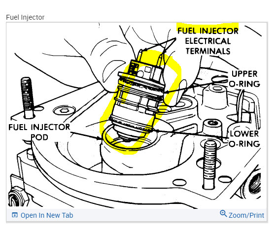

Engine has a rough idle for a minute after starting and the oil smells like gas. I’ve changed the spark plugs and wires and am wondering. what else could be causing this?

If you are getting fuel into the oil, it could be a couple of things. First, if the fuel pressure regulator is failing, the pressure can get too high and leak from the injector when you shut the engine.
Also, a stuck or weak fuel injector can also cause this to happen. When an injector solenoid is energized, the plunger is retracted, lifting the needle valve off the seat. This allows the pressurized fuel to spray into the intake manifold. When the solenoid is de-energized, spring pressure closes the valve. Because of the year and mileage, I have a feeling the spring is too weak to close the valve and fuel pressure drains off when the engine is off.
I have a question. When you start the engine cold, do you ever see any dark smoke from the exhaust or an odor that indicates a rich fuel mixture? If my theory is correct, the engine is slightly flooded when this happens causing the rough idle.
Remove the air filter assembly and have a helper start the engine and then turn it off while you watch for a spray from the injector. See if it leaks off when the key is first turned on (engine off) and if it leaks when the key is turned off.
Note: If you have a lot of fuel in the oil, change the oil and filter to prevent bearing damage.
See pic below.

No, it has occasionally had white smoke after starting before though. It also sometimes will rev up after letting of the gas.

Based on outside temperatures, white smoke could be normal, or it could indicate coolant getting into the combustion chamber.
Have you checked the fuel pressure and are you certain there is nothing leaking from the injector? That is where the fuel would come from unless you have a misfire, and the fuel is not being burned.
