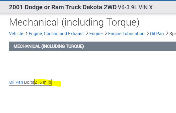

I did that test where you pull the hose to PCV and taped it up. then pull hose on other crankcase to breather. As running ..0 suction. Then i looked into the throttle at belly pan and saw what looked like little droplets of oil. I also put a magnet in there to bottom and it was magnetic to the bottom so maybe it's not aluminum...dye is still in it but no big noticeable area.
Also, under it at the flywheel bell housing another little drip but couldn't trace it...I saw a tad on drain plug also. And retightened. I'm going to retighten the pan bolts. what's the ft lbs? .

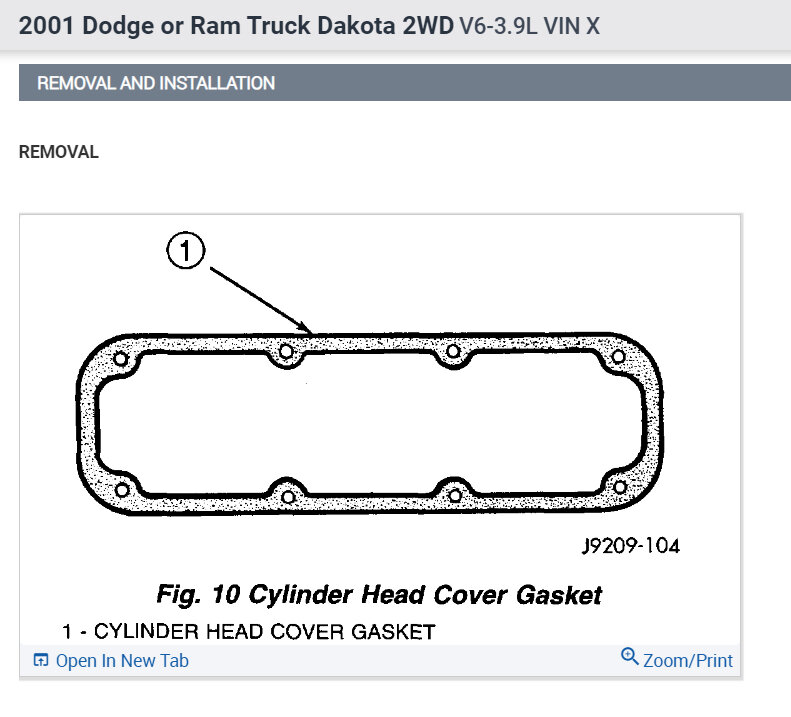

I suspect you are referring to the engine oil pan. I attached the directions below. Note that they are in inch-pounds and not foot-pounds. It shows 215-inch pounds. That works out to right around 18 foot-pounds, so be careful not to overtighten it.
See pic below.

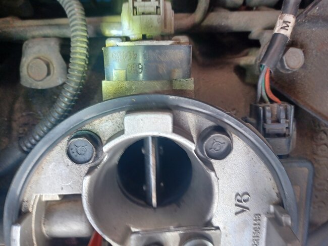

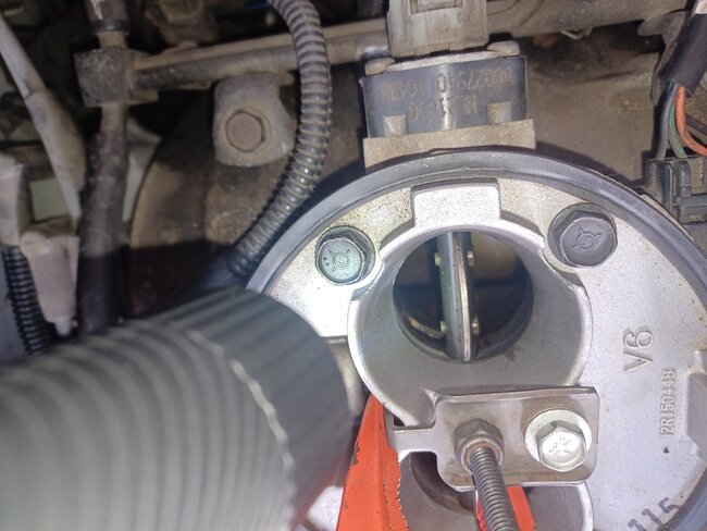

The inside of throttle pic, looking inside the butterfly area and the little dots of oil. I'm not sure what that huge pan gasket is called but it's a common failure in these trucks.
Plenum Gasket?
Oct 24, 2023 at 1:44 PM
  • 55,399 POSTS
You mean inside the intake manifold? There will be a slight amount of residue but if you can see smoke at the top of the hill it is not burning it. You must be leaking while you drive.

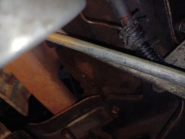

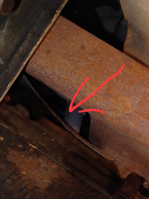

I think i found the problem.
All bolts on pan were torqued okay.

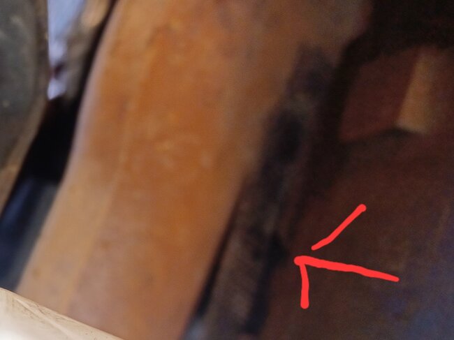

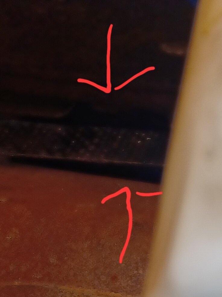

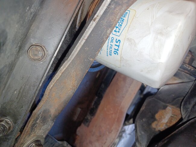

Looks like the exhaust manifold gasket is loose and off. If that's what it looks like in pic. i guess that's why there's a drip at other places on an oil filter bottom?
Does that look like if? Both sides show it loose but more at passenger side.
Oct 25, 2023 at 3:05 AM
  • 55,399 POSTS

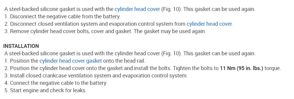

It looks like the valve cover is leaking. Check out the images (below). Please let us know what happens.

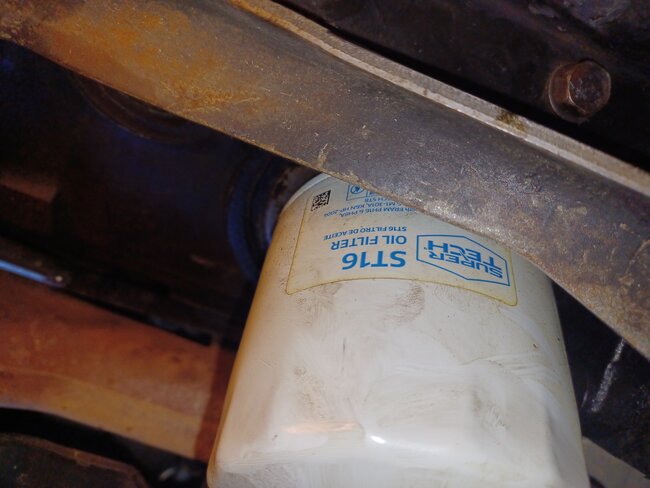

No this is from bottom of truck near oil filter. I changed the top valve covers 2 months ago.
Exhaust area tough to get exact pic but that piece looks like exhaust gasket. does oil ever come from there?
Oct 26, 2023 at 9:41 AM
  • 55,399 POSTS
I can see any oil dripping, can you see where it is coming from?
