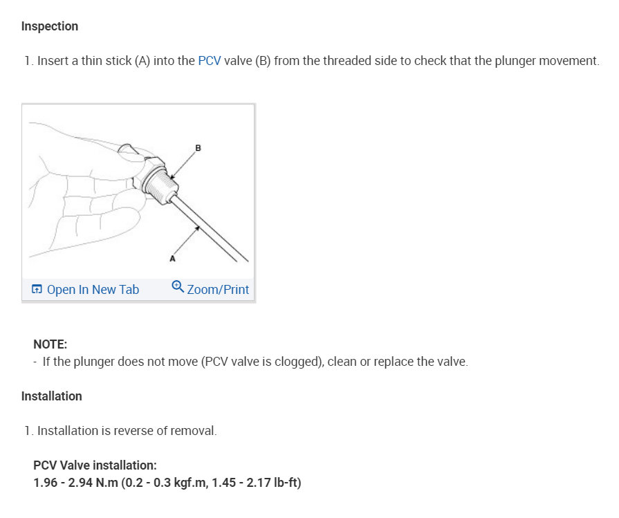

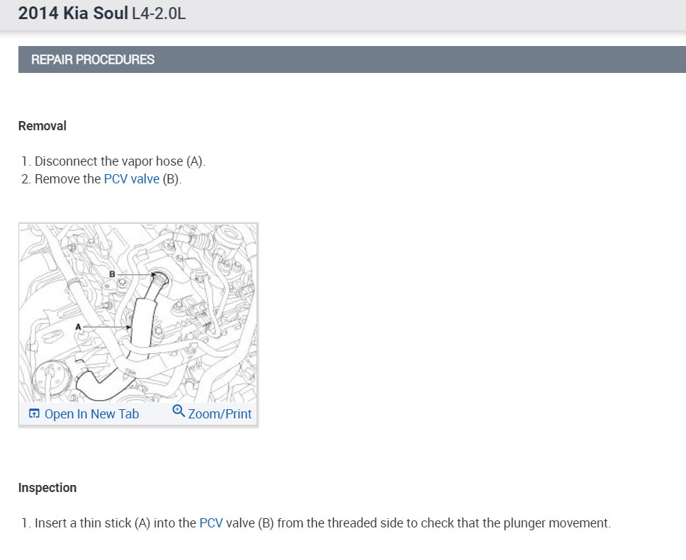

Getting low milage/poor excel) not a problem except, i can't find anywhere how many valves on my engine (exhaust and/or intake?) and where are they located? where do i find screen/filter to check/clean?
help, please and thank you.
Sep 30, 2022 at 2:21 AM
  • 55,748 POSTS
The PCV valve is located in the valve cover of the engine. here is the location of the valve in the images below. Please let us know if you need anything else to get the problem fixed.
