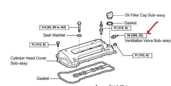

My car burns oil. do you recommend putting thicker oil as for example 5W40 instead of 5W30. thank you

Using a thicker oil in a car that's burning oil is a commonly suggested remedy. Have you changed out the PCV valve because when the valve sticks open it can cause the engine to burn oil, here is the location so you can check it out. Check out the images (below). Please let us know what happens.

yes. I changed the PCV valve from the dealer. no improvement.
