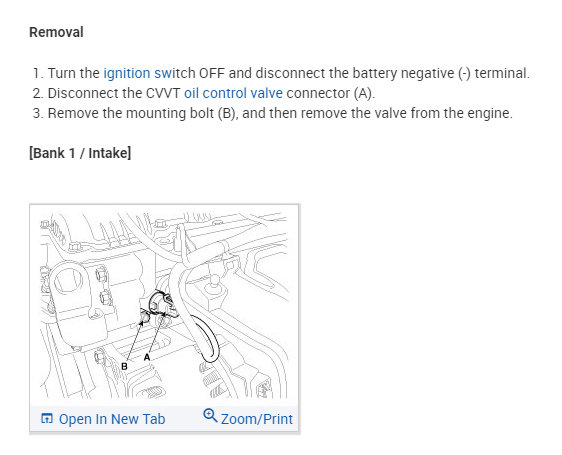

Got a code to replace the OCV (Oil control variable?) valve. ) Getting low milage and poor acceleration).
Seeing that some engines have 1 OCV (intake) and some have 2 OCV (intake and exhaust).
Can't find an answer as to how many my engine has. Where located. Also, where do I find the screen so I can check/clean/replace?
Any help appreciated.
Thank you

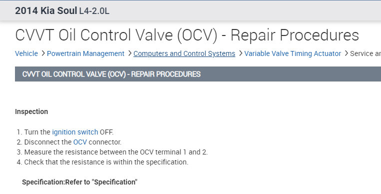

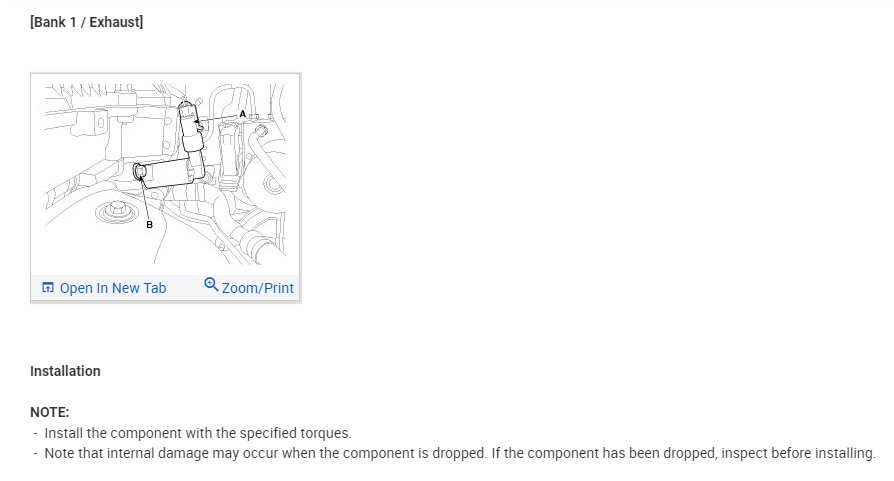

Your vehicle has two, one on the intake and one on the exhaust. If you look at the attachments below, they provide directions for the removal and replacement of them.
By chance, do you still know the code or codes that were retrieved? If you do, let me know what they are so I can narrow things down for you.
