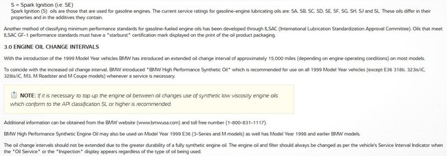

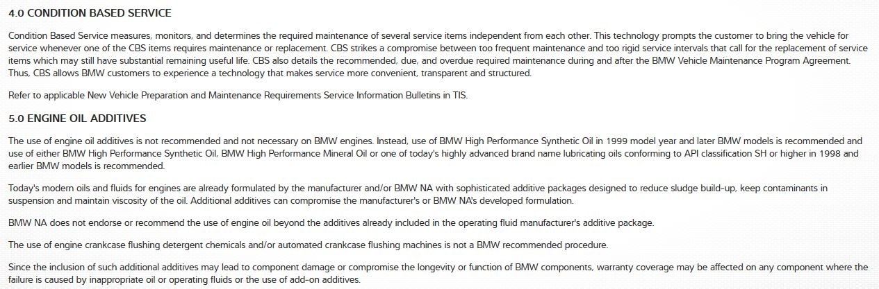

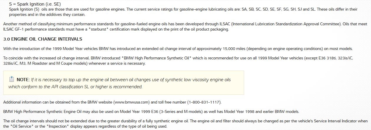

Just wanted to know when to change oil and what kind and weight. How much is the oil and filter if I buy it? Thank you. My first BMW. Thank you

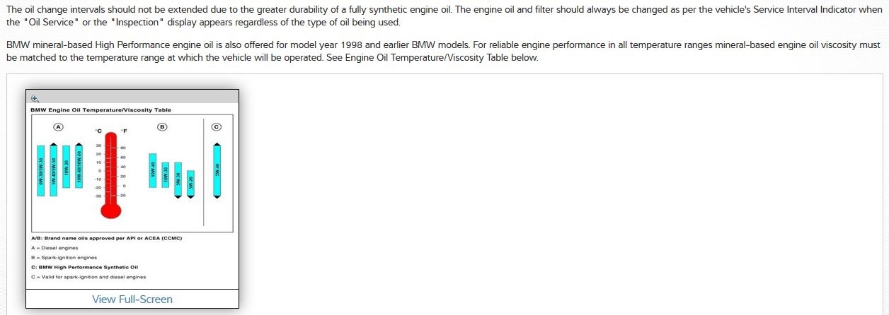

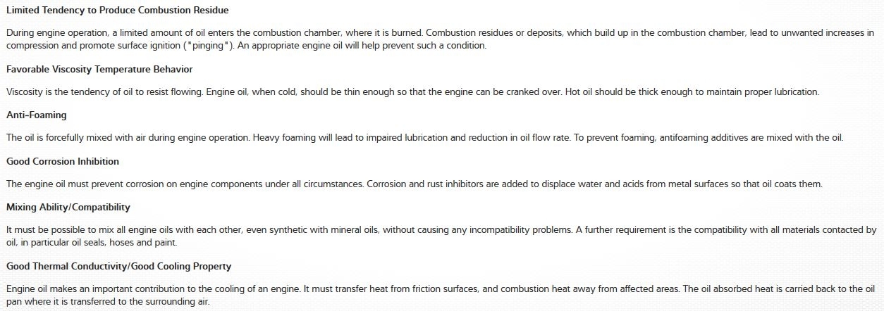

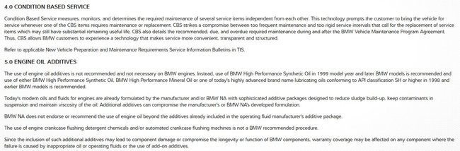

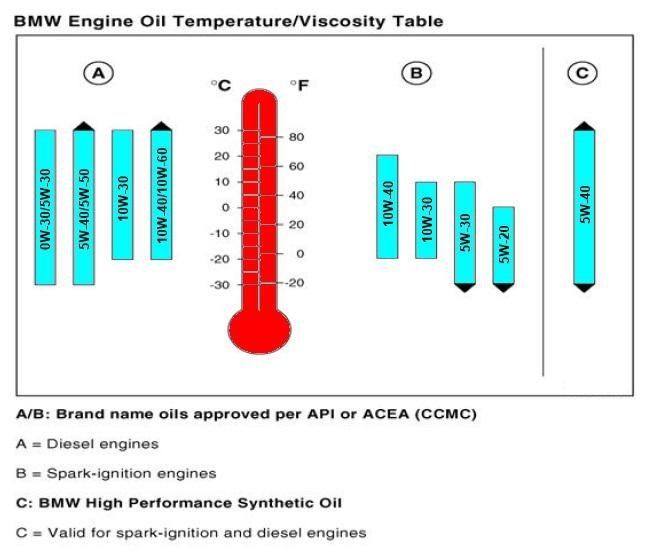

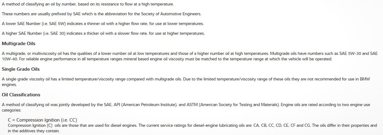

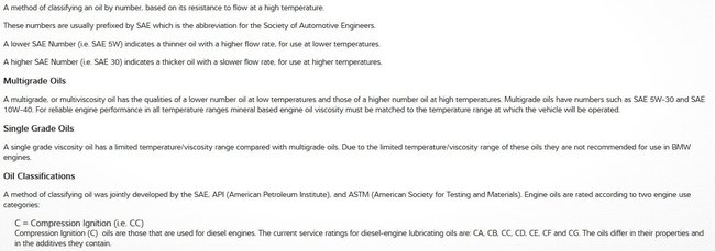

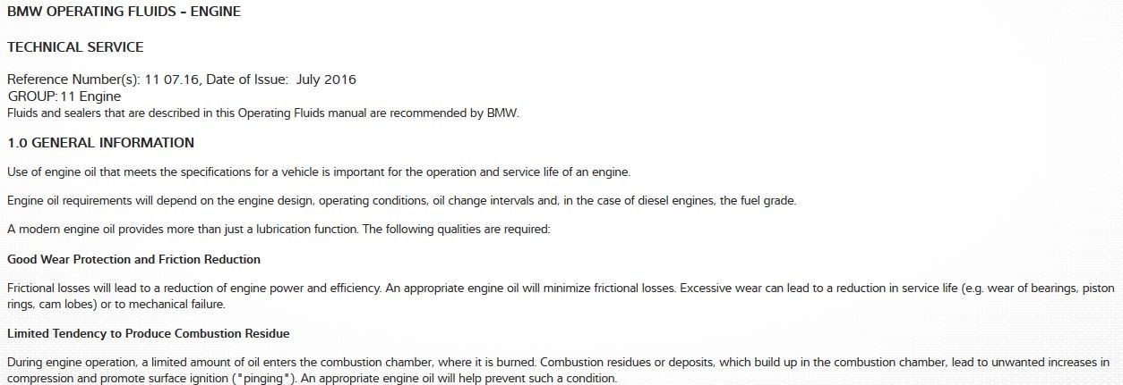

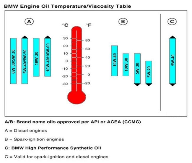

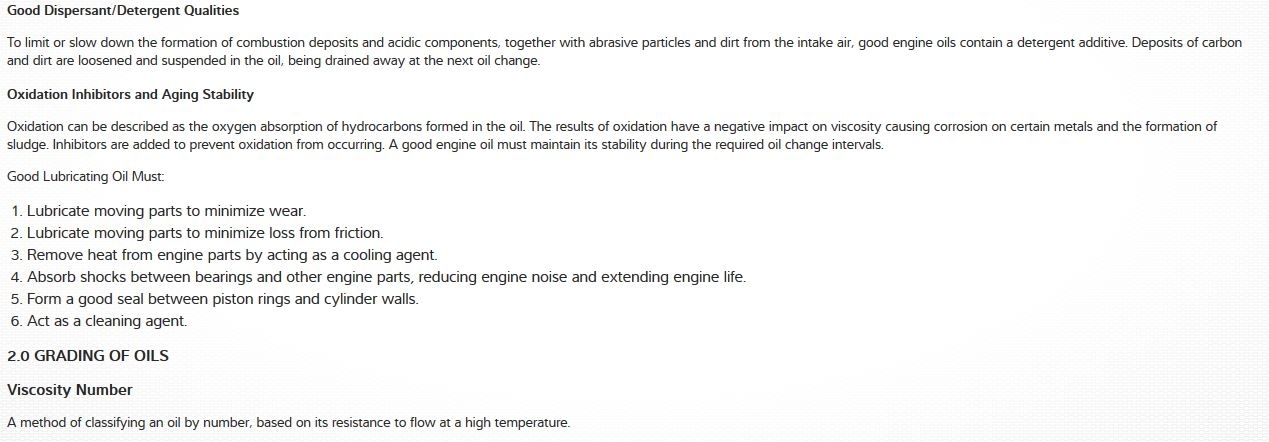

As for what oil to use, there is actually quite a bit of literature put out by BMW. Basically, it depends on the weather where you are. Synthetic 5W-40 should fit the bill. I am including all of the pertinent literature in the images below.
They have not said much about the filter though. An Amazon search turns up some results: https://www.amazon.com/s/ref=sx_as?keywords=oil+filter&rh=k%3Aoil+filter%2Cn%3A15684181&qid=1544098444&vehicle=2008-31-189-------------1 - Be sure to click "Filter Results" near the top of the page.
Hope this information helps.
