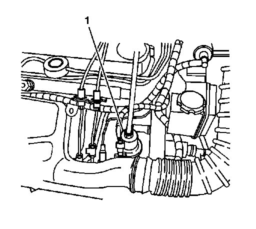

What size socket do I need for the oil filter cap and the drain line?
May 16, 2018 at 11:52 AM
  • 110,194 POSTS

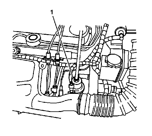

Hi and thanks for using 2CarPros.com. If you have the Ecotech engine, it requires a 32mm socket. Here are specific directions on replacing it along with pictures to help. Note: Do not use an open wrench to remove the cap. Chances are it will break it.
Do not use an open end wrench on the hex on top of the oil filter cap.
Use a 32 mm (1 1/4 in) socket (1) on the hex on the top of the oil filter cap, or an oil filter wrench on the outside diameter of the oil filter cap.
Remove the oil filter cap with filter.
Remove the filter from the cap.
Installation procedure:
Install the filter to the cap.
Install the oil filter cap with filter.
Notice: Over torquing the oil filter cap may cause damage to the oil filter cap resulting in an oil leak. Refer to Fastener Notice in Service Precautions.
Tighten the oil filter cap until fully seated, do not exceed 25 Nm (18 ft. lbs.) .
I hope this helps.
