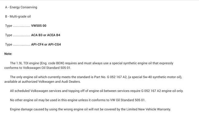

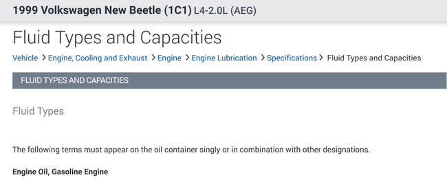

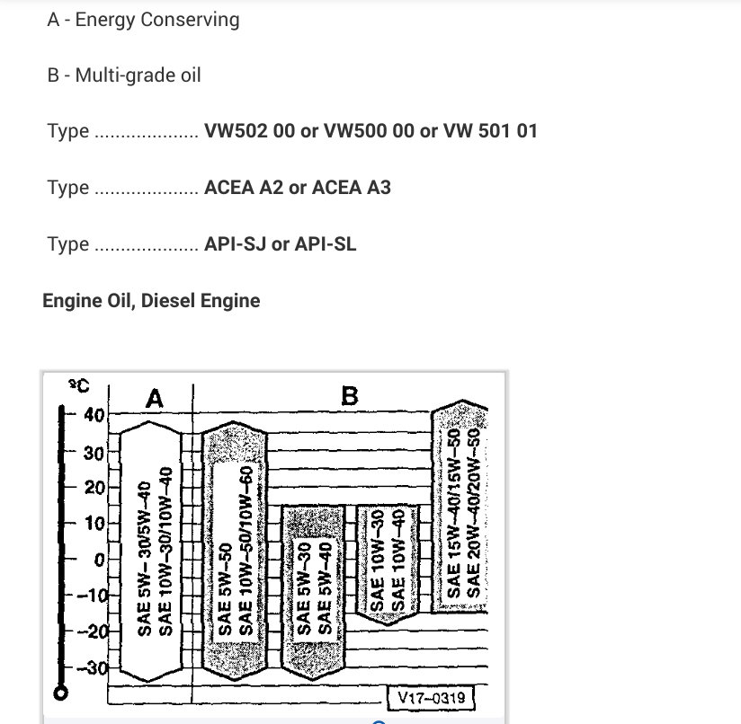

What weight oil am I supposed to use?

I have included the information that you requested in the diagrams down below. Please go through the diagrams and get back to us with how everything turns out. I hope that this helps out.
Thanks,
Alex
