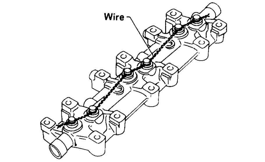

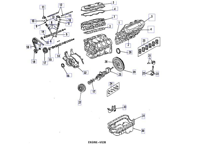

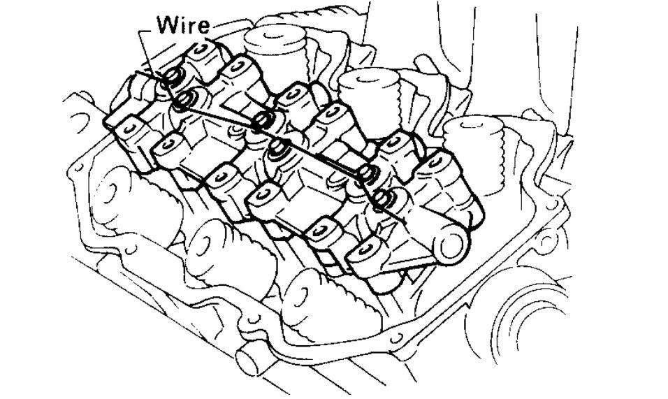

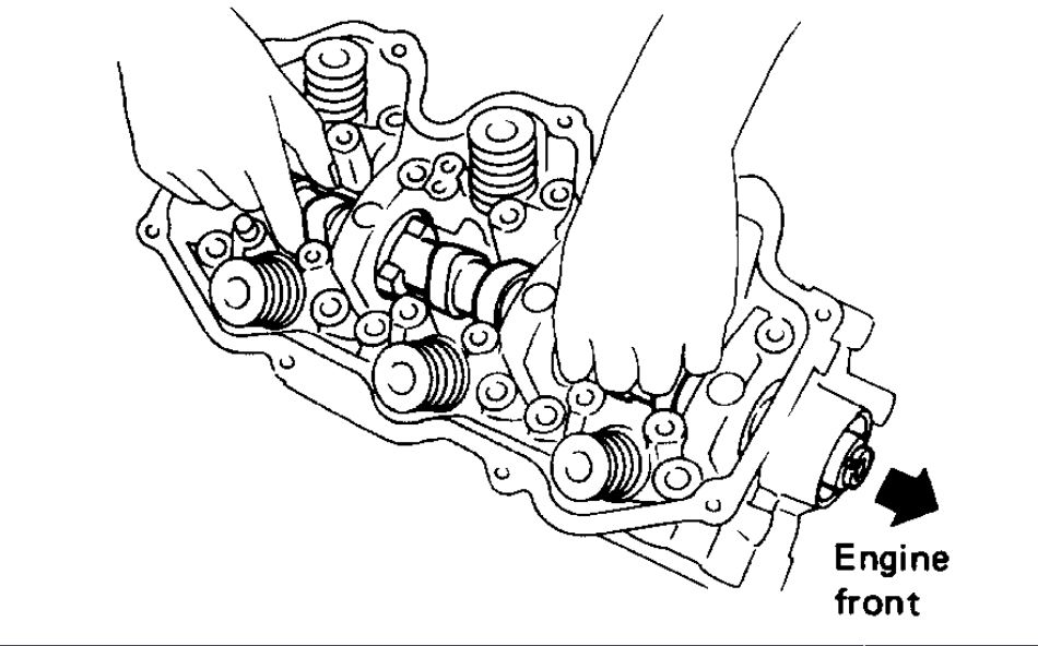

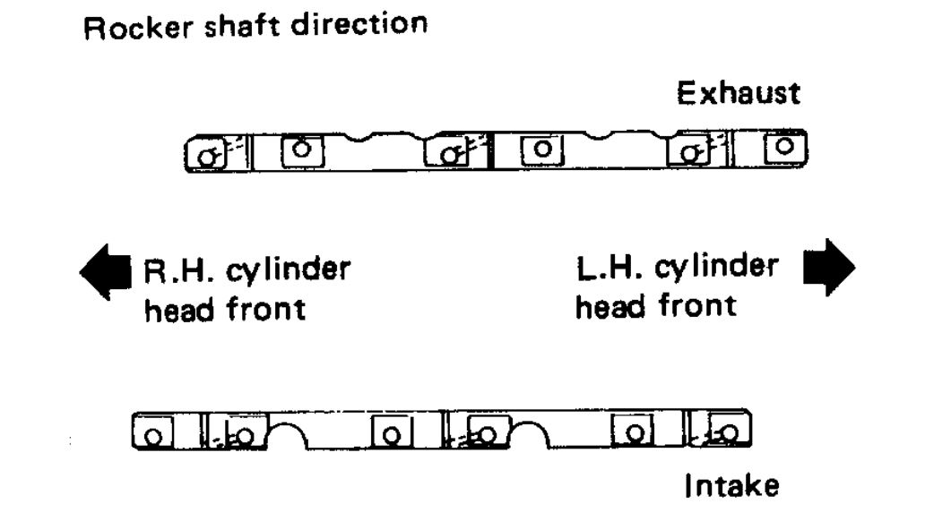

I am not sure how the oh valve system works. Are there four valves per cylinder operated by two separate cam shafts? Have suspected bent valves do to bad timing belt. Please answer.

can you sent me a diagram of the valve system on a 3.0 1993 pathfinder

I attached some pictures for you.
