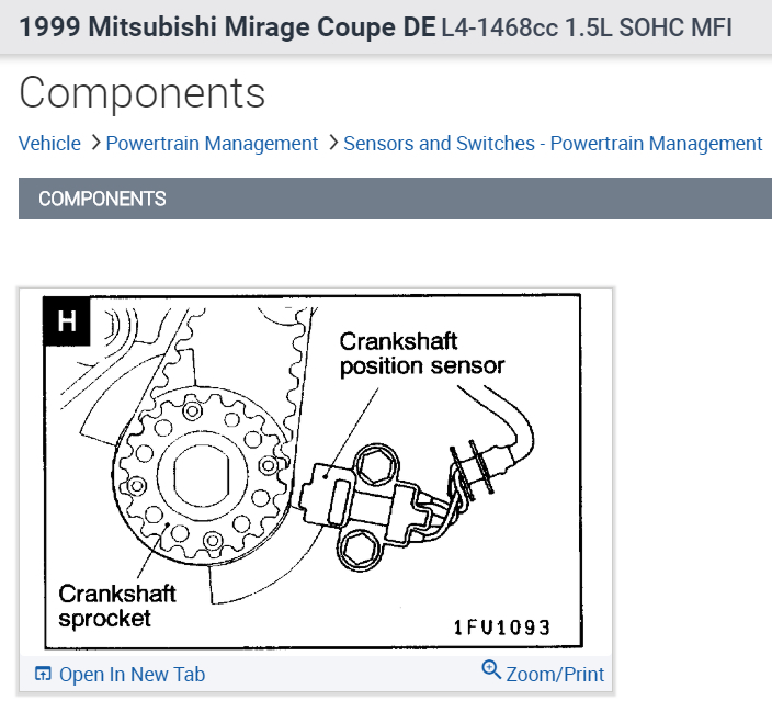

After sometime both on the motion and in traffic it shuts off and then starts again.
Dec 18, 2018 at 4:04 PM
  • 55,402 POSTS
This sounds like a classic crankshaft angle sensor that is failing which will not set a code. Here is a guide that will walk you through the repair with diagrams below to show you how on your car:
This guide can help as well
https://www.2carpros.com/articles/engine-stalls
Check out the diagrams (below). Please let us know what happens. Cheers, Ken
