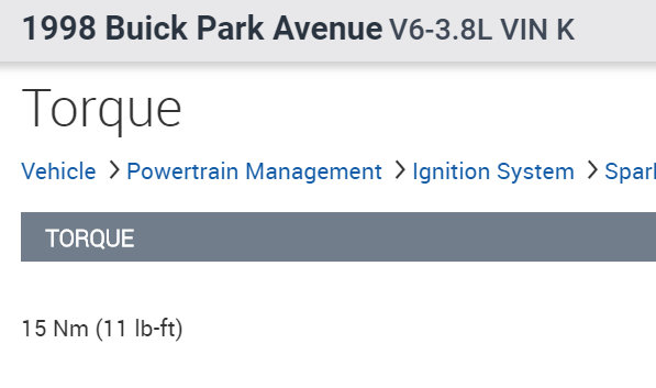

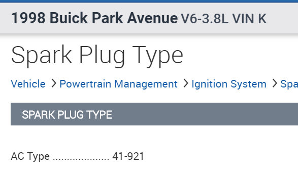

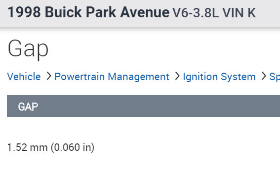

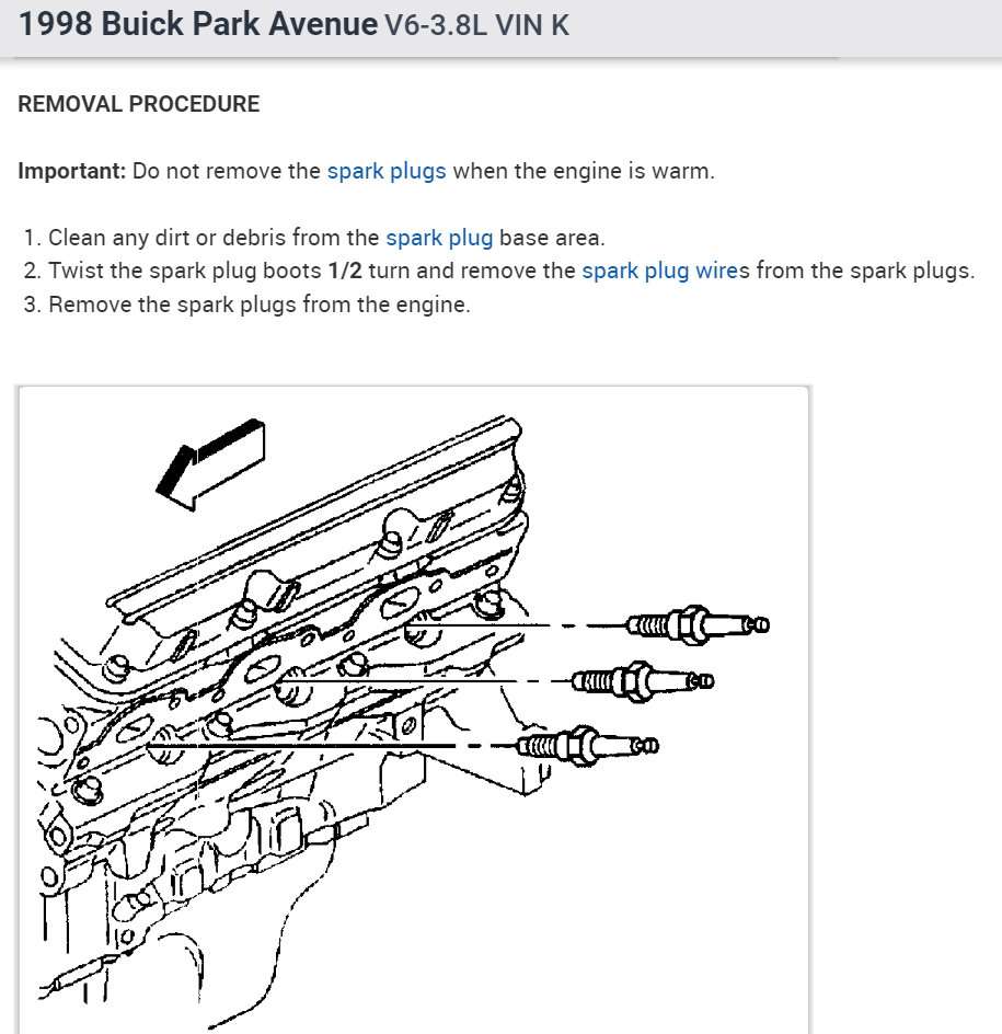

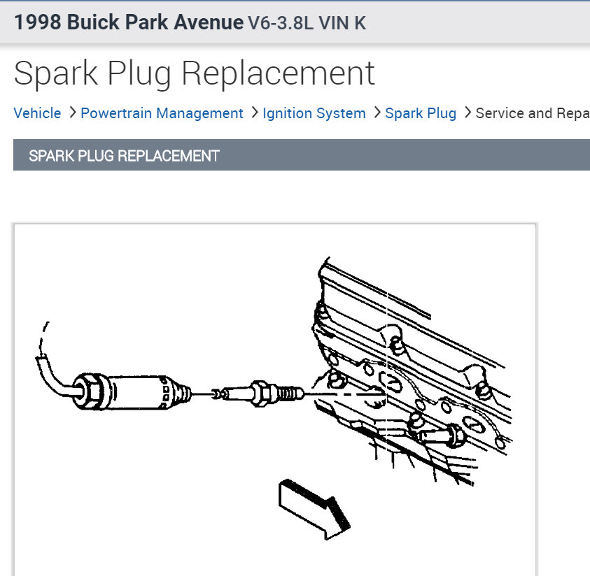

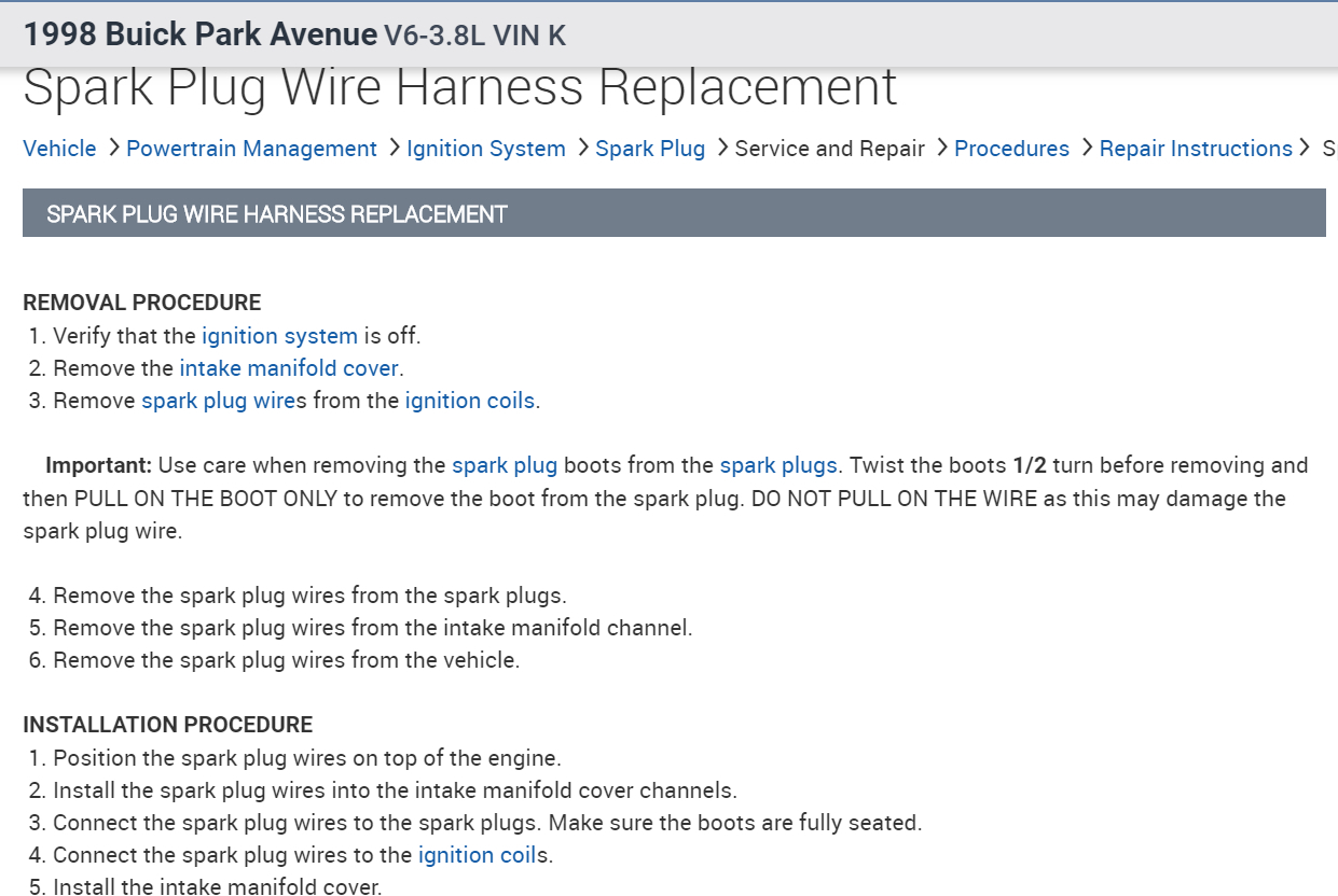

Should I buy conventional OEM ACDelco or a better ACDelco for my car? Copper, platinum or iridium? I can't seem to find the information online.
Friday, February 22nd, 2019 AT 4:04 PM
SCGRANTURISMO
  • 4,897 POSTS

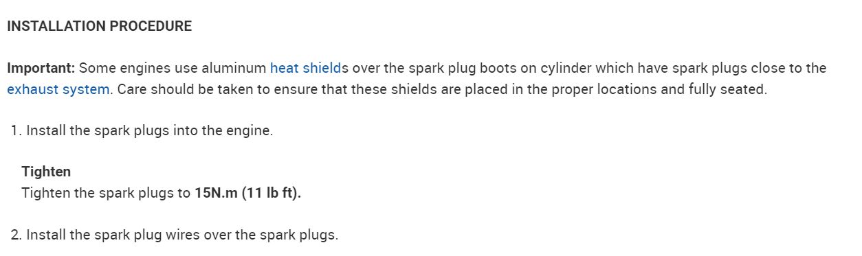

I have included for you in the diagrams below all the information you requested for replacing spark plugs and your spark plug wires. I would recommend using the OEM spark plugs as they were the ones intended for your car. I hope that this helps.
