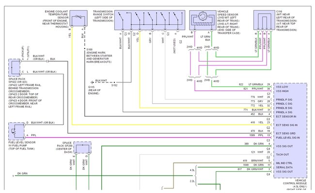

  • 55,423 POSTS
Hey Mike,
It looks like the speedo is monitored by the VCM so if the cluster is okay that is where I would look next.
Here is a diagram to help out.
Please let us know what you find so it will help others.
Best, Ken

MIKE PETERSON2
  • 5 POSTS
I ended up finding a new stepper motor for the cluster and installed it....Fairly easy job, but still nothing:-(

  • 55,423 POSTS
This could mean the VCM is out.
