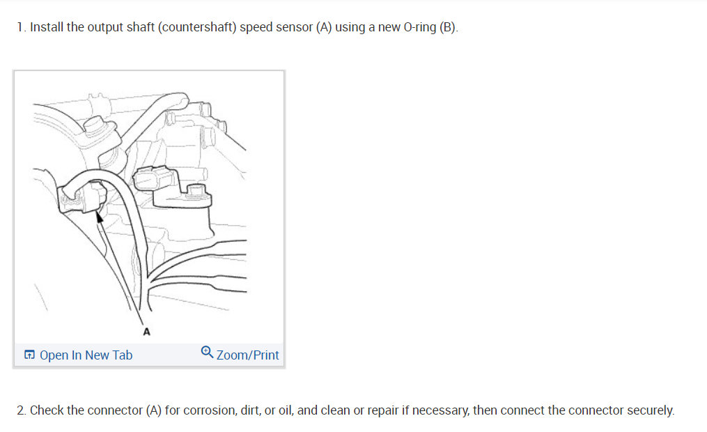

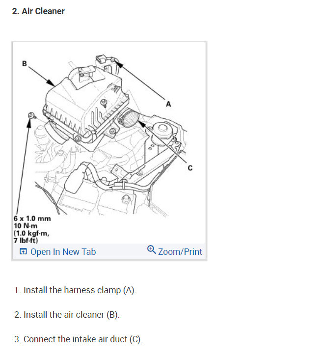

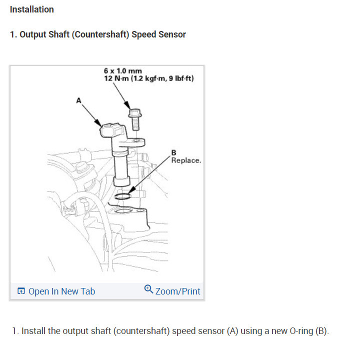

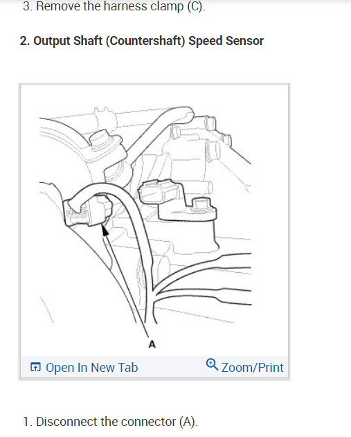

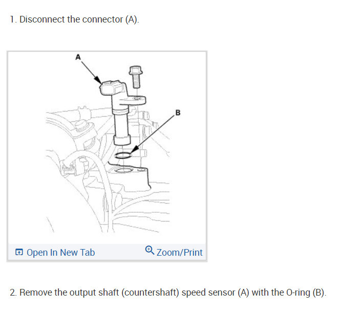

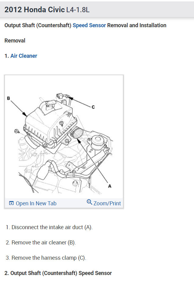

it sounds like the output shaft speed sensor is out here is how you can replace it. Check out the diagrams (Below). Let us know what happens and please upload pictures or videos of the problem.
Nov 14, 2018 at 6:08 PM
PAULAC
Hi Danny, It was the sensor thank you all fixed. The check engine light was on as well but now off
