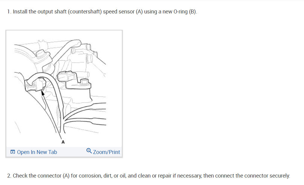

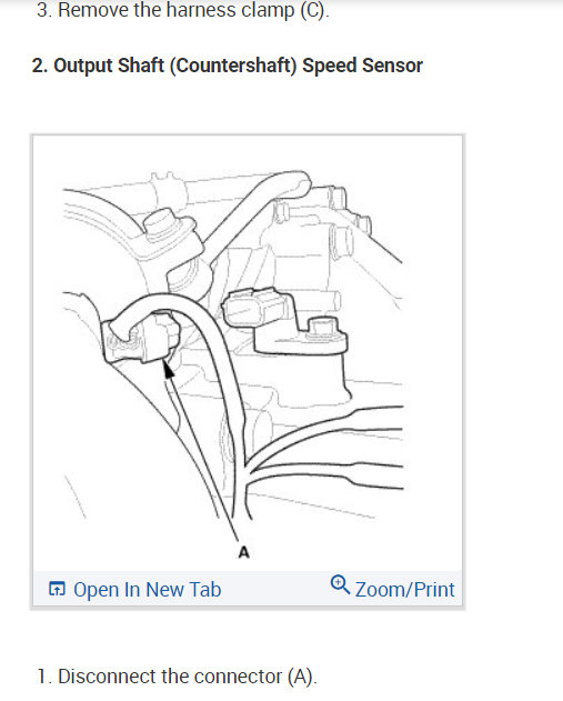

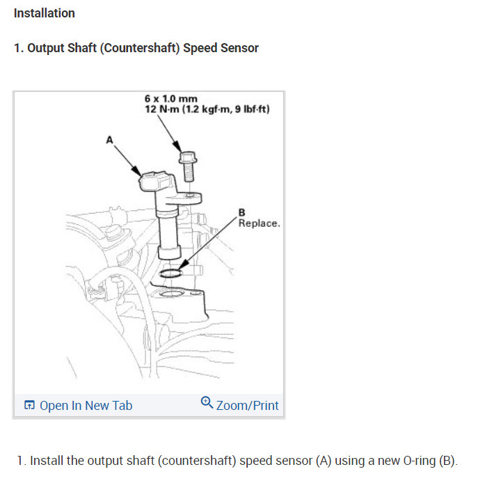

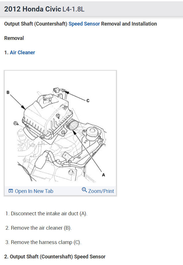

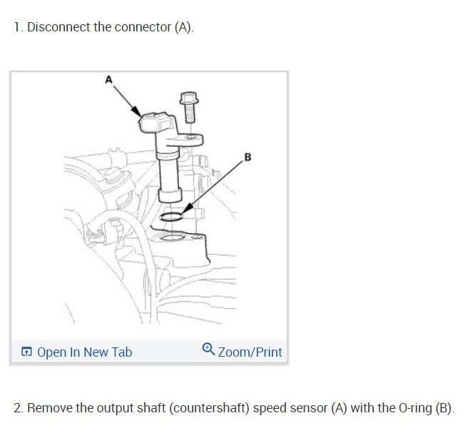

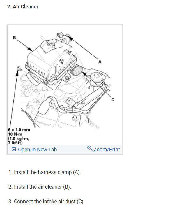

Have had the car for two months and put about 1,300 miles on it since I have had it. Today on my way to work I noticed the speedometer was not working? Have you ever heard of such a thing and now what do I do?
Nov 14, 2018 at 1:50 PM
DANNY L
  • CAR REPAIR CONTRIBUTOR
  • 5,648 POSTS
Hello, I am Danny.
it sounds like the output shaft speed sensor is out here is how you can replace it. Check out the diagrams (Below). Let us know what happens and please upload pictures or videos of the problem.
Nov 15, 2018 at 2:08 AM
PAULAC
Hi Danny, It was the sensor thank you all fixed. The check engine light was on as well but now off
