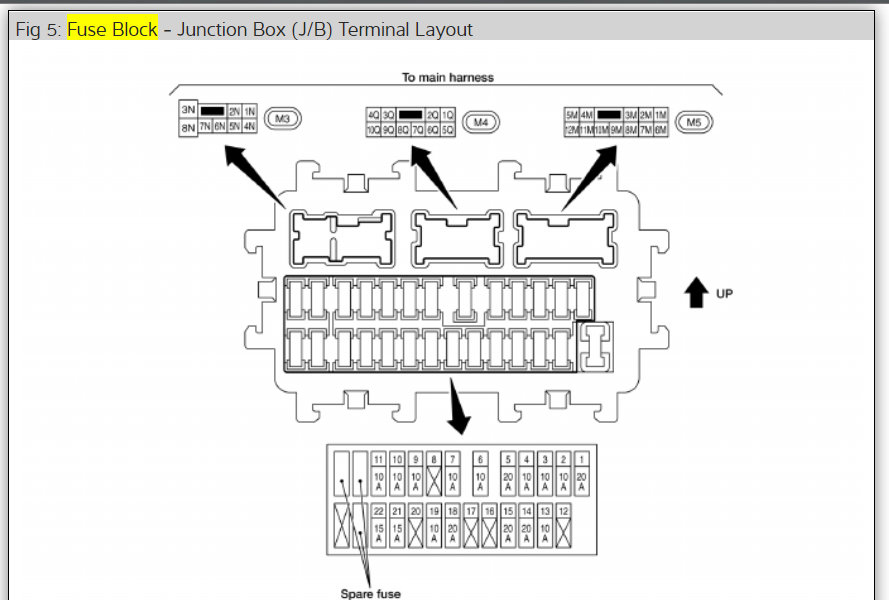

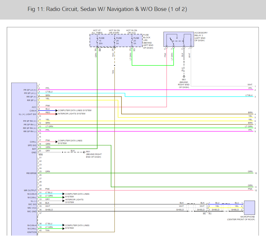

my dashboard light not on, odometer not working, radio light on but not playing.
Dec 18, 2018 at 9:27 AM
  • 55,433 POSTS

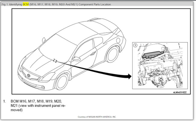

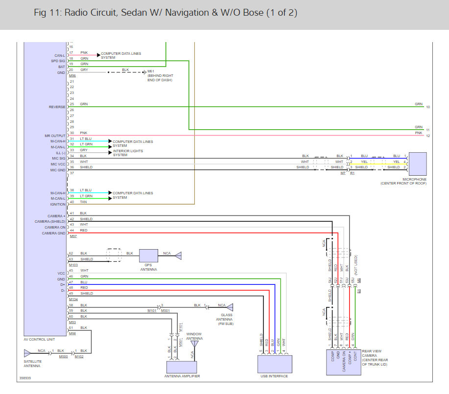

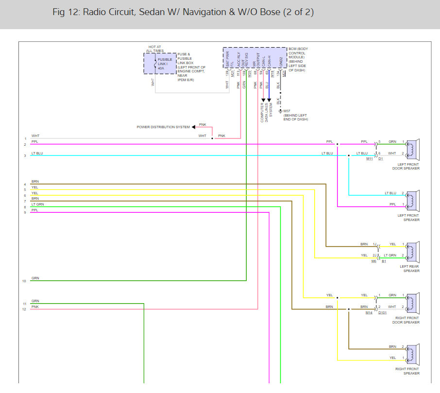

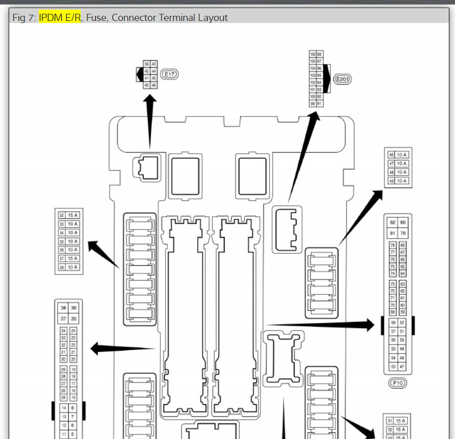

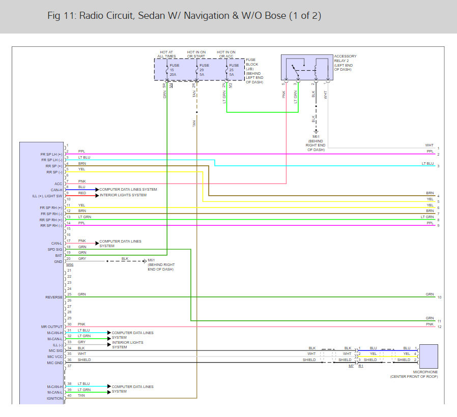

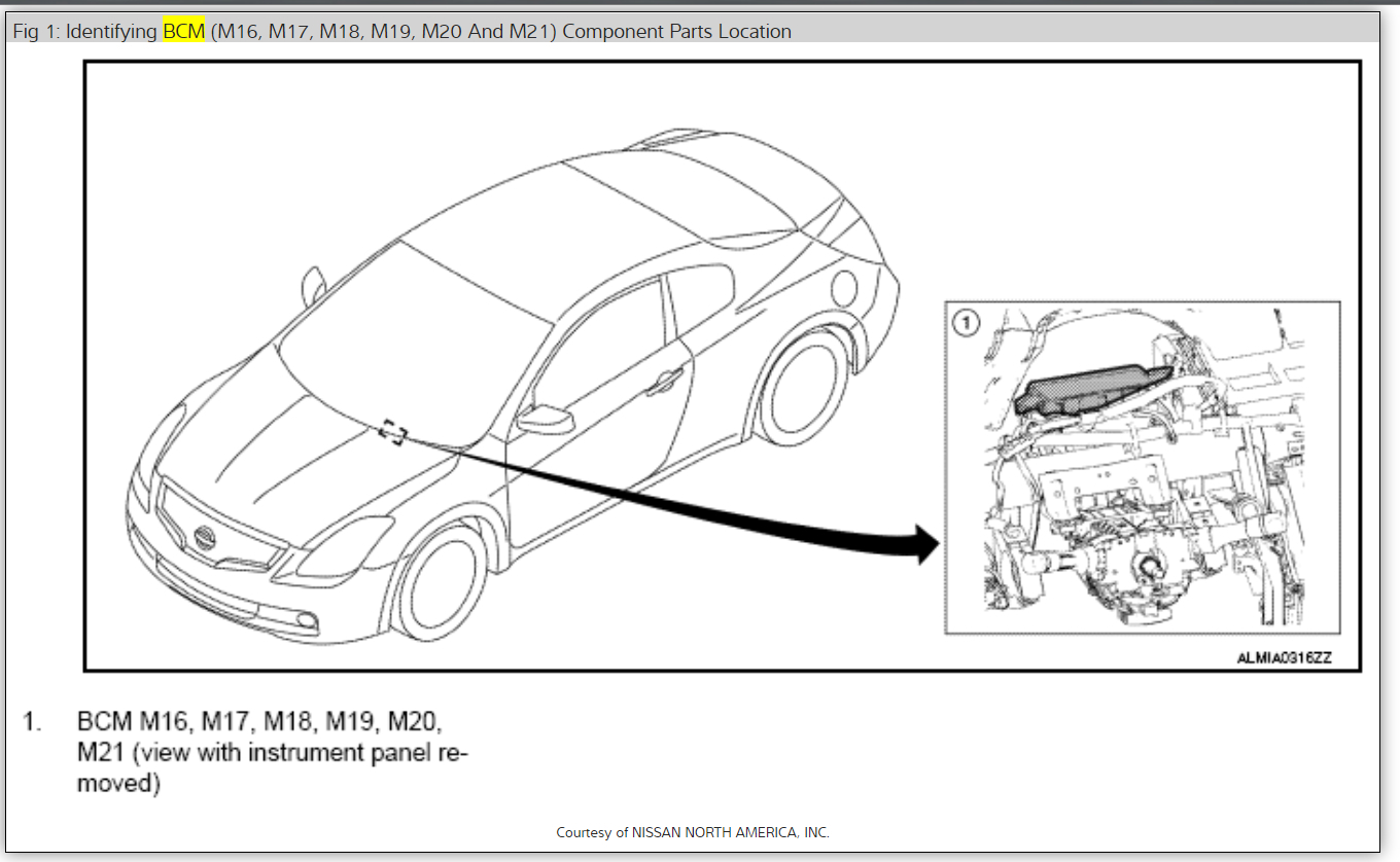

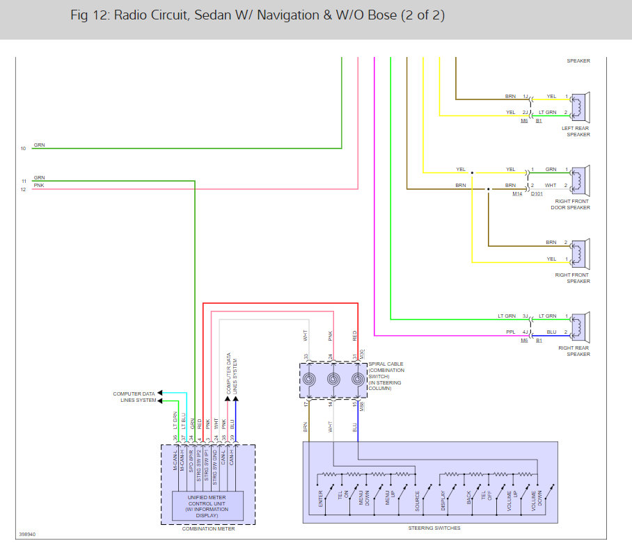

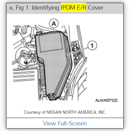

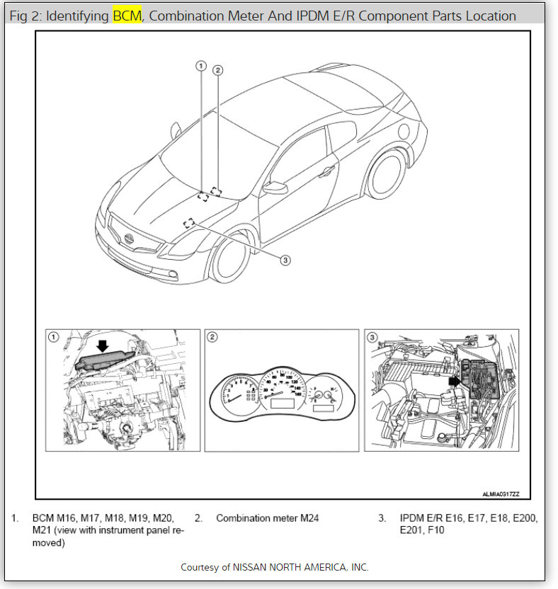

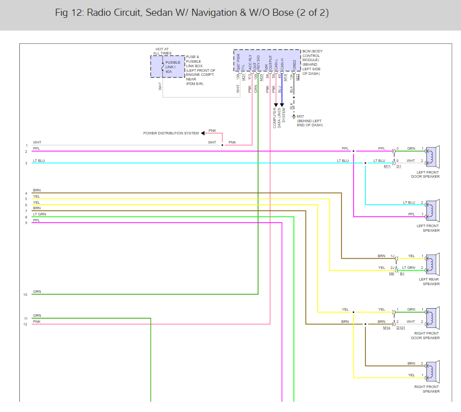

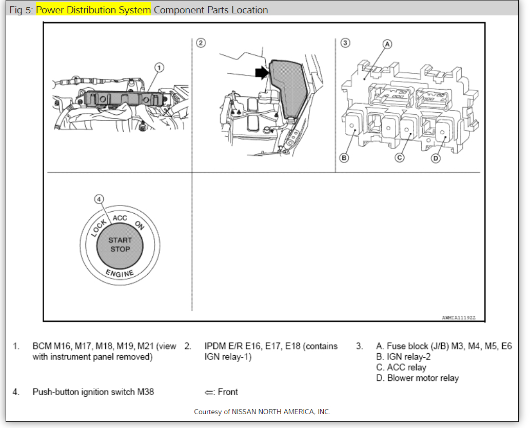

We need to check fuses # 29, 25 and 15. If they are okay we need to check the accessory relay. Here are the radio wiring diagrams so you can see how the system works. Also the fuse location and the relay as well. These guides will help you test the fuses and relay. Both can affect the odometer which is controlled by the BCM.
and
If everything checks out I would think the BCM is out which will need to be programmed for $130.00 at a shop.
Check out the diagrams (below). Please let us know what happens. Cheers, Ken

Thanks for reply. We've checked all fuses are okay.the radio is playing okay. the main issues is odometer not spinning, dashboard light off.
Dec 21, 2018 at 12:09 AM
  • 55,433 POSTS
Okay, that leaves the BCM going out but to be sure we need to scan the CAN. Here is a video to help confirm the issue:
