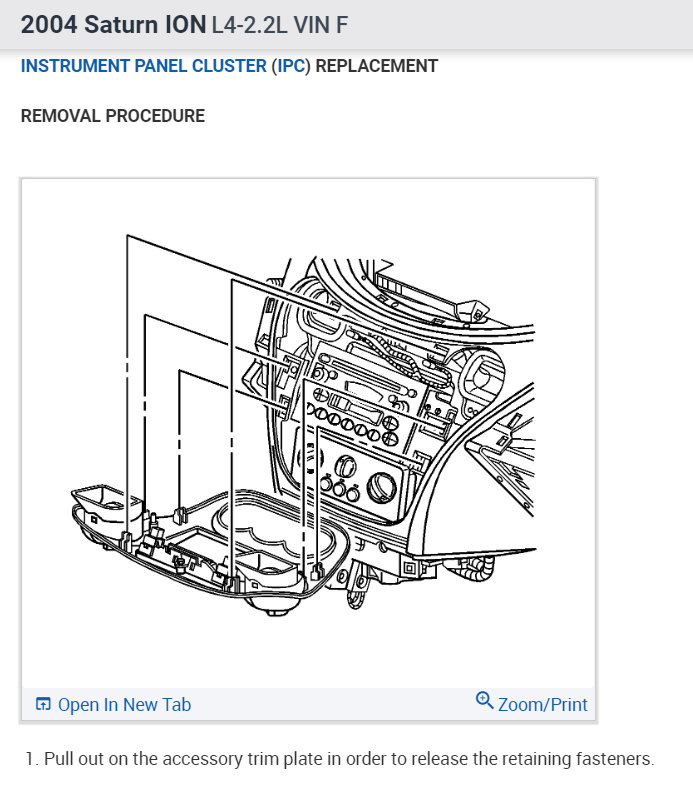

I just recently acquired the car listed above and I hadn’t paid any attention until today that the odometer or the trip odometer doesn’t move at all. there are no codes or service lights showing on the instruments. Could you please help? I’m at a total loss with this one. And thanks in advance.
Jan 22, 2020 at 11:42 AM
  • 55,433 POSTS

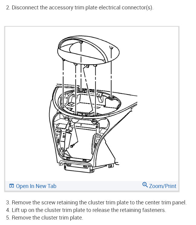

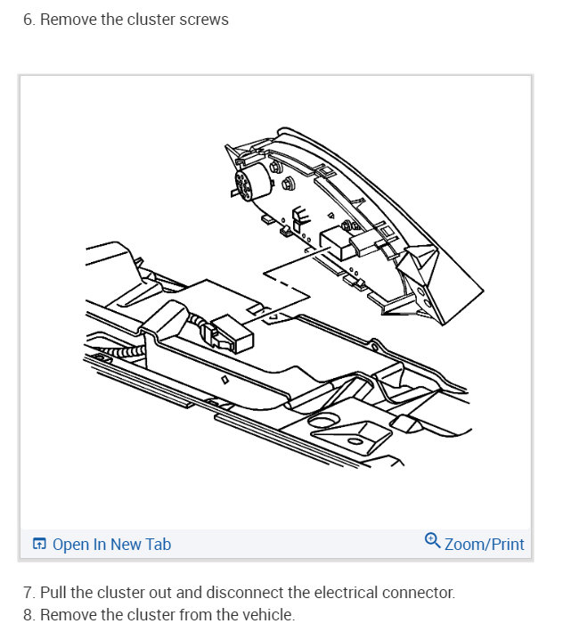

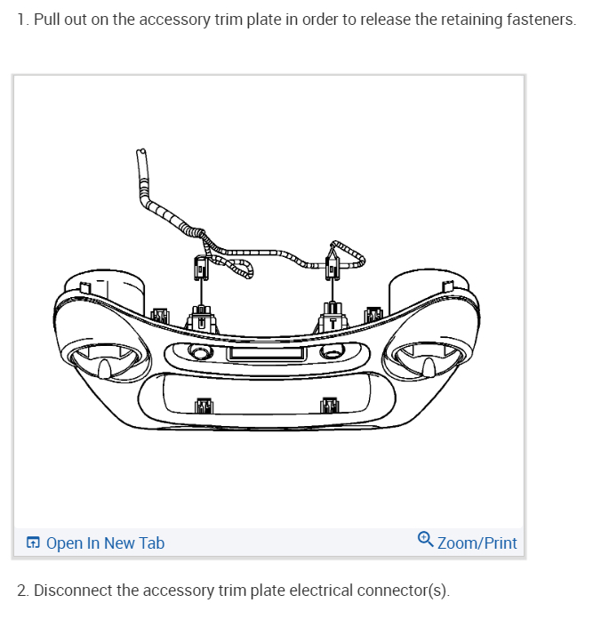

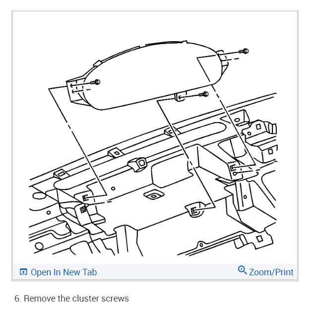

If the speedometer works the cluster has gone bad and needs replacement, be sure to give the mileage to the re-builder. here is a video of the job being done on a similar car with instructions in the diagrams below to help you with you car.
