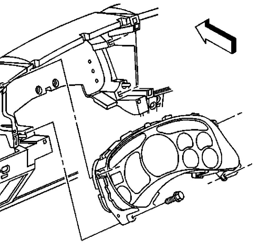

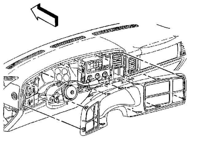

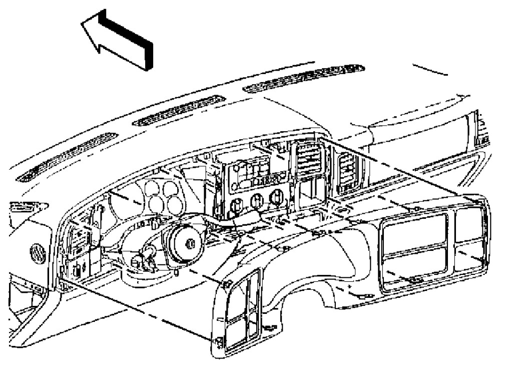

In either case you will need to remove the panel for repair or replacement. The first step is removing the trim panel. To do that you set the parking brake (if you normally use it, if it hasn't been in normal use, block the wheels) then shift the transmission to low, tilt the steering wheel fully down and then pull the panel to release the clips. Try to remove it carefully as the plastic can get brittle with age. Then once the trim panel is off it's a simple matter to just remove the four screws that hold the panel in place and disconnect the electrical connector and remove it. Now if you plan on replacing it you will need to have access to a dealer level scan tool as the replacement dash needs to be programmed to match your vehicle. If you simply repair it that isn't needed.

IK, that would mean it's the voltage feed on the circuit board, likely a bad solder joint. You could get a soldering iron and some 60-40 solder, and reflow the resistors and the power chip like Jeff shows. It's delicate work so practice a lot before you try as it's very easy to damage the board.
