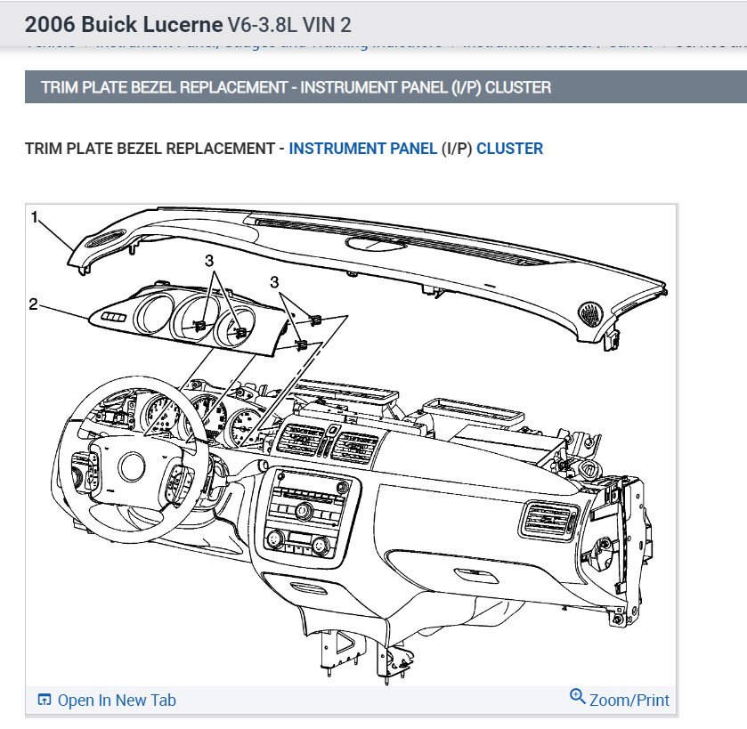

The trip meter is working. Only the odometer is not working. How do I fix this please?
Mar 7, 2023 at 8:08 AM
  • 55,412 POSTS
Yep, this happens when the cluster goes out and needs to be replaced. To be sure we should do a CAN scan which will confirm the issue, you can get a CAN scanner (Controller Area Network) from Amazon.

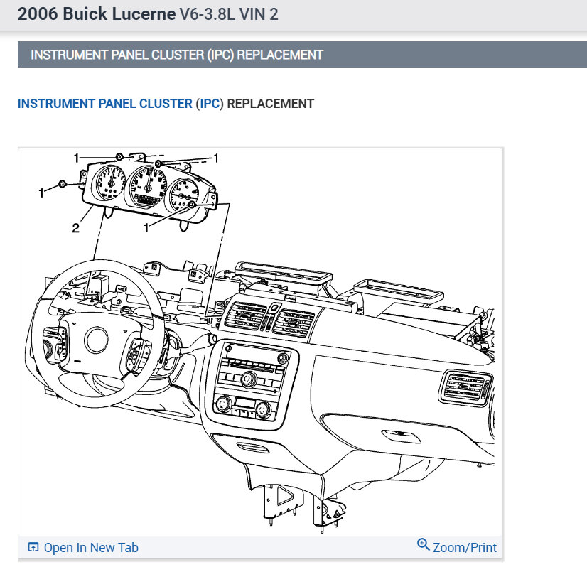

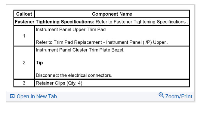

Also here is a video of the job being down on a similar car. The procedures is the same with instructions in the images below for your car.
https://youtu.be/_HEC44xENxw
You can get a rebuilt unit by searching Google or eBay. Check out the images (below). Please let us know what happens.
