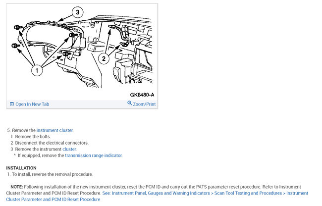

Digital odometer won't come on and sometimes the speedometer does not work and sometimes it does.
Jun 26, 2022 at 7:43 AM
  • 55,732 POSTS

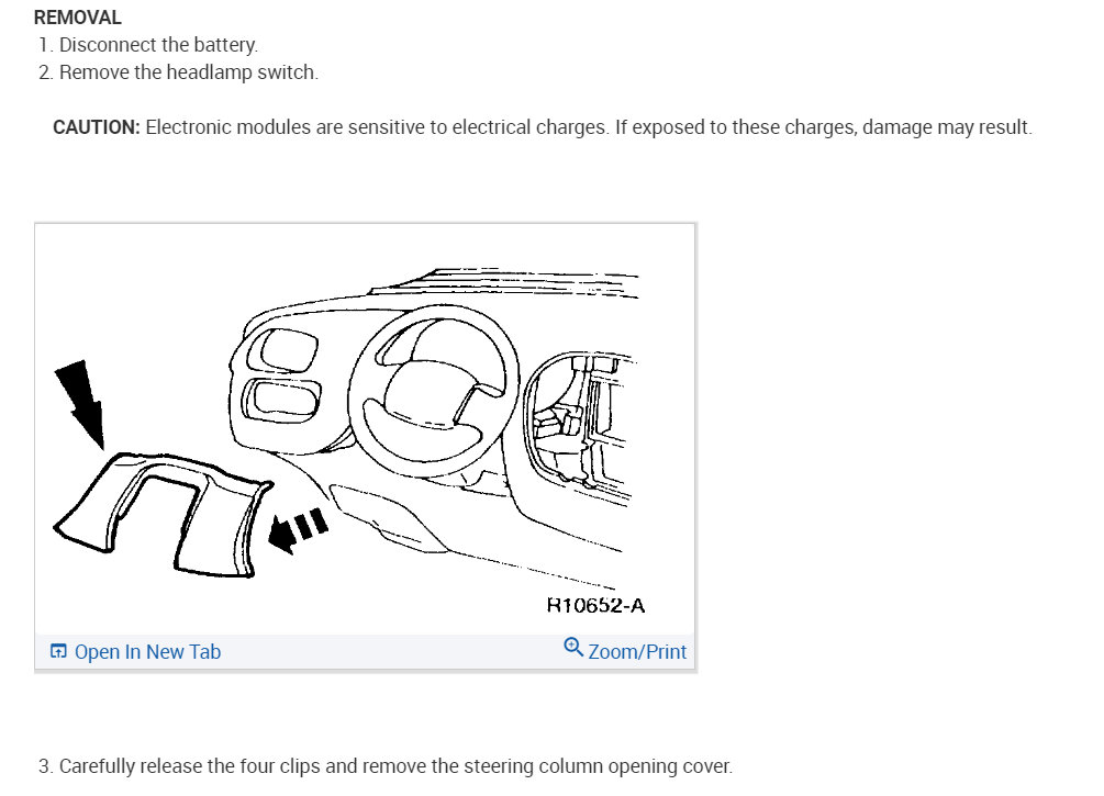

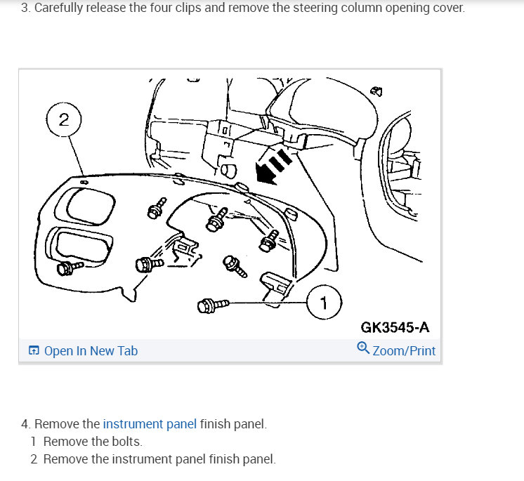

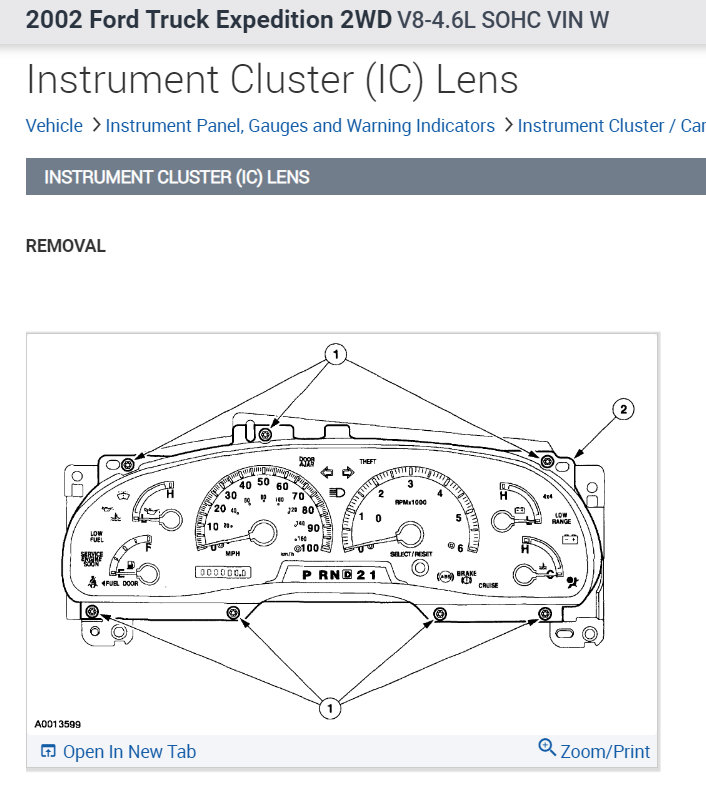

This is common when the instrument cluster goes out. To be sure we can do a CAN scan which will confirm the issue. Here is a guide and video on how to do the scan (easy) scanner are about $40.00 on Amazon:
Here is a video on how to change the cluster out on a similar car and instructions in the diagrams below to show you how to in your car:
