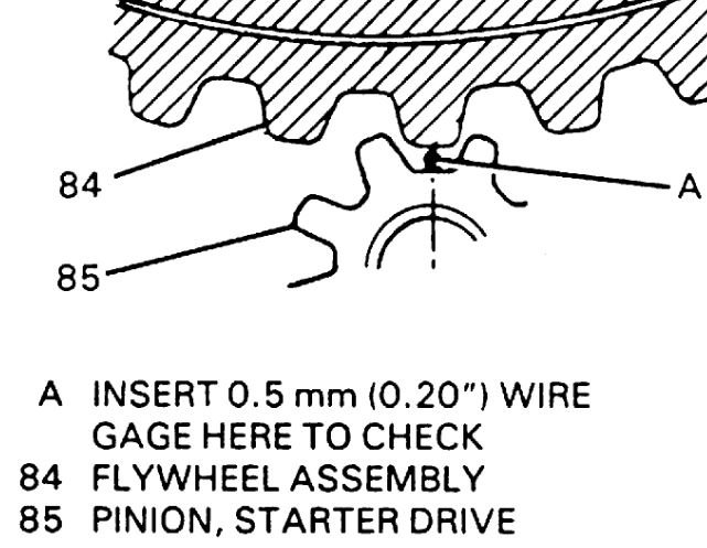

Old starter locked up, replaced it with new one, new starter will sometimes engage and turn engine over, sometimes just makes a hard click and maybe turn engine over a 1/4 turn. Drive gear does not disengage from flywheel from what I can see. battery in car is also brand new video attached. sorry in advance for the language.. any suggestions would be welcomed.

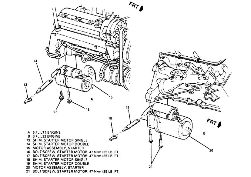

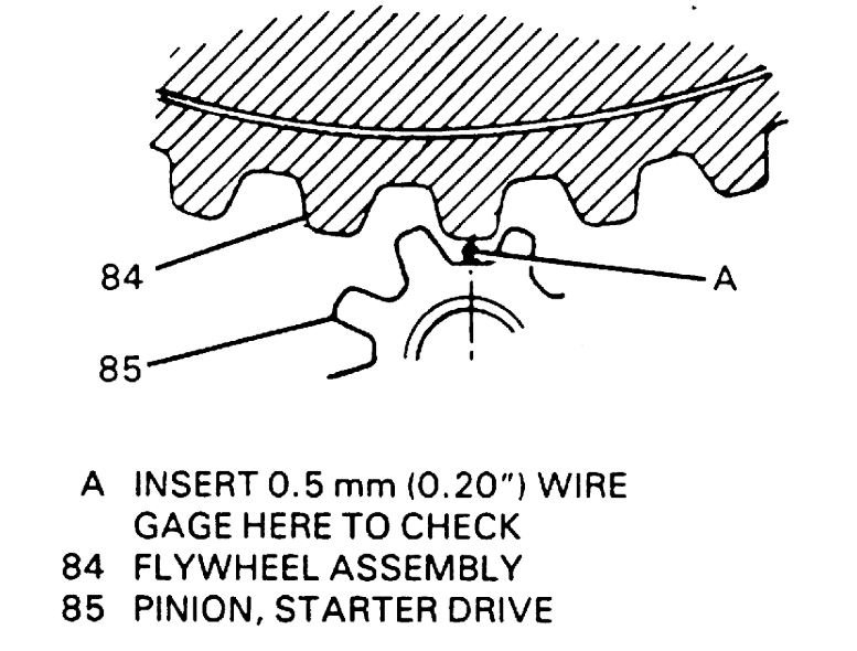

My first thought is shims, on your car the starter (in most cases) require shims to get the proper clearance between the starter drive gear and the flywheel. If this is not performed properly the starter will bind and even if it does work it will fail prematurely. I have attached a diagram of how to check to make sure it is correct. I use a allen key wrench to measure it. I hope this helps you find your problem. Please keep us up to date on your progress and thank you for using 2CarPros!

Did you shim it out correctly?

Starter is from DB Electrical. Looked like it was meshing properly with out shims. Flex plate is in great shape. Will try to see if video attaches this time.

The Bendix is stuck against the flywheel because it does not have the correct clearance.
I would put a thin shim on the starter between the starter and the block and see if it releases.

Shimmed it up, but no go. all it does is click now, think the solenoid is shot. :/
May 26, 2020 at 1:30 AM
I agree. I would replace the starter motor.
