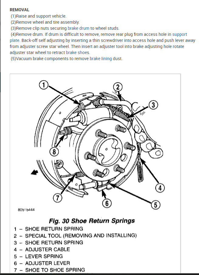

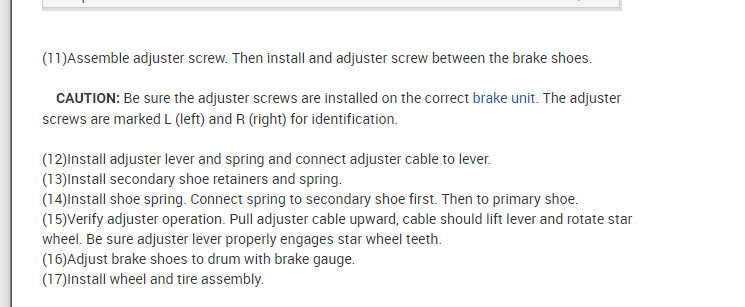

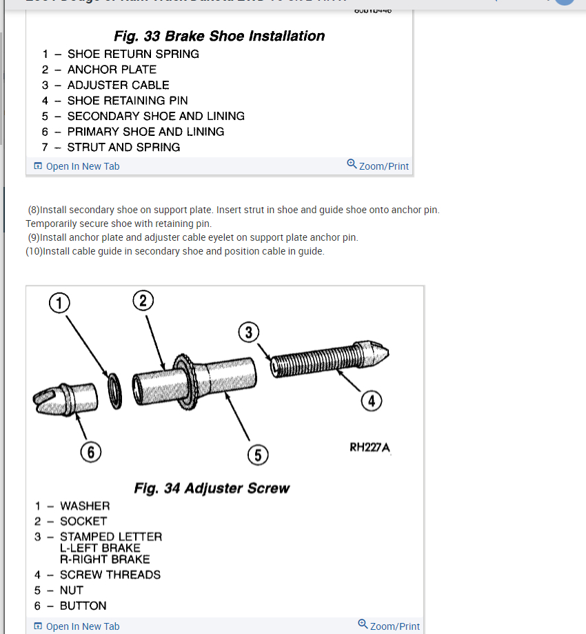

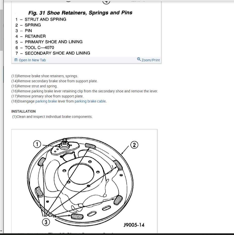

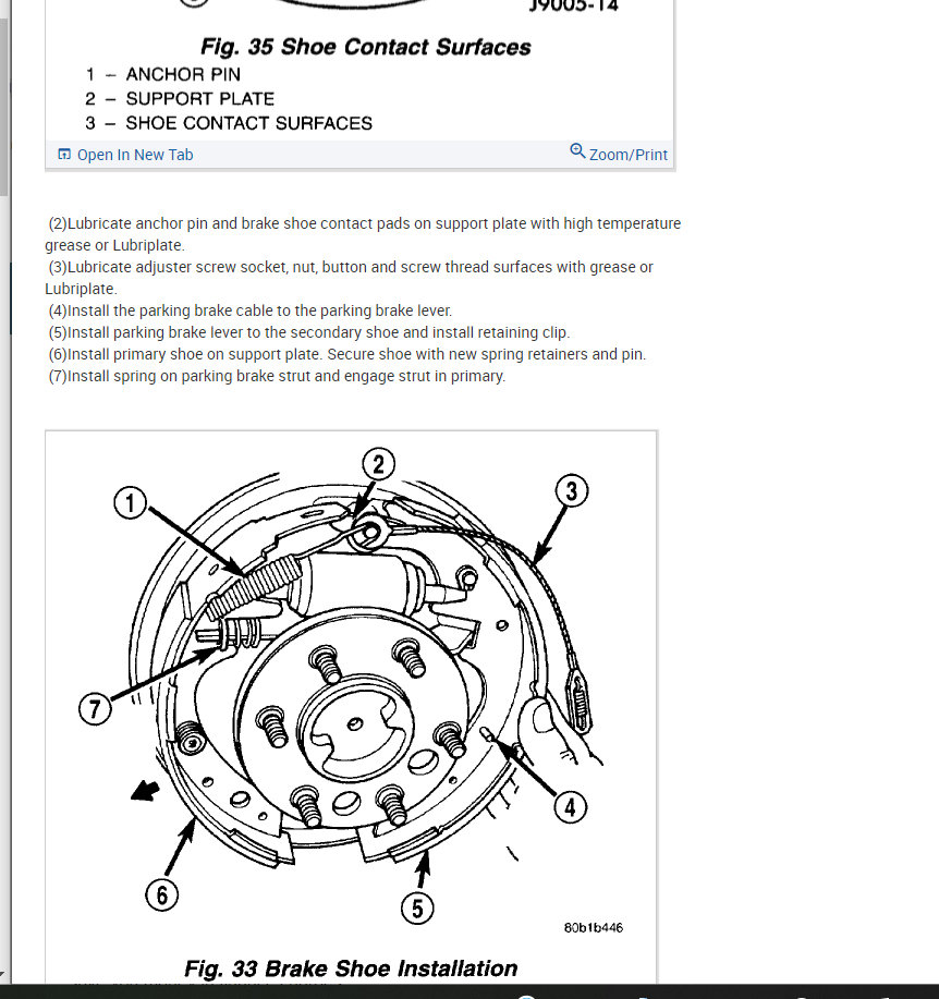

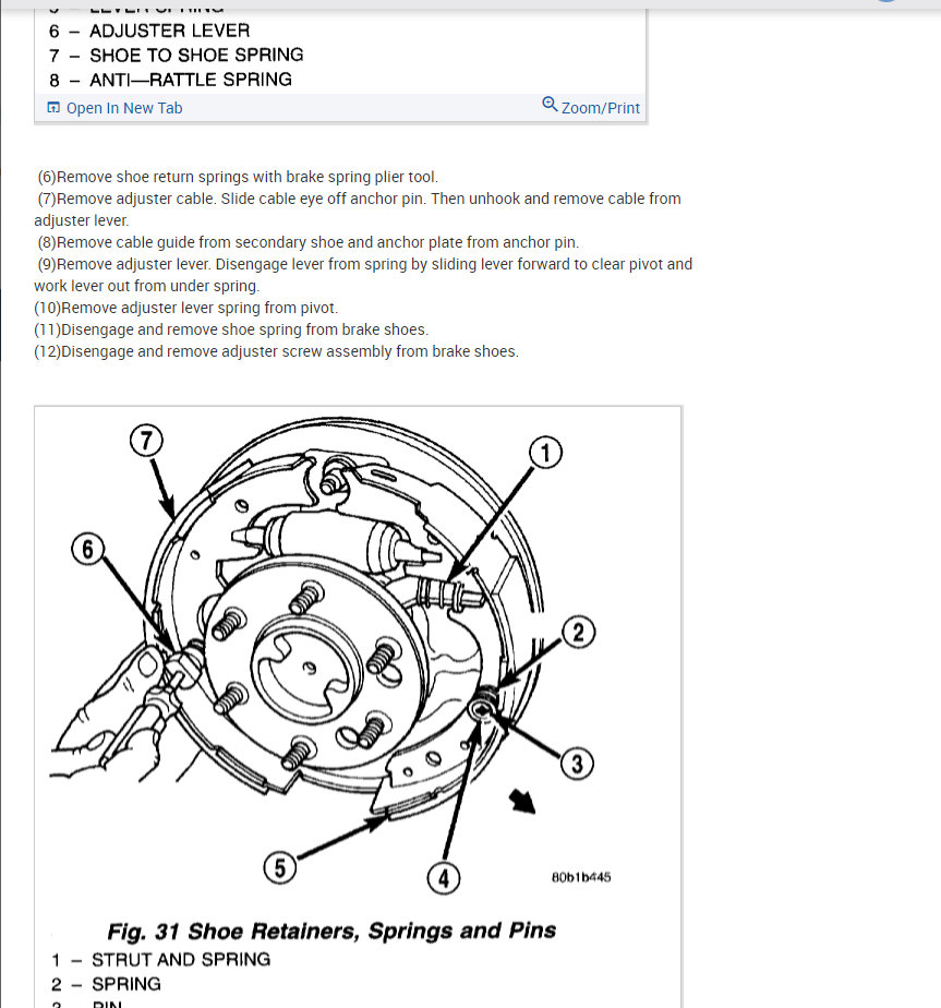

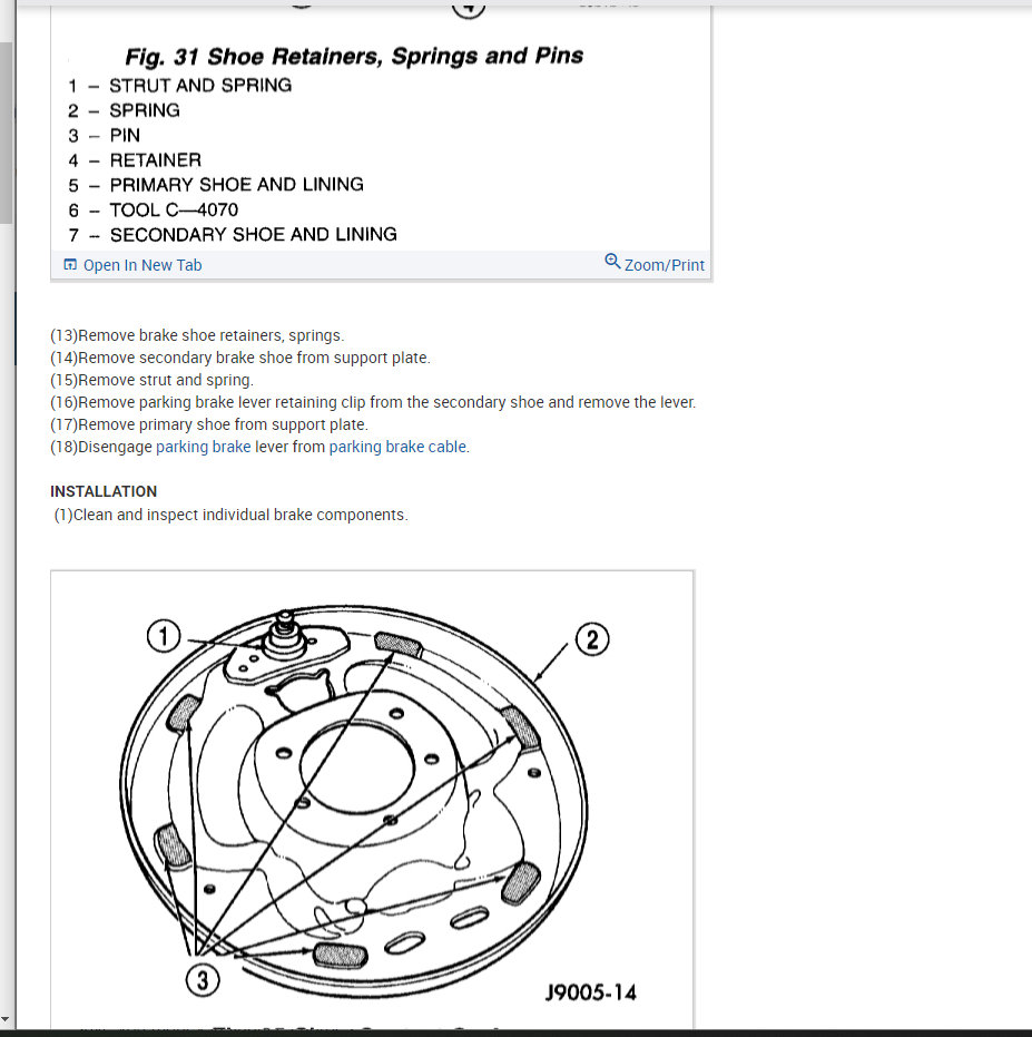

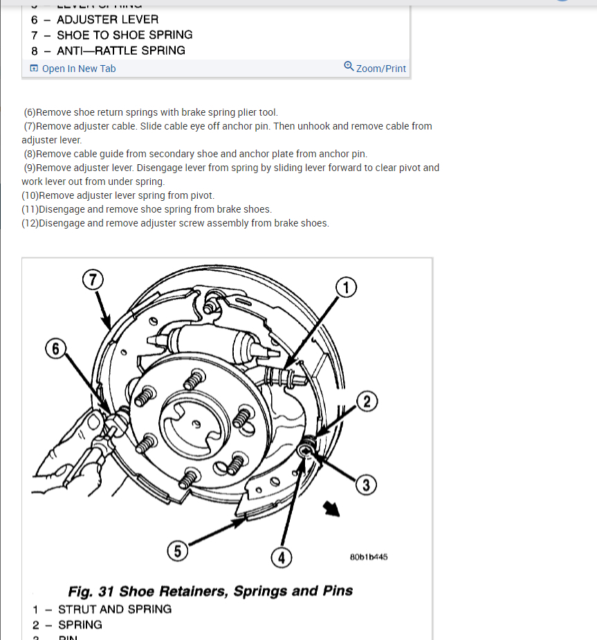

Based on the fact that this only happens in reverse makes me thing this is most likely a shoe getting stuck to the drum and the pop noise is it letting go and the noise is the shoe snapping back into place.
If it were me and you noticed a little more wear to the drums, I would replace them and then retest this.
Here is a guide that will help with this:
https://www.2carpros.com/articles/how-to-replace-rear-brake-shoes-and-drums
The reason this happens and does not affect braking is because the leading shoe does most of the stopping when driving forward. Then in reverse the trailing shoe is what does most of the braking. So, if the trailing shoe is sticking, you would not notice this because it is not doing much except when in reverse.
Please see the info below on how to replace this. Can you get a recording of this as well and that will help confirm this? Thanks
