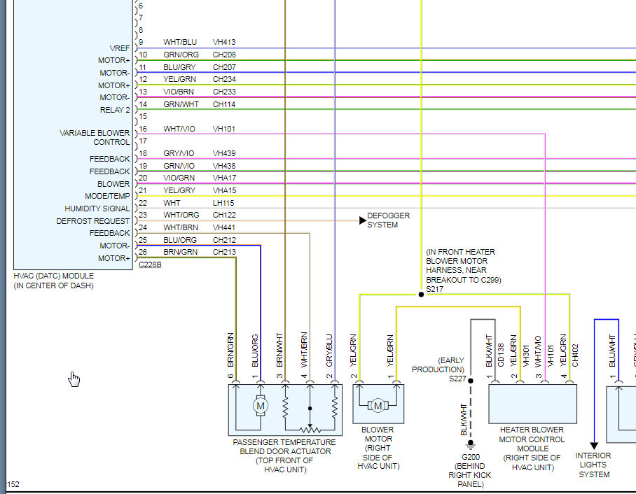

I think you guys are on the right path but I suspect you have either a wiring issue or a control module issue.
Can you tell me if you have a manual system, single or dual auto system?

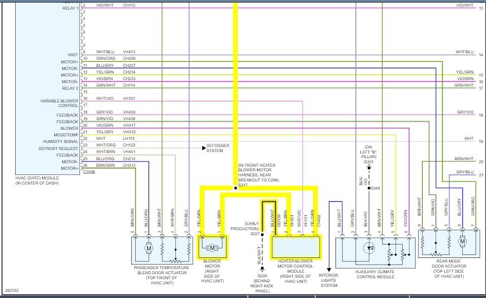

What I would suggest is putting a meter on the blower motor pin 2 and see what the voltage does when this issue happens. Basically we need to get it so that it is not operating and start checking for power at the motor and then go back in the circuit until you find power.
I suspect the splice that you see on the wiring diagram is the issue or it could be one of the terminals in the connector. Worst case, it is a control module issue. This is were we need to know which system you have.

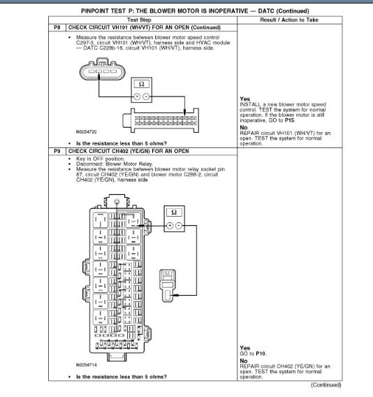

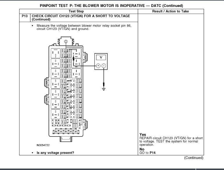

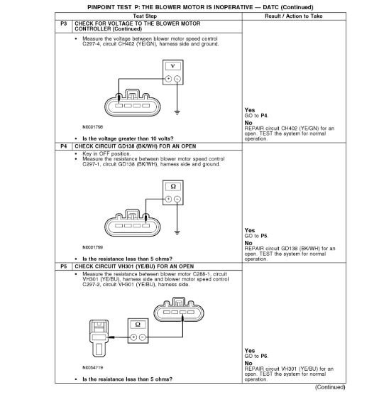

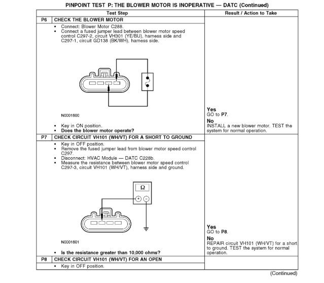

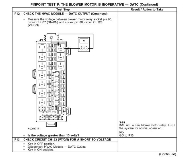

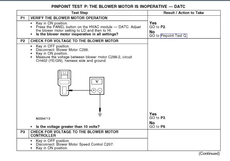

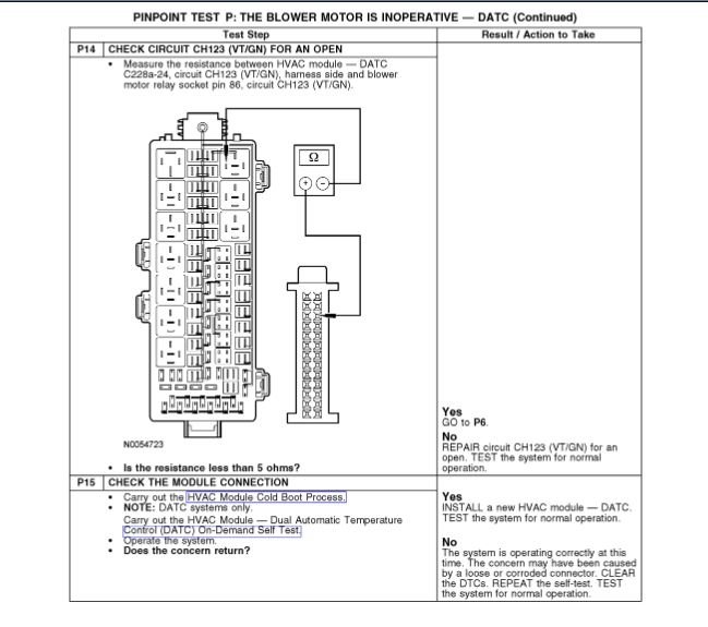

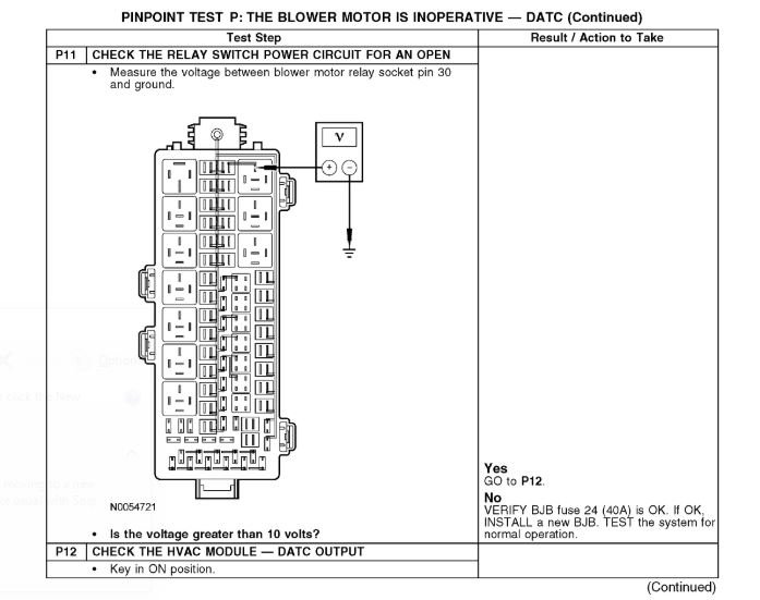

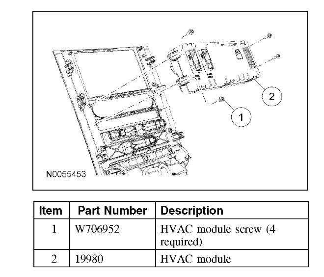

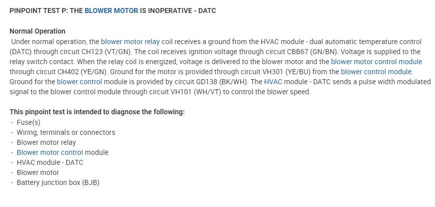

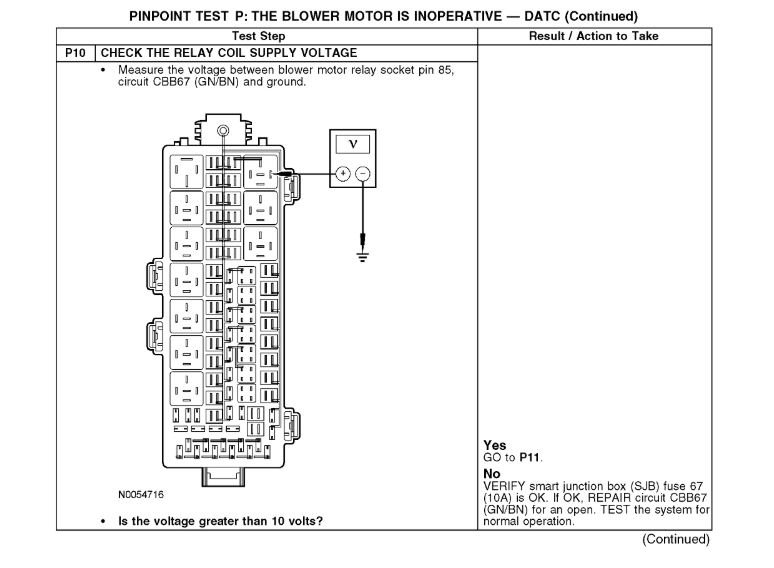

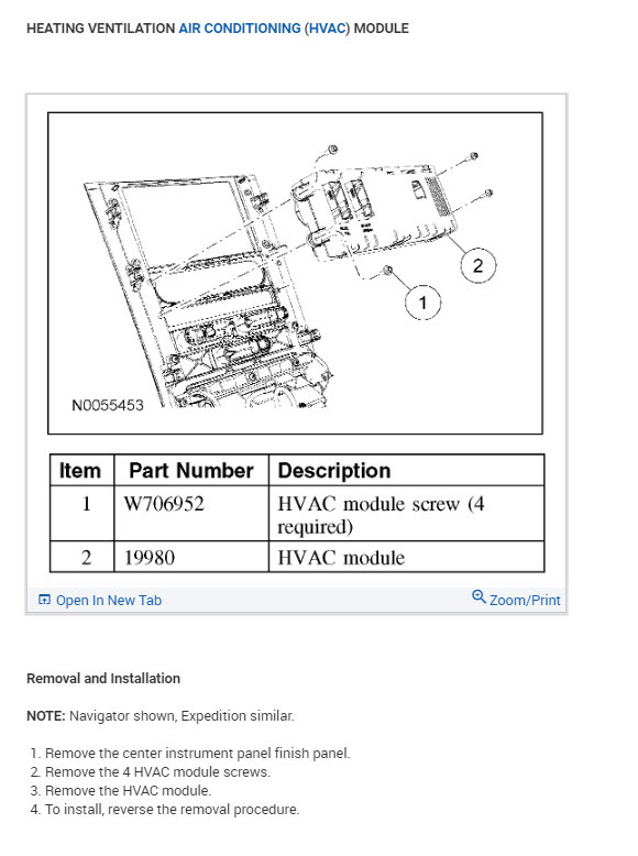

The control module is a common failure. It is available.
I attached the flow chart for you to follow for the determining the failure.
Feb 15, 2020 at 5:35 AM

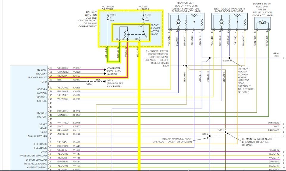

The control module is replaceable as a new component. You don't have to find one used. I am sure they are readily available.
So we just need to track power backwards in the system starting at the motor until we find it when it is acting up and that will be the issue.
