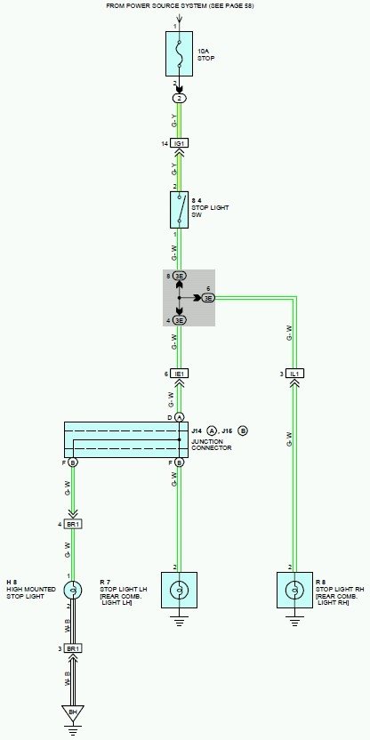

The passenger side tail lamp and high mounted center third light is not illuminating for braking or night running light (the former being a two filament bulb, runs from the same bulb housing within the tail fixture, the latter being a single bulb lamp mounted in the lift-gate).
I have troubleshooted the bulbs and replaced and cross tested. Reviewed fuses in the engine compartment ("tail") all of which appear to be fine, and have replaced them anyway.
All other passenger side tail light functions are okay: reverse lights up, turn signals and emergency flashing, all good.
I did a voltage check within the tail light fixture itself at the bulb mount points (checked for corrosion, pried them up a bit, etc), and at the receptacle for the third lamp. no juice is getting to either, but the driver side tail light is functioning perfectly normally.
How to I track my way back up the faulty line to test where the short is?

The brake lights are all fed from the brake switch through a three way splice in the wiring. The Left rear and CHMSL are split off after that splice into another connector. All three use individual grounds as well.
I would say you have at least two issues. The CHMSL is likely a broken wire, the wires have to flex every time the gate opens and the wire is not that flexible. The passenger side light sounds like it may be a bad socket or failed ground for that bulb as both filaments are out and that is the only common item.
