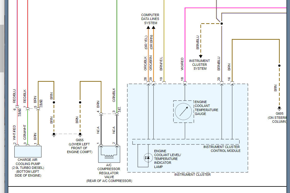

After the car has sat for a long period of time (overnight) and I go to start it, turn A/C on, no cold air will blow even after a few minutes. If I turn the A/C switch off and back on again, it may begin to kick in faster. however, it always seems to eventually get going.
This A/C was just serviced (about 4 weeks ago) and there are no leaks in the system and is in great running condition, blows very cold. What's most odd is this behavior is only upon the first start of the car of the day; all subsequent engine starts throughout the rest of the day, the A/C works instantly.
I am wondering if this could be a fuse or relay issues.. Please assist!
Thanks!

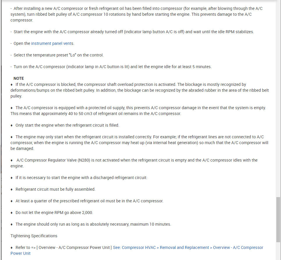

Here are a couple guides that talk about this issue in general but I think you are going to have a control issue so let's find out about the info above:
https://www.2carpros.com/articles/replace-air-conditioner-compressor

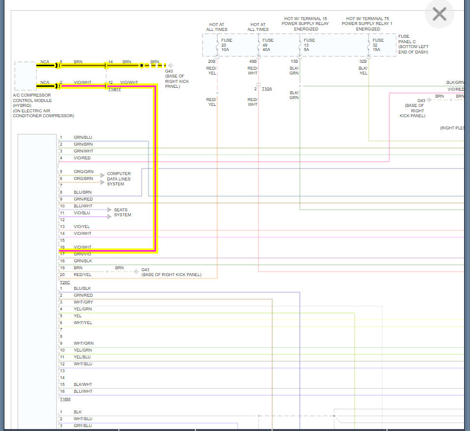

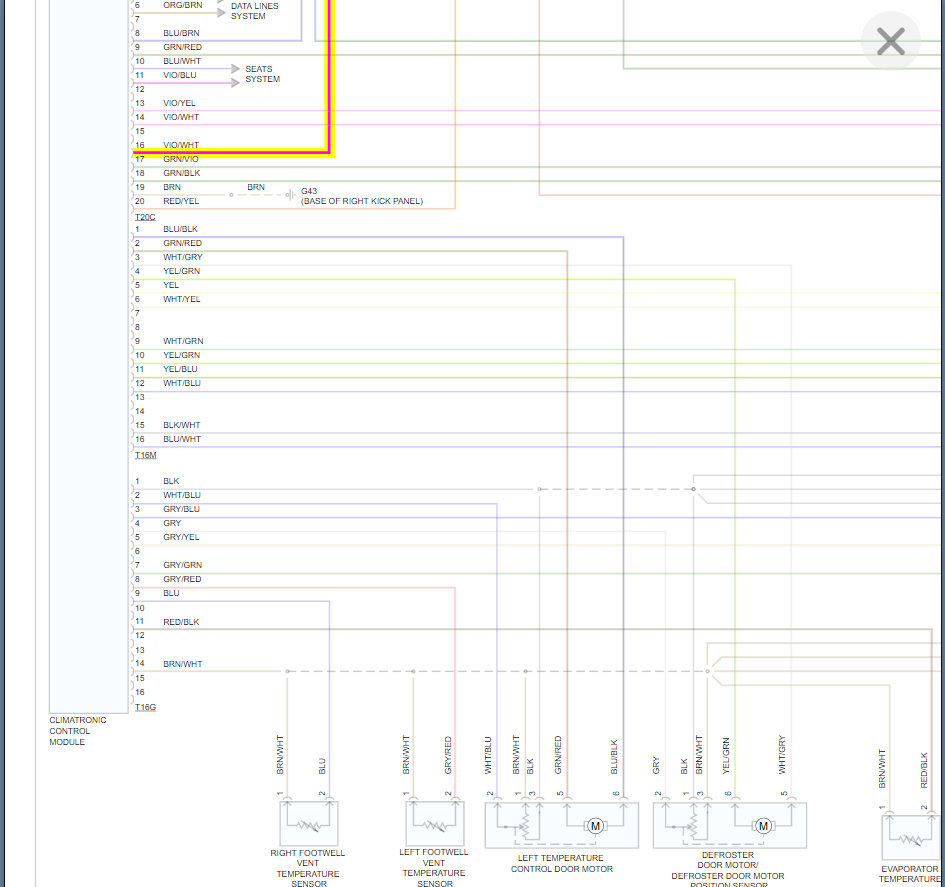

More than likely we are going to have to check the voltage at the compressor to find out if the control module is commanding the compressor on or not. If you want to go ahead and check this then I included the wiring diagram below and the location of the control valve on the compressor. Clearly if you have a different system then the wiring color could be different but it is still going to be a power and a ground. So just check the voltage across both wires. Meaning put your meter leads in both wires. If you have a negative number then they are just reversed but the actual voltage will be the same. So if you have 12 volts or -12 volts, it is still just 12 volts.
You should have 12 volts when the compressor is to be on so here is a guide that will help with testing this.
Please see below for the info that I am referring too and let us know what questions you have.
Thanks

Okay. That is good info. It is not going to change how to test the voltage across the two wire connector at the back of the compressor but it does change the what in which it is controlled. This does not have an external relay. It only has the Climatronic control module which is what turns the compressor clutch on and off.
So if it is doesn't turn on then I suspect the control module is the issue. However, it is worth checking the voltage when the A/C is on but the compressor is not turning on first thing in the morning. If you have voltage then the compressor is the issue. If no voltage then the control module needs to be replaced.
Thanks. Let us know what you find.

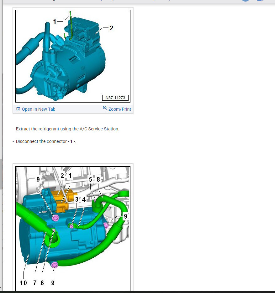

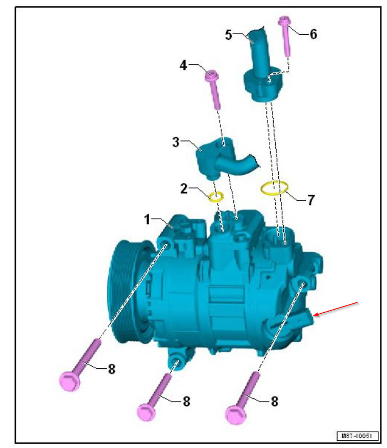

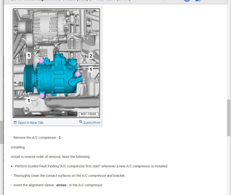

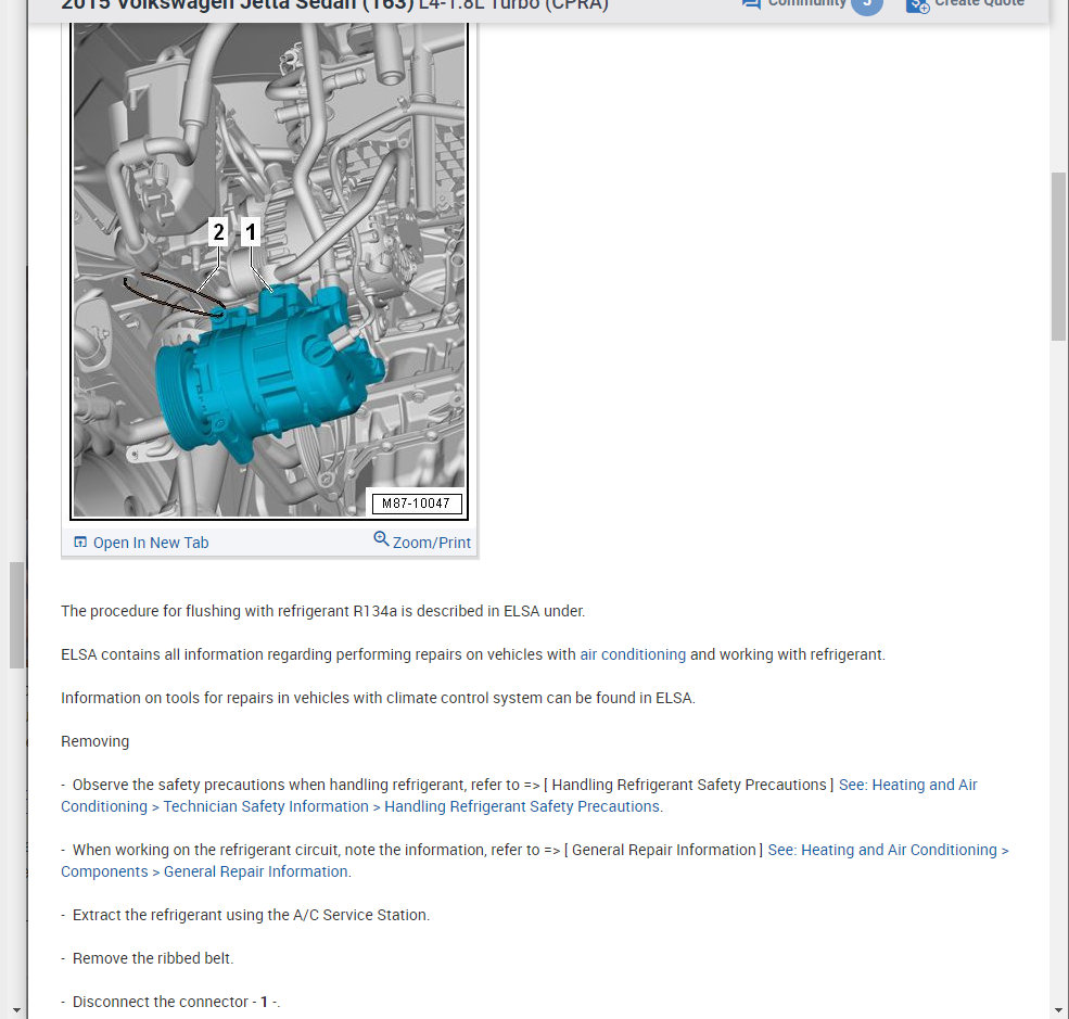

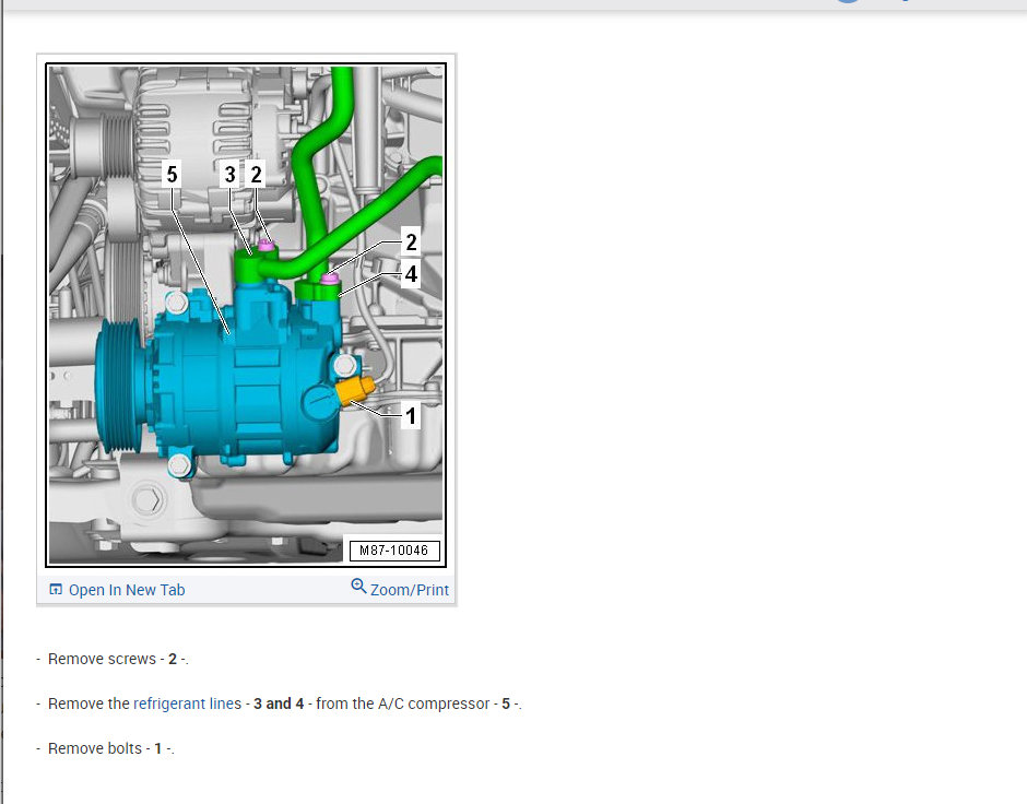

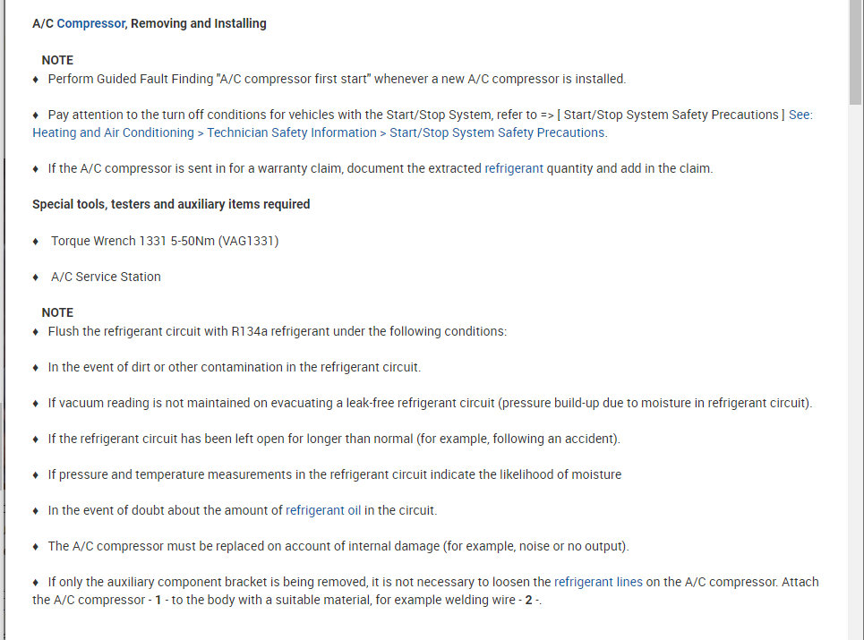

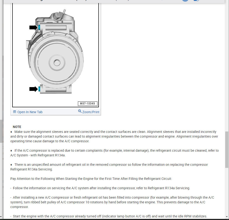

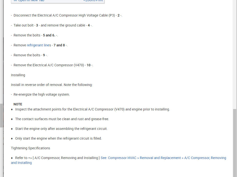

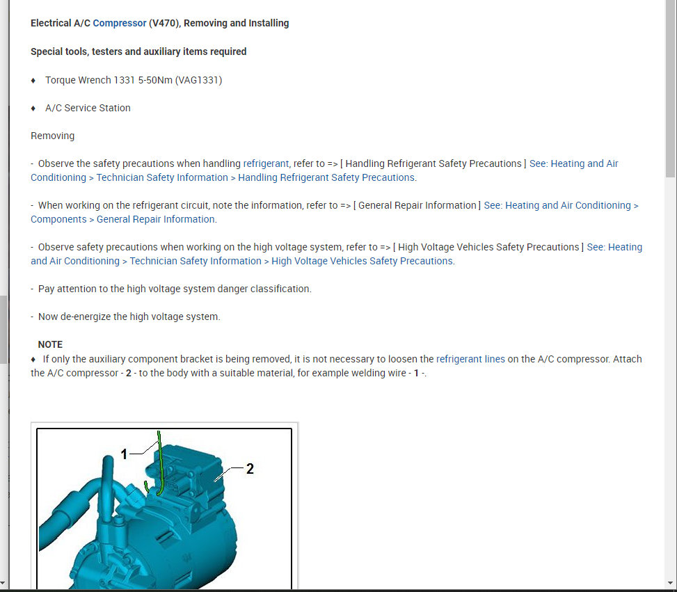

We are not able to know for sure how this was equipped without running the options on it and I don't have the ability to do that. So I am attaching the info below on these compressors and how to replace them.
The way to tell if there is a clutch is to watch when it turns on if there is a plate in the front that is not spinning and then starts spinning when it engages.
However, if there is no plate then you could have a non magnetic clutch or even a fully electric compressor.
Please see the info below on this and let us know if you have questions. If you still are not sure, get a couple pictures of the compressor and we can go from there. Thanks

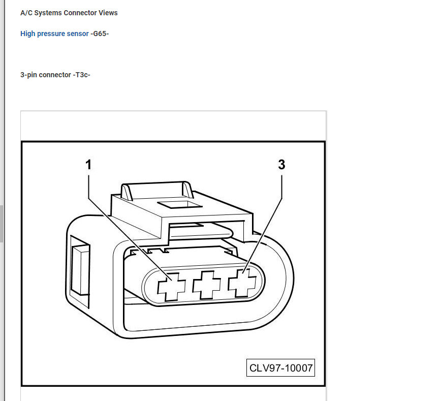

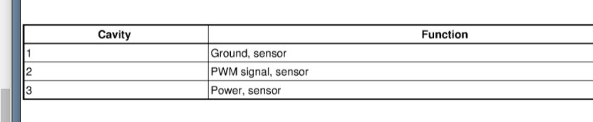

Correct. You only have a high pressure sensor. It is in the right front of the engine compartment. Below is a picture of the connector. I was trying to find the location but it does not give much info on it.
Jul 22, 2021 at 1:32 PM
