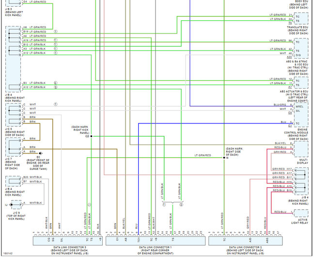

My scanner tool powers up but when I turn on the key it fails to communicate and gets an error.
I checked the following:
1. ODB fuse is good.
2. I get power on pin 16 of ODB port.
3. I made the female pins smaller on the ODB port to confirm the pins weren't too loose to make a connection.
4. I had an extra ECU that I put in for a quick test and still see the same issue.
5. Voltage I measure on the pins when I turn the key on. gnd to pin 7 - 8.3V, gnd to pin 13 - 11.04V, gnd to pin 14 - 11.35V.
6. started to unplug sensors one at a time but can't find them all.

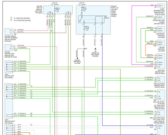

Have you tried the scanner on another car? Sometimes the scanner themselves are bad. I would also check the EFI 1 fuse 7.5 amp and the EFI relay to make sure they are working which is under the hood fuse panel. Here are the ODB2 wiring diagrams so you can see how the system works. Please go over this video as well.

This all started when I brought my car in to get it smogged, and they ran into a computer problem. I did, however, double-check that my scanner works on my other vehicle. I also confirmed the EFI 1 fuse is good, but for the relay, should I just confirm the resistance across the coil is between 50 and 120 ohms?
I watched the video, but it doesn't apply given that the port has power and the tested powers up.
Thanks!
Jul 16, 2025 at 2:41 PM
  • 55,553 POSTS
Yep, you can test the relay but this won't always work because the coil is not under load when testing, but if it is shorted or open that will show up. Let me know how it tests.
Jul 17, 2025 at 3:09 AM
BFERKINS
  • 9 POSTS
I tested the relay, and it's in spec resistance-wise (109 ohms), and I confirmed it was working by pulling it out and trying to start the car, which it did not.
What should I try next?
Jul 17, 2025 at 3:22 AM

Do you have 12 volts and pin # 13 lt grn/red with the key on?
Jul 17, 2025 at 5:47 AM
BFERKINS
  • 9 POSTS
I have 11.04V on Pin 13 when the key is on.
Pin 7 - 8.3V, pin 13 - 11.04V, pin 14 - 11.35V.

Does the wht/blk wire have a good ground? Pin 4?
Jul 18, 2025 at 2:13 AM
BFERKINS
  • 9 POSTS
Yes. I checked the continuity between pin 4 and 5 and to chassis ground and it's good.
Jul 18, 2025 at 2:29 AM
  • 55,553 POSTS
Lets check the white wire from the connector to the PCM. Let me know
Jul 19, 2025 at 2:25 AM
BFERKINS
  • 9 POSTS
Pin 7? That is reading 8.3V
Jul 19, 2025 at 10:54 AM
  • 55,553 POSTS
Yes pin 7, you must unplug the PCM and check the continuity between the connector and the PCM.
Jul 20, 2025 at 3:10 AM
BFERKINS
  • 9 POSTS
Confirmed that I have continuity between pin7 of the ODB connector and the ECU connector with the same white wire.
Jul 20, 2025 at 9:34 AM
  • 55,553 POSTS
Hmm, I know the engine runs but the diagnostic program inside the PCM must be bad. You tested all of the wires for continuity, power and ground, so the PCM is the only thing left.
