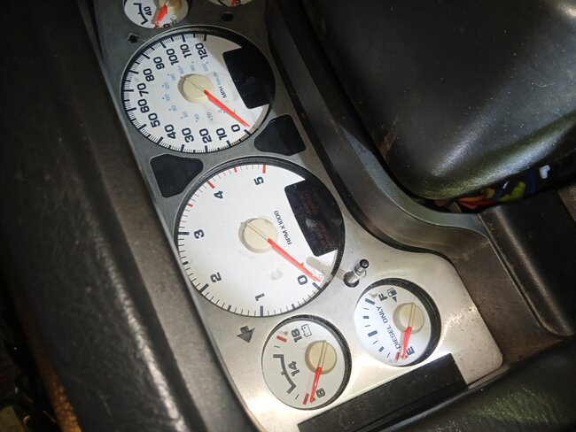

Not getting my odb2 to respond to scanners. Plus, my cluster is not working, plus it's a no start diesel plus it only tries to turn over in neutral.

And now that I replaced the CP3; my gauges don't move, but my shifter shows what gear I'm going into.

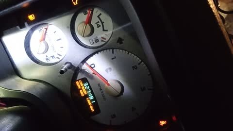

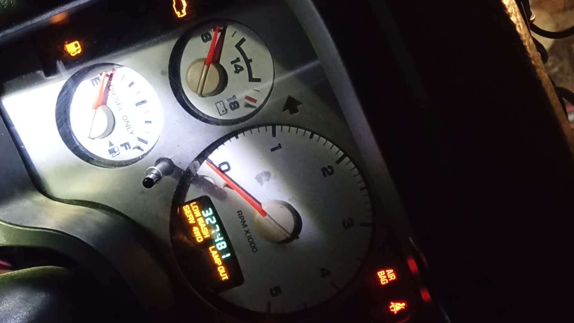

Here is a video.

Okay, if the replacement engine is a 03 it shouldn't be compatibility. I didn't see any tach bounce while you were cranking it. When you turn the key on do the gauges do anything?

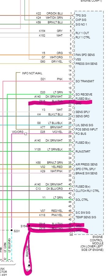

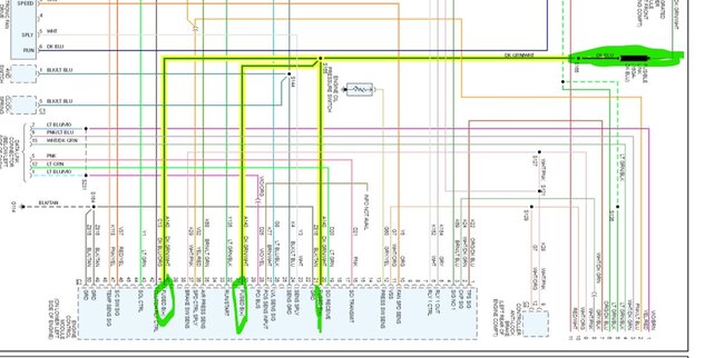

If not, then I suspect we are going to need to verify the powers and grounds to the ECU and the dash as a starting point.
Attached are the powers and grounds that feed the ECU. I would check the fusible link that feeds the power to it and make sure it is there.

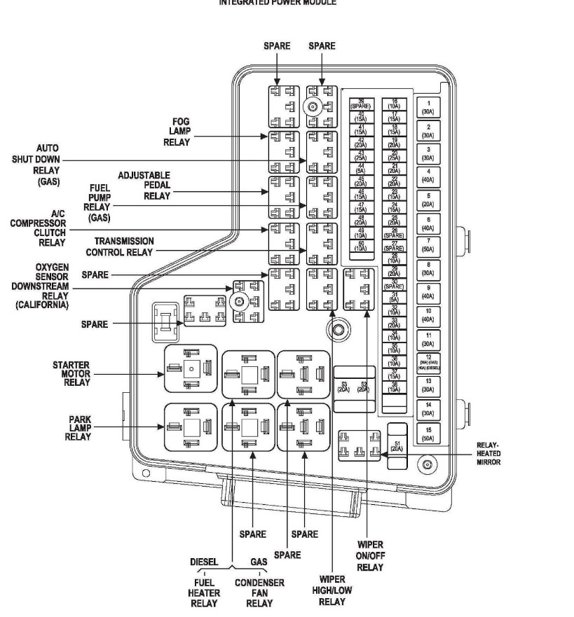

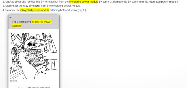

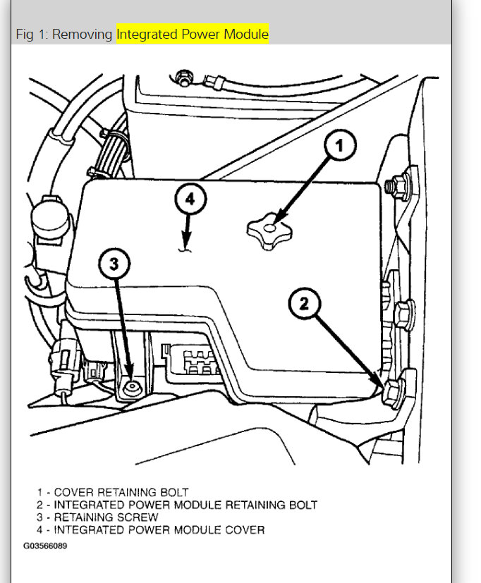

I would first check the fuse #51 in the TIPM for power in the left rear of the engine compartment.
This guide will show you how:
If there is no power, I would replace the TIPM which is easy to do because it-self learns. Here is how that is done in the images below. Please let us know what happens.
Feb 3, 2023 at 2:09 AM (Merged)
  • 55,433 POSTS
I have also seen the cluster cause this issue as well. Can you please check the fuse #51 for power?
