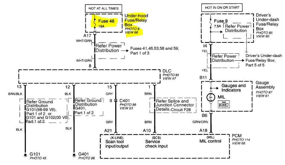

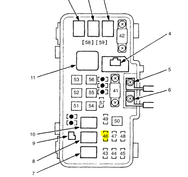

When you connect the scanner, does it power on? If not, start by checking fuse 46 in the under-hood fuse box.
I attached a pic below showing the fuse location. Here is a link you may find helpful as well:

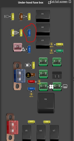

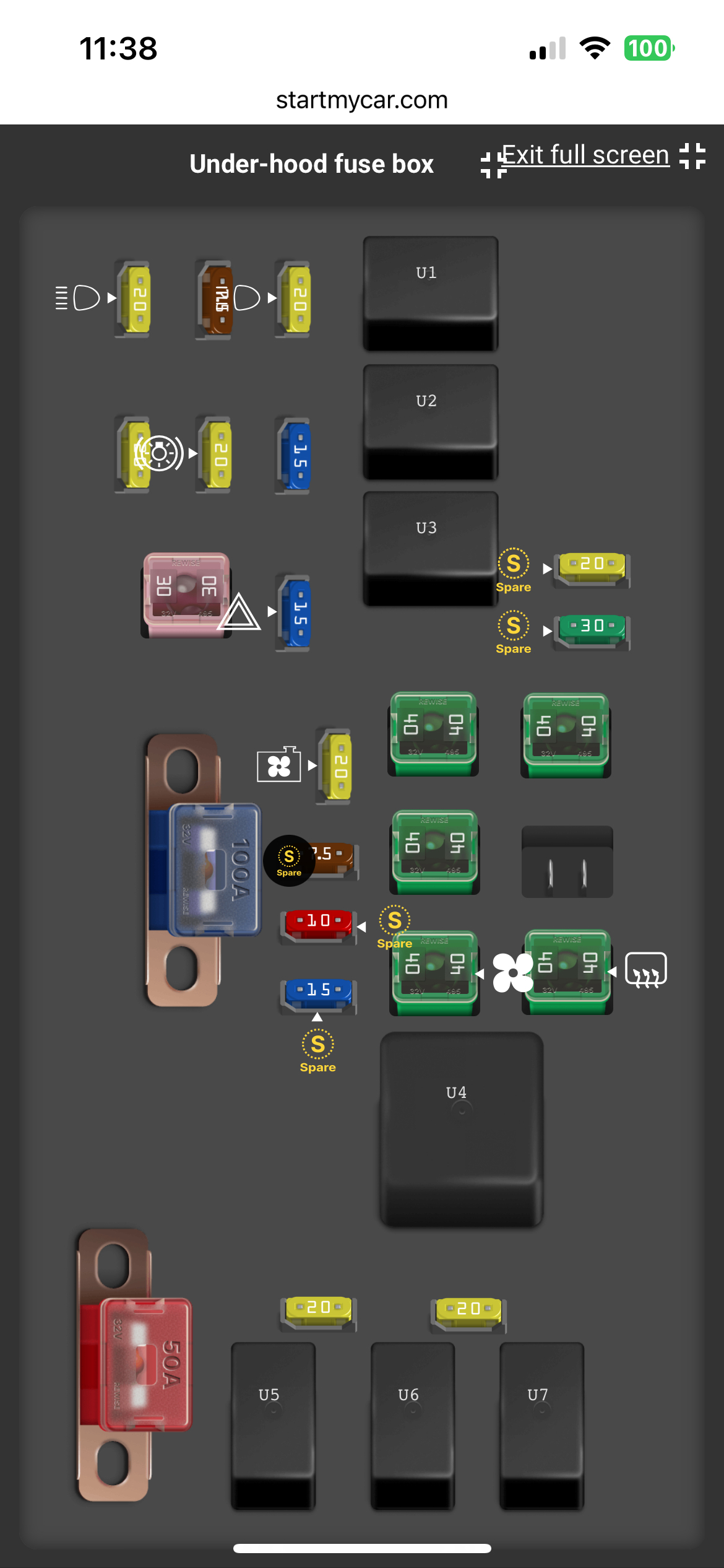

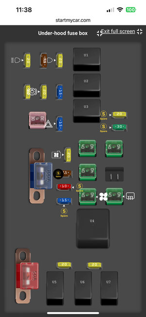

The scanner doesn’t power on. Here’s a diagram of the fuse box under the hood.
Sep 15, 2024 at 1:53 PM
  • 110,244 POSTS

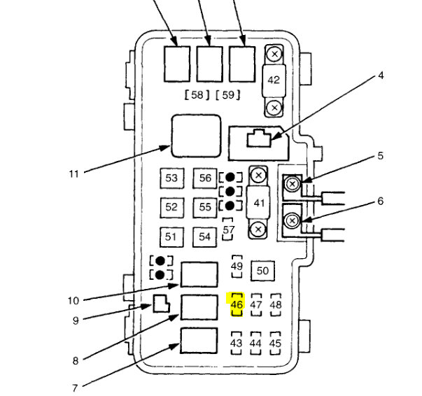

That's the correct pic I put above. If you look below, I copied your picture and circled the fuse to check.
See pic below.
