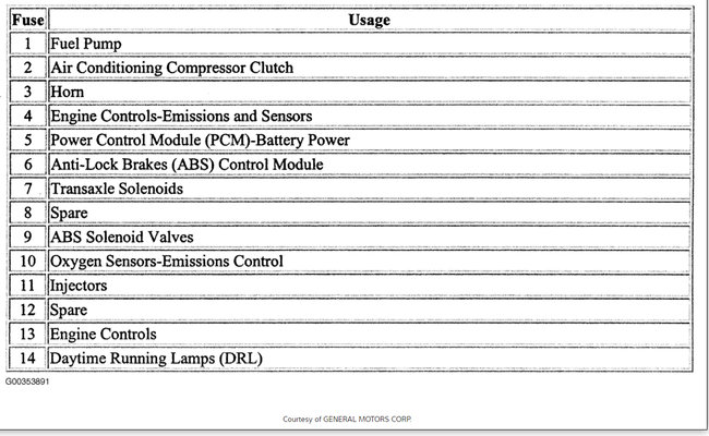

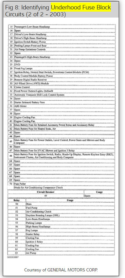

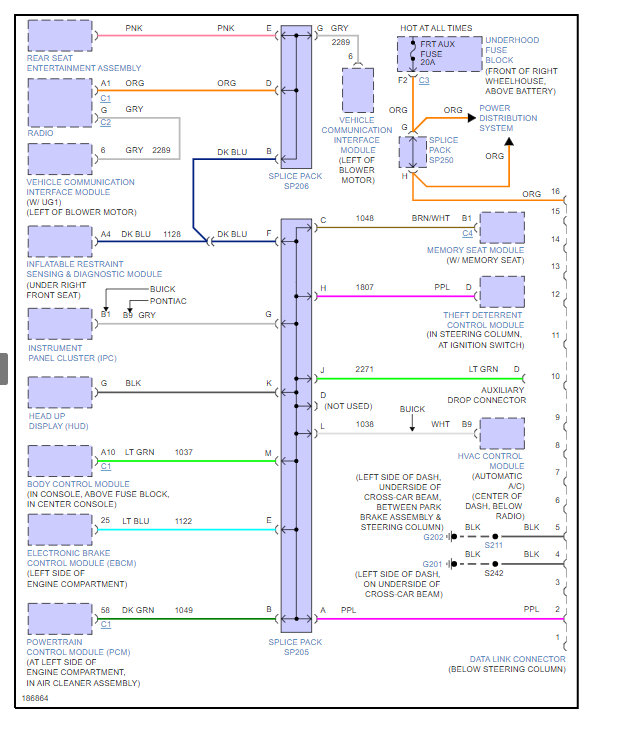

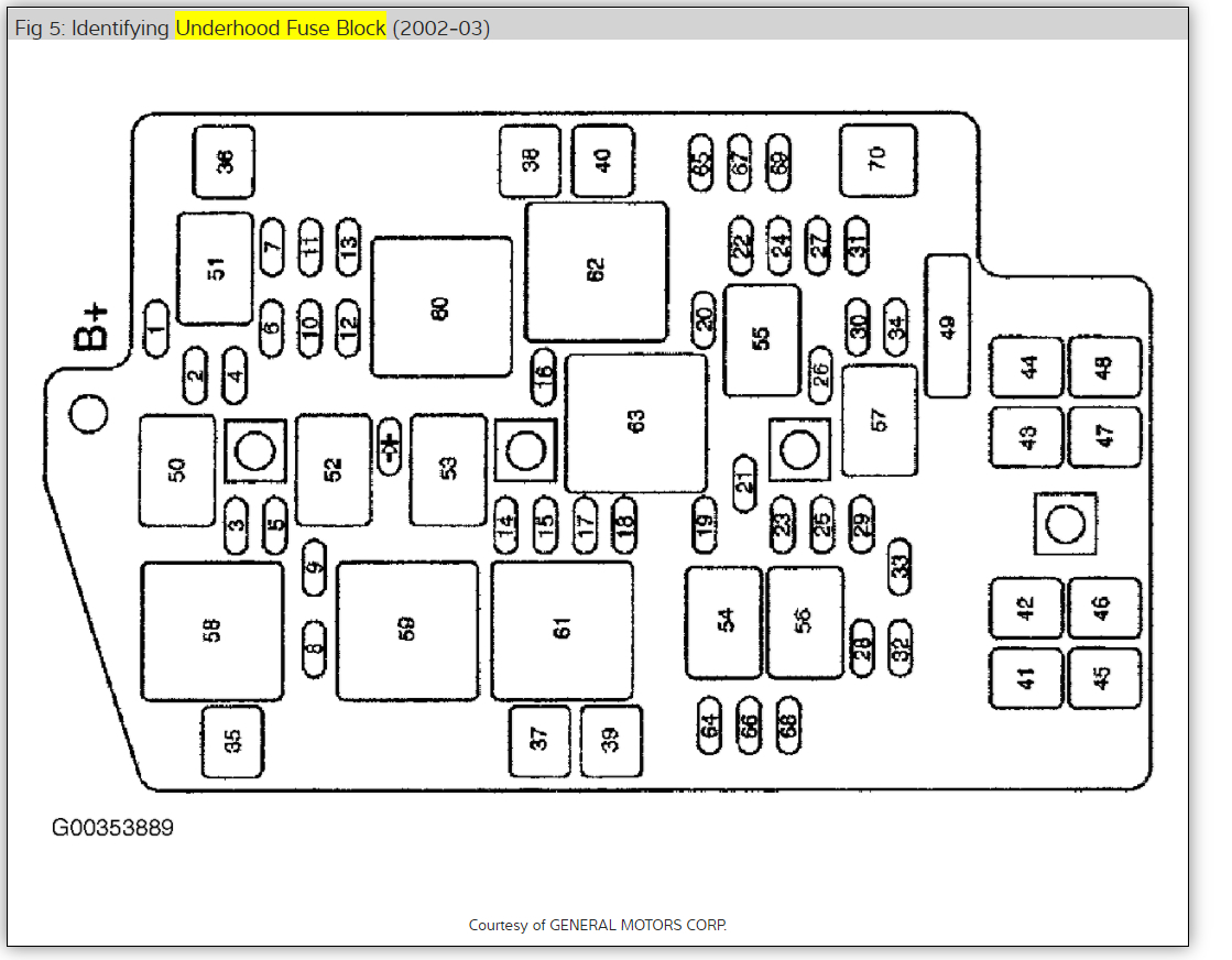

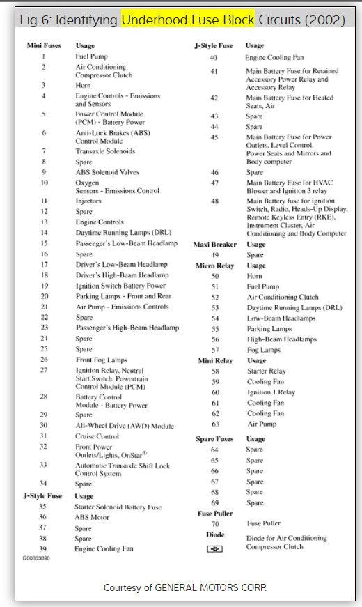

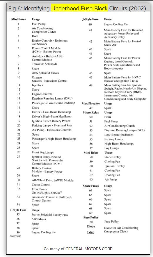

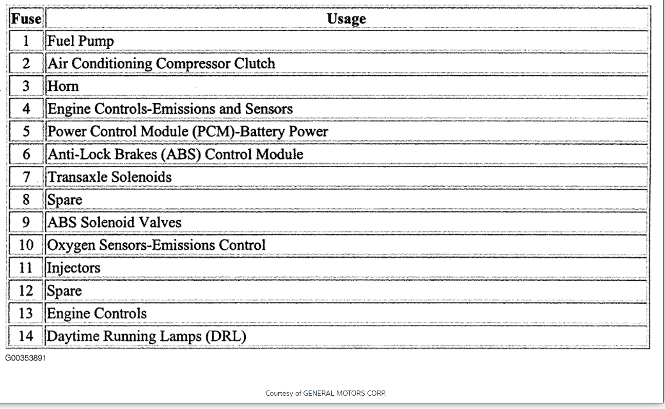

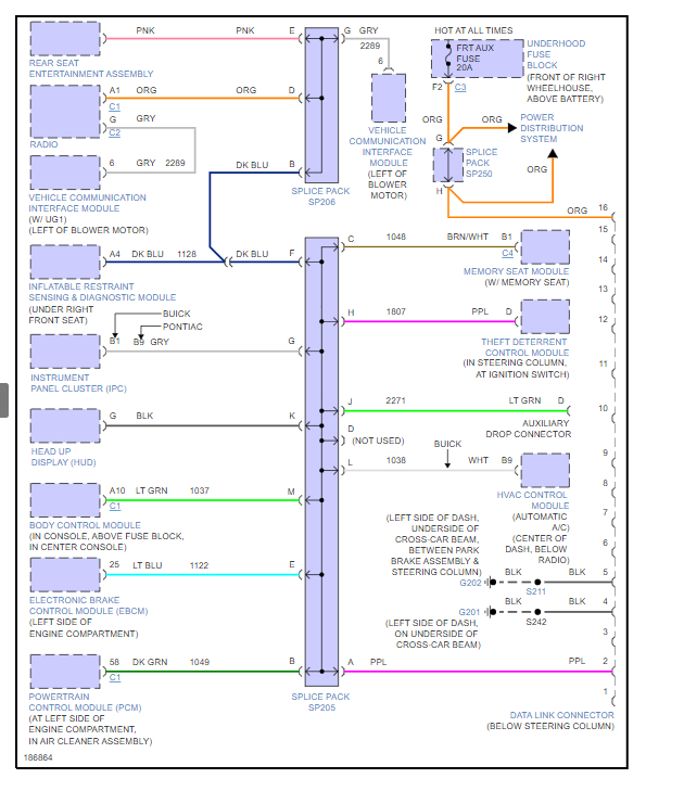

I just watched the video and on my car the fuse for the DLC is not listed on the diagram. I just need to know which fuse it is.
Aug 22, 2022 at 8:51 AM
  • 55,423 POSTS
The power for the OBD2 connector is the FRT AUX fuse. in the under-hood fuse panel this guide can help you check for power, and I have included the OBD2 connector wiring diagram so you can see how it works.
