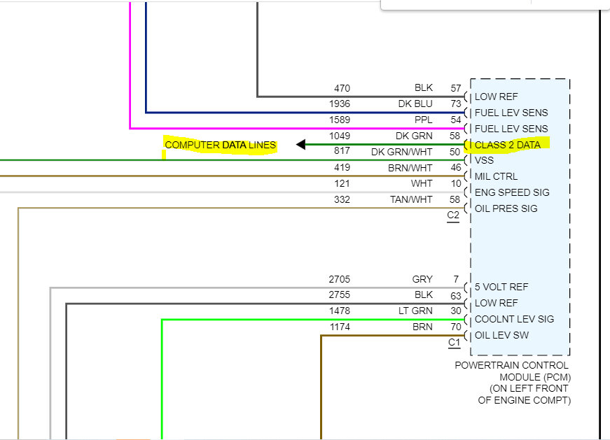

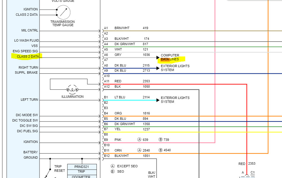

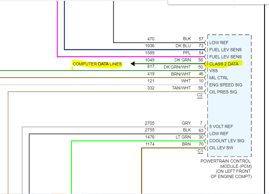

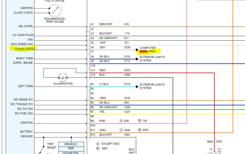

These vehicles are known for instrument cluster failure. In this case, the cluster is connected to the powertrain control module via a class 2 serial data line. I suspect there is a short in the cluster that is causing the PCM to disable the data link connector.
If I understand correctly, they are failing the vehicle emission inspection because the ABS and seat belt lamp are staying on? I'm not sure where you are located, but I don't see why those two things would fail it for emissions. I could understand the seat belt lamp failing a safety inspection but not emissions. (sorry, I inspect in PA. I don't understand why different places have different expectations). I just feel it is unfair to the consumer.
Regardless, I attached a couple of pics below related to the cluster and the serial data line I'm referring to. I feel (and I can be wrong) the cluster needs replaced. Pin 2 in the DLC connects the class 2 serial data line. My theory is the cluster has shorted and when connected, it cuts power at the DLC.
Let me know your thoughts or what I can do to help.
Take care and Happy Easter,
See pics below. Note: Pic 2 is at the cluster connection. Pic 1 is the PCM.

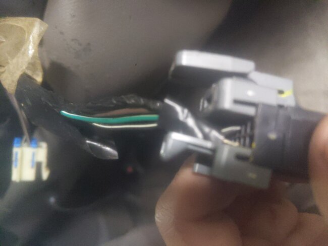

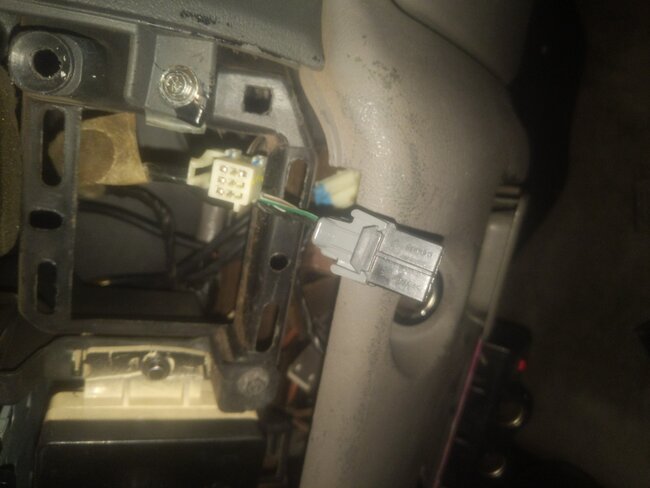

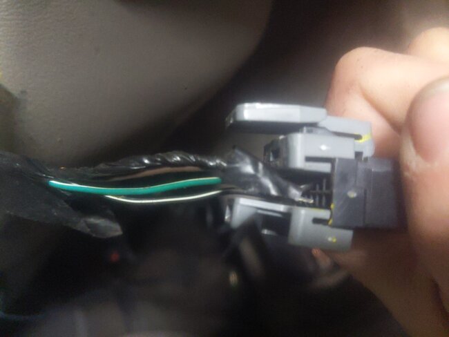

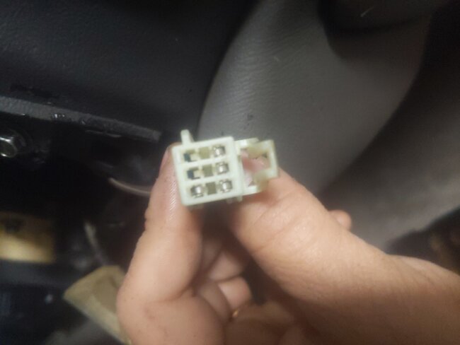

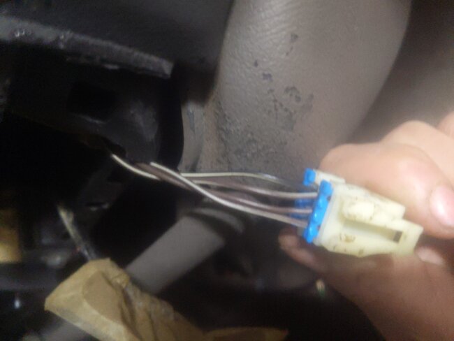

Your probably correct on bad cluster. I've pretty much eliminated all other possibilities over the past few months. Also, while I was tinkering around in my dash, I came across these two plugs behind my stereo and A/C. What are they for and should they be plugged into something? Happy Easter to you. And thank you for the info. I have to admit this forum has been awesome, never fails to educate and impress.
Apr 8, 2023 at 4:12 PM
  • 110,240 POSTS
First, you are very welcome. It's nice to hear we help, so thank you. As far as the connections, chances are they are for optional equipment and not used. However, if you can provide me with the wire colors for each connector (I see green, gray and I think black) to one of them. Could you confirm what colors go to which plug? Also, regarding the black connector that is hanging, how many pins are in that connector?
Apr 10, 2023 at 12:28 PM
CBLUEDOG
  • 6 POSTS
The black plug has four pins in it with a black and white striped green a brown and seems to be a completely bare wire just taped up with can't seem to find the end. The white pin has four pins in it with a black/ white stripe a brown a white/grey and grey.

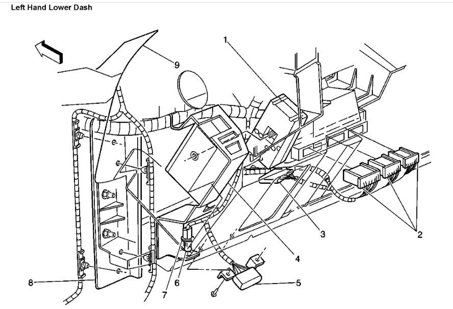

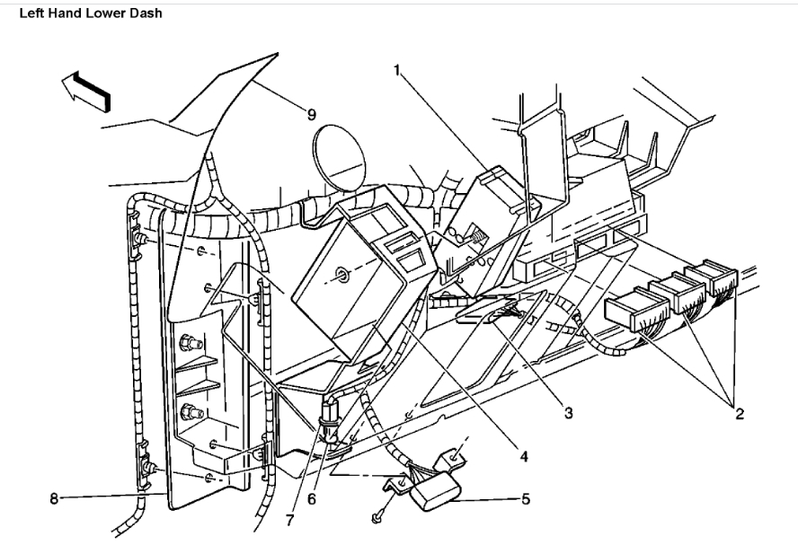

I went through the power distribution, lighting, and powertrain management schematics and cannot locate those connector pins with wire colors as described.
I attached a pic below of connectors under the dash. Could you let me know approximately where they are located, or do you see them?
joe
See pic below.
