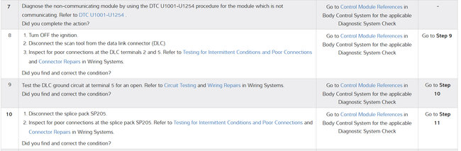

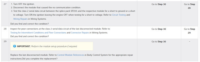

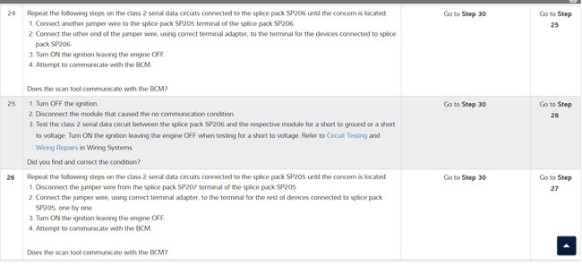

My odb hooks up to odb for inspection it gives it power to start up but it say on the computer that there is a bad connection to port and because of this I can't pass inspection.I have checked the fuse to the cigarette lighter it's a 15 amp fuse and it's still good, but all my cigarette lighter ports are not working.
Feb 25, 2019 at 8:18 AM
SCGRANTURISMO
  • 4,897 POSTS

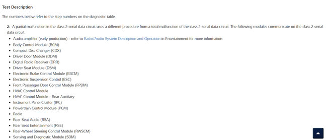

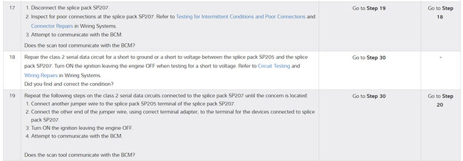

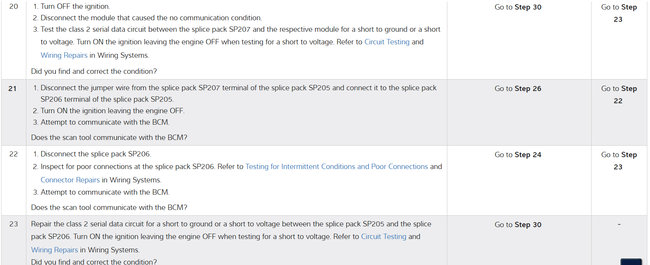

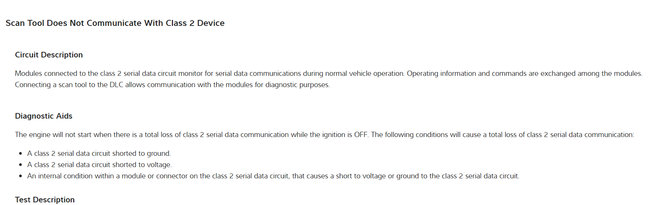

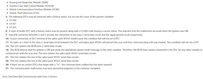

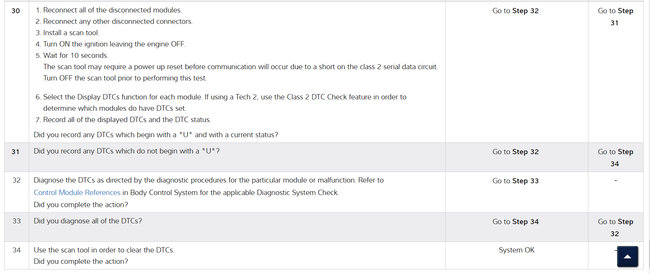

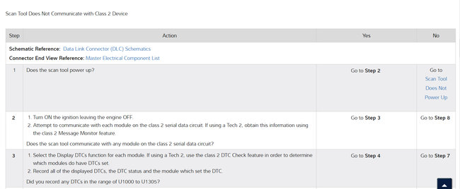

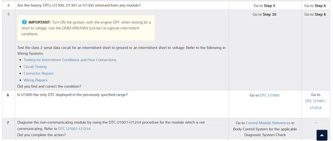

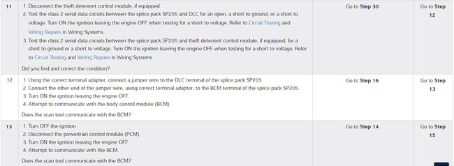

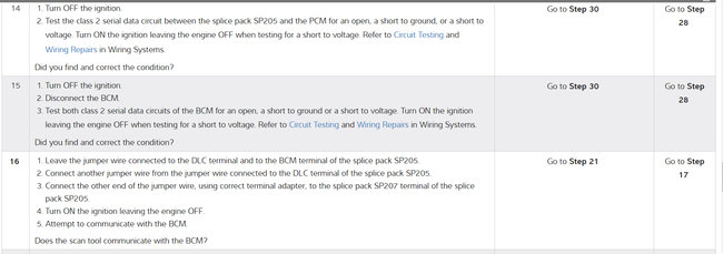

This could be a problem with the connector or the wiring to the connector. In the diagrams down below I have put a step by step diagnostic troubleshooting guide for troubleshooting your vehicles diagnostic connector. Please go through it and get back to us with what you find out.
Thanks,
Alex
