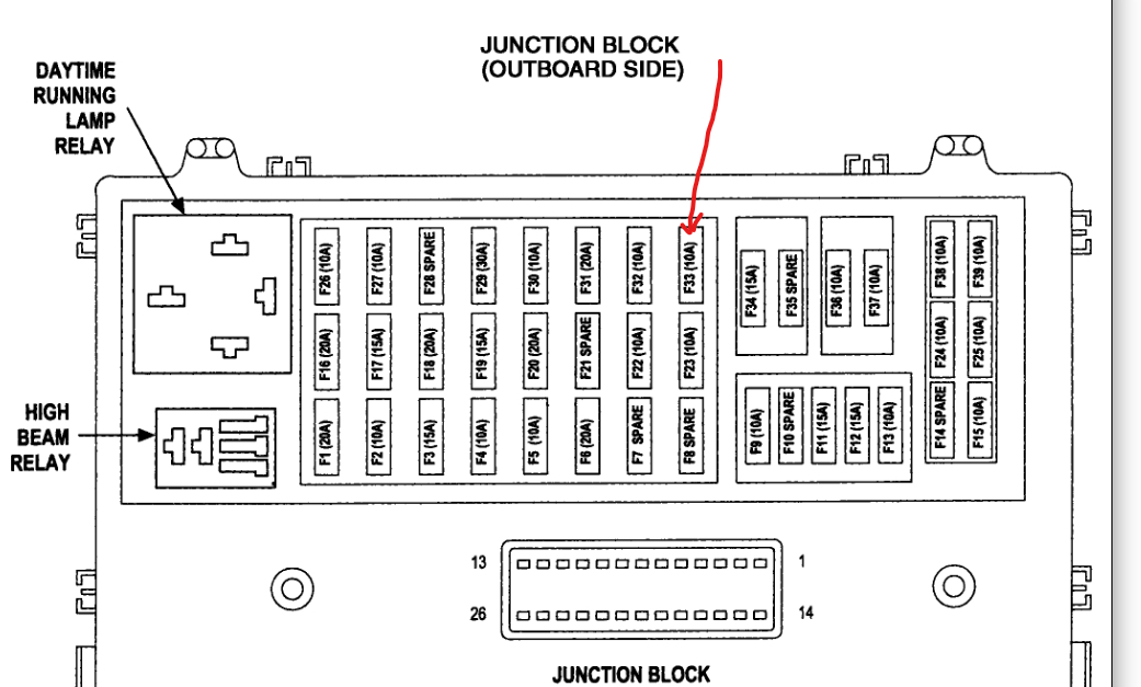

First, make sure the scanner works on another car, then we need to check the fuse # 33 10 amp in the fuse panel below the left side of the dash.
Here is the fuse location, Check out the images (below). Please let us know what happens.

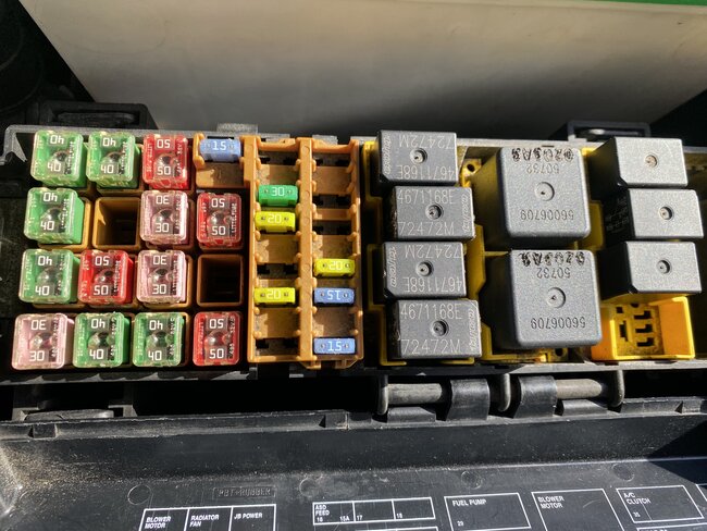

I will check all of the fuses in the cabin. I’ll pull each fuse out and visually check it. I can tell you that all the fuses are good.

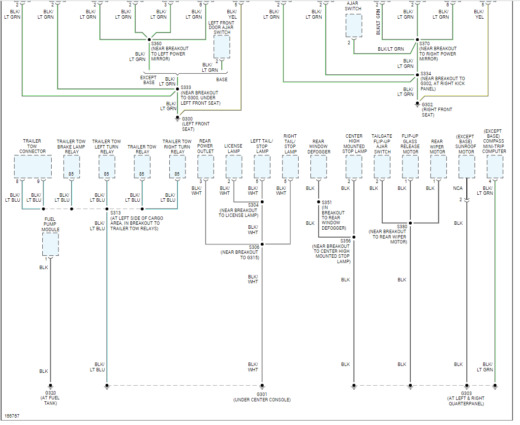

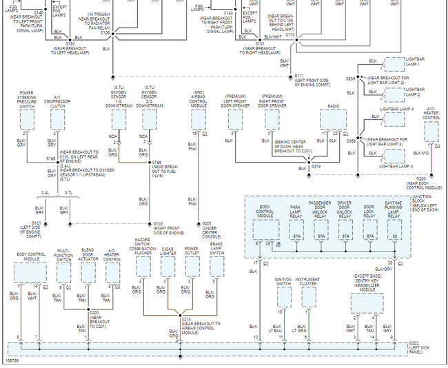

Would you happen to have a grounds diagram for all of the grounds on the Jeep? I saw a video on YouTube and the mechanic had one and he was going to test all the grounds. I checked the grounds visually in the engine compartment that are attached to body of the engine bay. I have a pdf 2003JeepKJServiceManual.pdf that I use. I only have the one diagram that is attached, and I guess I’ll check those grounds if I can find them. I have been using this pdf for assistance. 8W is the chapter where I'm working from. I have watched Ryan's video a few times on testing the OBD 2 and his was a blown fuse. I should be so lucky…

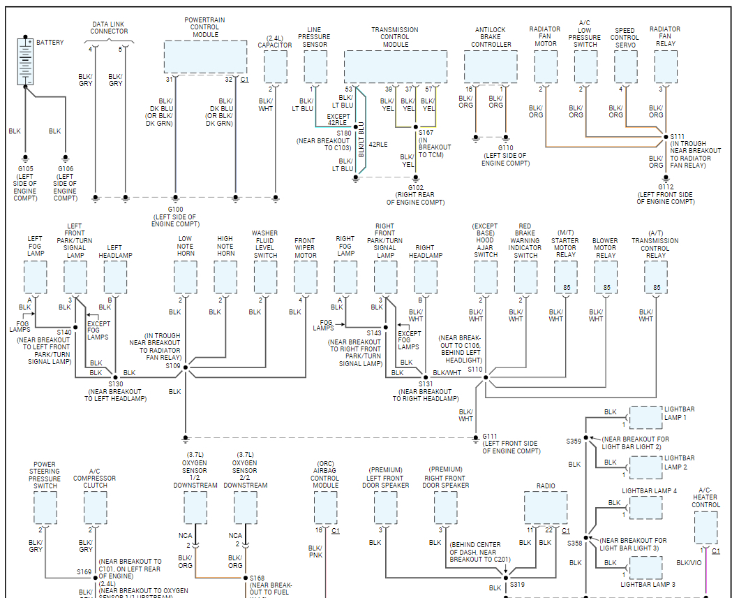

Yep, fuse #33 powers the OBD2 connector so we are getting closer. Fuse #33 also powers the immobilizer. Fuse #33 gets it power from fuse #3 in the main fuse panel under the hood, it is a 50-amp fuse. Can you please check it? Let me know.

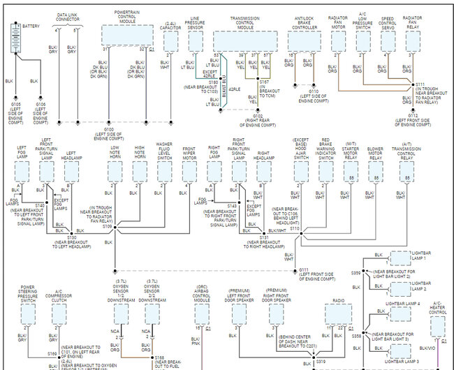

All of the fuses are good. Perhaps you can see them in the photos. I actually swapped it with the one diagonal to it. Do you have a diagram of the grounds?
Dec 8, 2023 at 1:47 AM
  • 55,412 POSTS

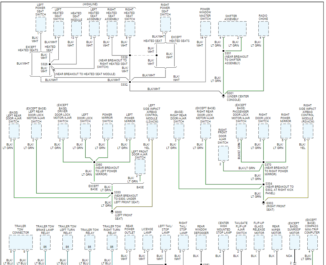

If Fuse #33 is not getting power it is not the ground, but here are the ground diagrams for you. You may have a bad PDC. Check out the images (below). Let us know how it goes.

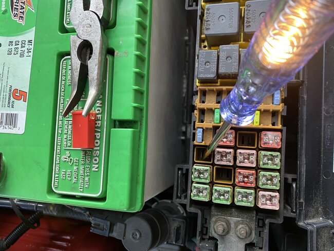

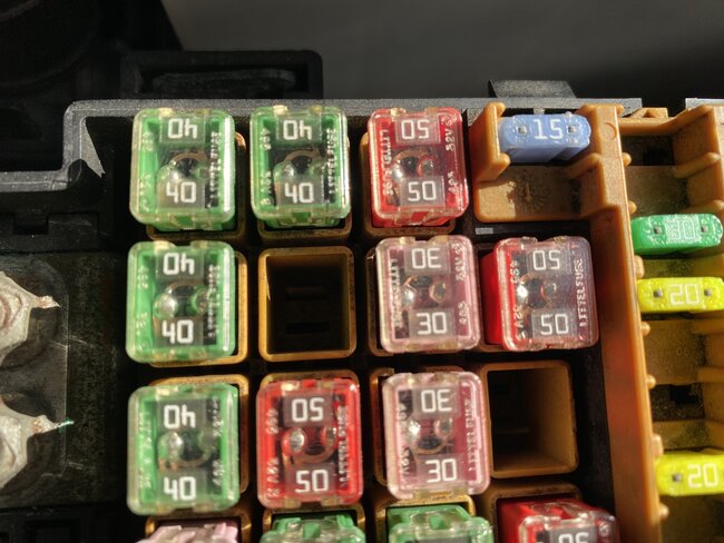

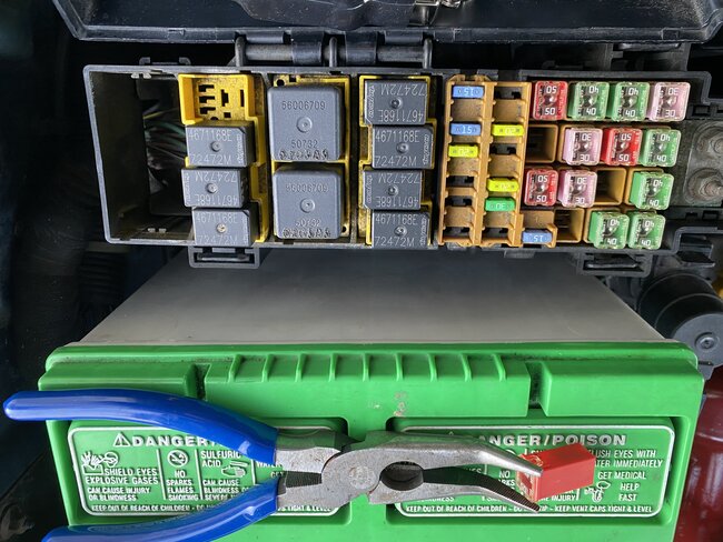

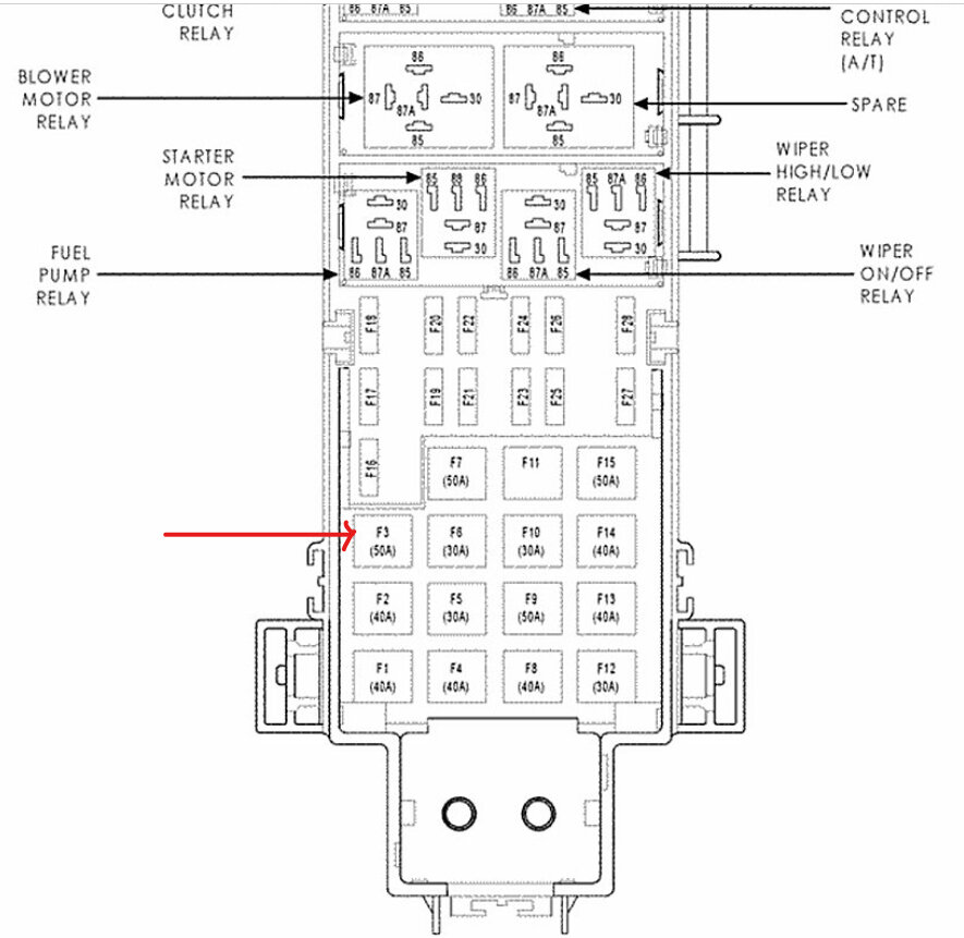

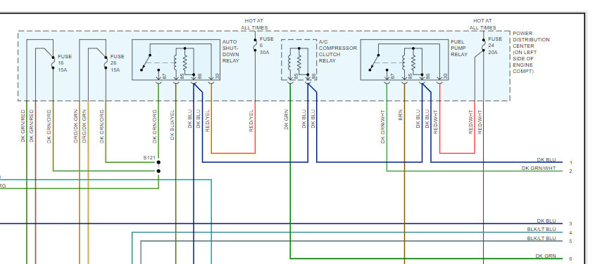

We like to keep the conversation on the web so others can benefit from it, sorry. We should check to see if fuse #3 is getting power at both terminals. Yes, the PDC is the Power Distribution Center.
Dec 8, 2023 at 4:05 AM
DINESH GOSAIN
  • 75 POSTS

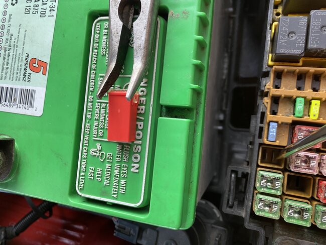

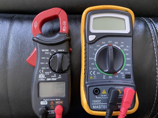

I checked for power with the Cen-Tec multimeter and there was no voltage. Then I put the dial to 200A~ just to see if I got a reading on the amps and no reading. Oh, I had the key in the on position as well. I'll go out and try it with the screwdriver light with the key in the on position.
Dec 8, 2023 at 4:46 AM
DINESH GOSAIN
  • 75 POSTS

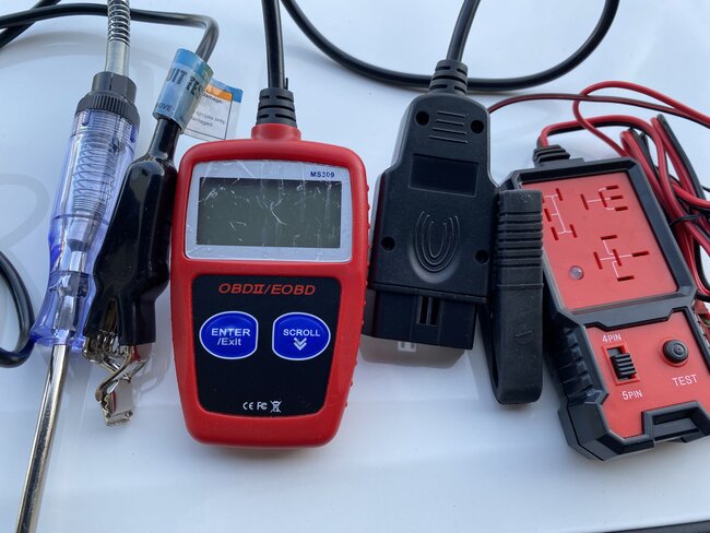

I like the last photo here, it lights up. The bottom pin came on and the top pin did not.
So, would that make the PDC okay? I sure hope so...

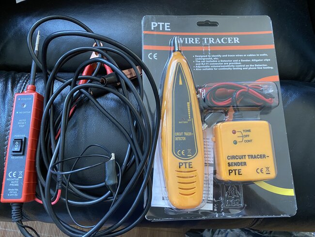

Oh, by the way I don't know how to use the wire testers. I wouldn't know if I was using it correctly or not. No confidence.
Dec 8, 2023 at 5:01 AM
  • 55,412 POSTS
No problem, it looks like the fuse panel has power so if the fuse is good, then it looks like the wire is broken between the two or you have a bad fuse panel. Here are two guides that will teach you how to you a voltameter and how to test the wiring. Please go over them both, it is not difficult.

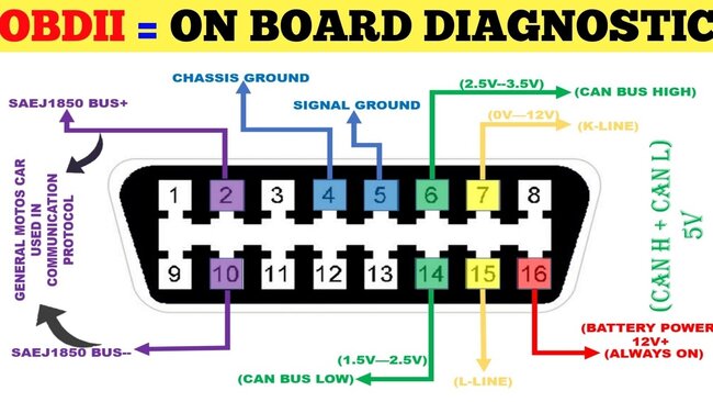

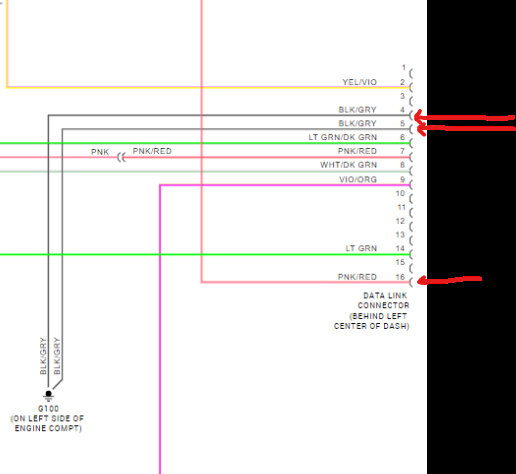

I checked the OBD2 pins 4,5, and 16. 4 and 5 are ground and 16 is power 12V. I got a reading of 4.21 from pin 16+ and I check it with pin 4,5-. So, what does that mean? I have a little bit of power coming to pin 16. I also took the 2 screws out that hold the OBD2 and checked the wires in the back of it. I didn't see any broken wires there. In fact, they look new.
Dec 18, 2023 at 6:14 AM
  • 55,412 POSTS
We can only upload the diagrams in half because they will be unreadable. Does the scanner work on other cars? If so, check all of the fuses to make sure that they are good, can you upload a short video of the problem so I can see?

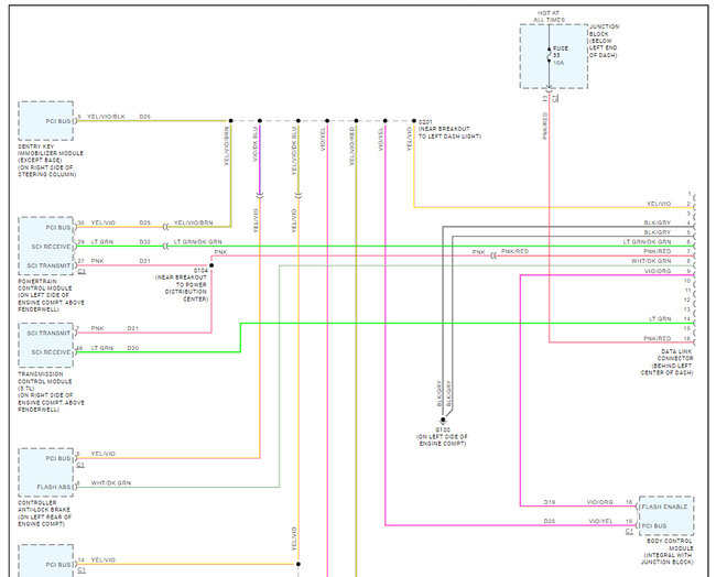

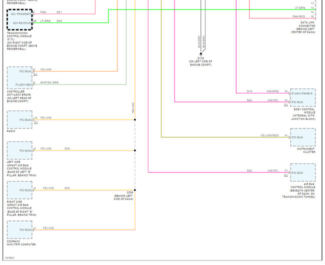

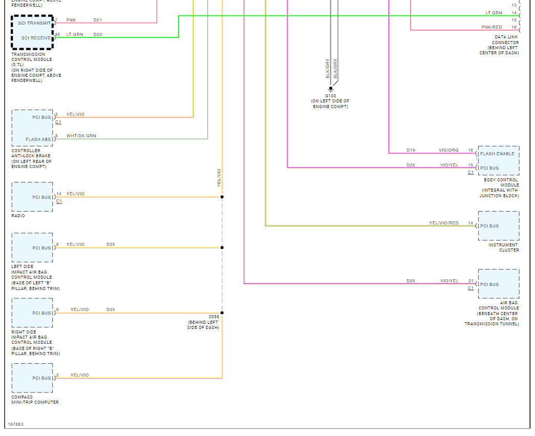

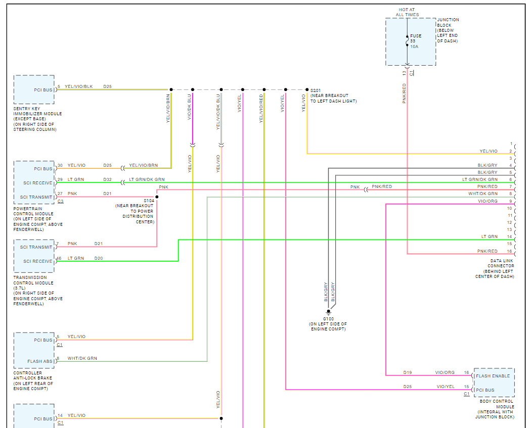

I sent ground wiring locations/diagrams as requested. We get our information from ALLData and Mitchell 1, Here are the wiring diagrams for the diagnostic connector.
This guide will help you with the wiring testing:

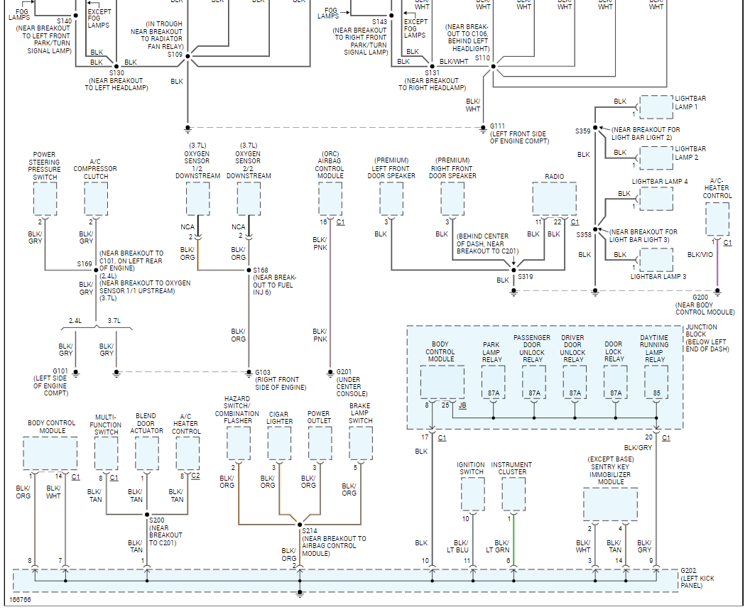

Thank you for sending these two diagrams. You had previously mentioned that you have to send the diagrams divided due to their size. How should I put them together, meaning does page two go under page 1 or the side as you sent them. Also, if you could advise the same for the previous diagrams you sent that would be great.
Thanks again Ken.
Dec 21, 2023 at 11:50 PM
  • 55,412 POSTS
Yes, the top one over the bottom diagrams is how they go together. One goes over the other.

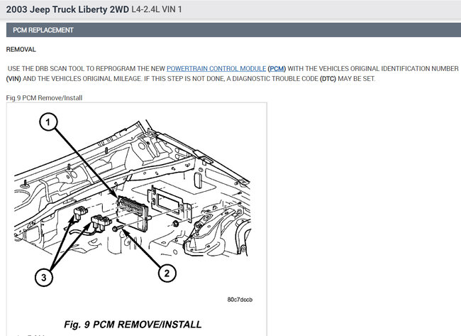

Okay, thank you. I tested my OBD2 reader and it works on other cars. Would you by any chance know where I might be able to get a PCM. I've tried eBay, car computers and they did not work. I have to get this Jeep started. I hope we can do that. Thanks.
Jan 2, 2024 at 10:33 PM
  • 55,412 POSTS
Sure, here is a line of them in the search, just pick one that has good reviews.
https://www.google.com/search?q=2003+jeep+liberty+pcm&oq=2003+JEEP+LIBERTY+pcm&gs_lcrp=EgZjaHJvbWUqBwgAEAAYgAQyBwgAEAAYgAQyBwgBEAAYgAQyBwgCEAAYgAQyBwgDEAAYgAQyCAgEEAAYFhgeMggIBRAAGBYYHjINCAYQABiGAxiABBiKBdIBCDE5ODFqMGo3qAIAsAIA&sourceid=chrome&ie=UTF-8

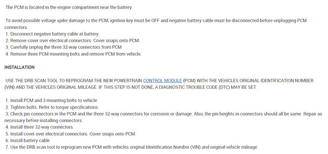

Here is the location and how to change the PCM out. Check out the images (below). Please let us know what happens.

Hi Ken,
I know to change the computer. I have used All Computers, car computers, and one from eBay. I don't know why none of them worked.

Let's check the main power to the PCM. Here is what powers the PCM so you can check it out, I would try swapping out ASD relay as well. Check out the images (below). Let us know how it goes.

Do you have power to the pink and red wire on the OBD2 connector?

I checked the OBD2 pins 4, 5, and 16. 4 and 5 are ground and 16 is power 12V. I got a reading of 4.21 from pin 16+ and I check it with pin 4, 5-. So, what does that mean? I have a little bit of power coming to pin 16. I also took the 2 screws out that hold the OBD2 and checked the wires in the back of it. I didn't see any broken wires there. In fact, they look new.
Mar 5, 2024 at 5:17 AM
  • 55,412 POSTS
It seems like the port has power and ground this just leaves the PCM that is not reporting to the scanner. I would try removing the PCM and send it in for testing, you can find a place that does this by searching google or Ebay.

Okay, you remember that I replaced the PCM twice and it didn’t work. In the past I checked the OBD2 pins 4, 5, and 16. Pins 4 and 5 are ground and 16 is power 12V. I got a reading of 4.21 from pin 16+ and I checked it with pin 4, 5 which are ground.

Okay, do you have power and ground at the data port connector?
This guide can help:
