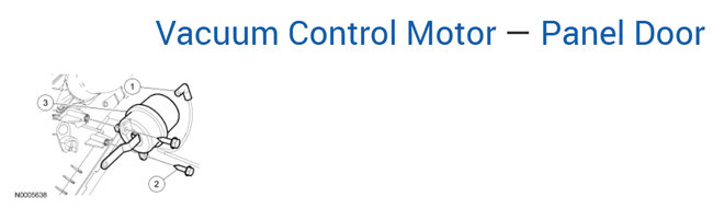

On the HVAC problem: Yes, I know but the line could have a crack under the hood, I would inspect the supply line from the engine to the firewall. There is also a vacuum reservoir under the hood that should be checked as well. Please upload a video in your response of the problem. Sorry, for some reason they are not showing the vacuum line diagrams. Check out the images (below). Please let us know what happens.
