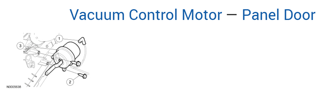

I seem to have an occasional vacuum leak as when driving in the summer with ac on and I climb a hill, the flow rate from my center dash vents stops. When I throttle back, the ac discharge returns. I suspect a leak drives the mode actuator to switch to defrost vents. I also note that there are occasional downshifting issues under load that causes a rough shift. Mileage is a bit lower than I expected too though on long high-speed trips Mileage seems normal. Engine is in xlnt shape. Virt. No oil consumption and phaser timing done at 120K.
Ideas on likely leak sources? Seems hard to find a vacuum chart for this limited engine. Car has dual HVAC controls and the 6R80 transmission.

On the HVAC problem: Yes, I know but the line could have a crack under the hood, I would inspect the supply line from the engine to the firewall. There is also a vacuum reservoir under the hood that should be checked as well. Please upload a video in your response of the problem. Sorry, for some reason they are not showing the vacuum line diagrams. Check out the images (below). Please let us know what happens.

I tested the black and white check valve that serves to vacuum supply to the HVAC and EGR. The check valve seemed to not reliably close when I sucked on the white side. I believe it should close when the engine vacuum is low, and the reservoir should hold the mode vacuum. Motor. I replaced the check valve this morning.
Not having a vacuum pump tool, I just sucked on the line after the check valve that went into the firewall. It seemed to hold a vacuum.
This tells me I must have a vacuum leak in the engine bay before the check valve? This is why I need the vacuum line plot for this engine?
The vacuum reservoir for the v8 engine is not in the engine bay iirc. I think it is behind the passenger side kickplate. Since my mouth suck test seemed to suggest that line and its various branches are good, not sure I need to dismantle anything.
I had cleaned the MAF sensor last year to no effect.
I also did replace the egg vacuum motor last year.
Jul 28, 2025 at 4:30 AM
  • 55,412 POSTS
Yes, a bad check valve can cause the problem, did you drive it after to see if the problem is fixed, all HVAC system leak a little bit which is normal.
