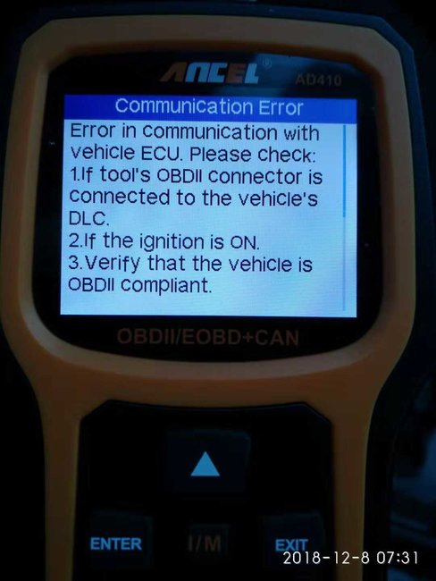

OBDII can be powered on, but can not communicated to ECU
2000 MERCEDES BENZ ML320
70,222 MILES • 3.5L • 6 CYL • AUTOMATIC
PETER HOU
  • 10 POSTS
"Check engine" light on with all other lights when key in position 2.
No broke fuse found.
After smoke check I got a report:
1) Overall Test Result "not ready".
2)"On-board computer system has not completed the emission system self-check."
3) OBDII Monitors Not Ready
* When key in position 2, all lights are on includes "check engine".
** In fuse box, no broke fuse fond.
*** I have used Ancel AD410 and O'Reilly store's OBDII scanners, both were not communicated to ECU.

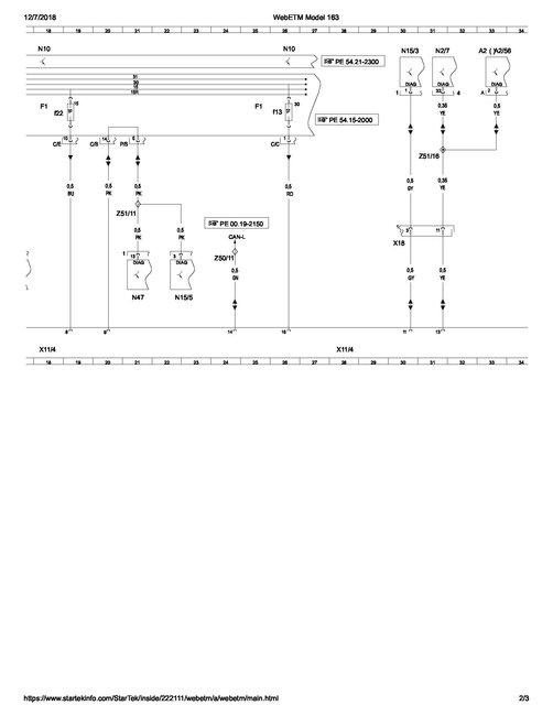

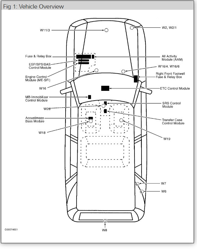

The fuse box is attached to the AAM module, the AAM module is responsible for communication, most likely there might be water or corrosion in the AA. Take it apart and check for water and or corrosion, if none found you will need to check continuity from the OBD port to the AAM and then possible replace the AAM.

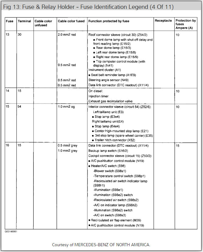

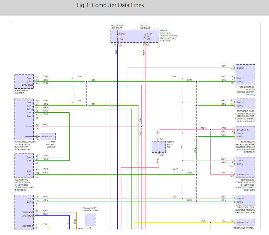

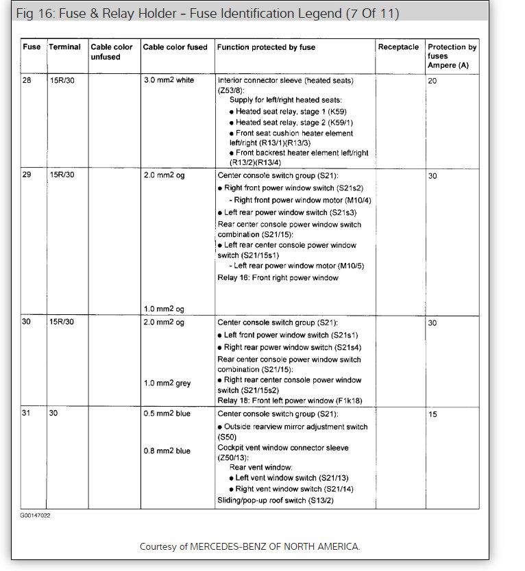

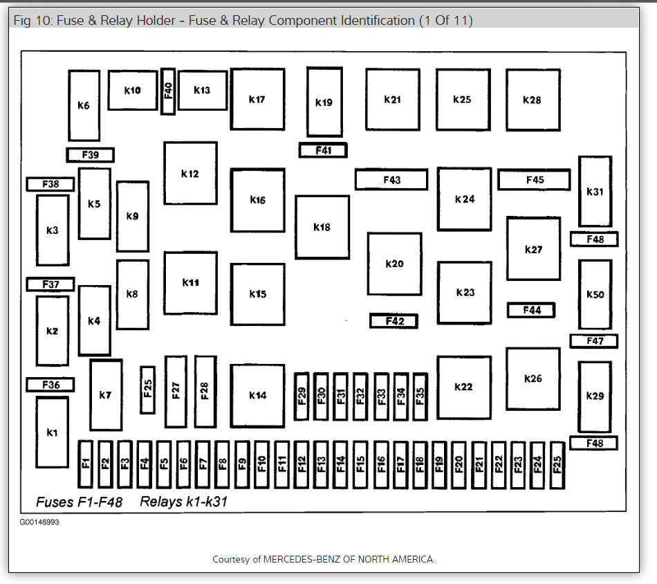

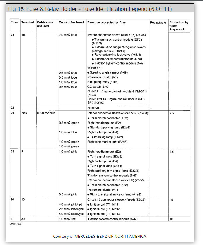

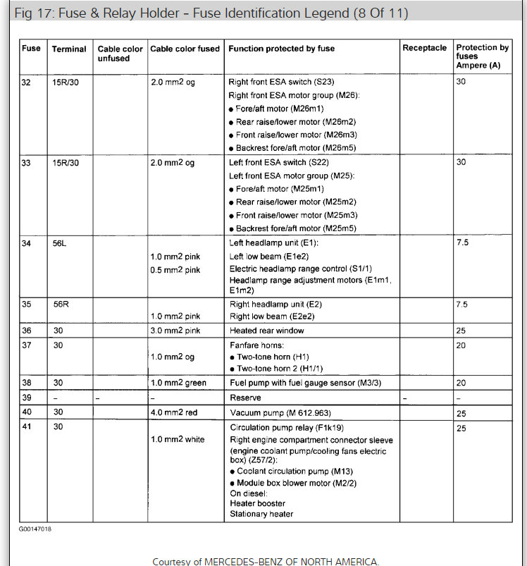

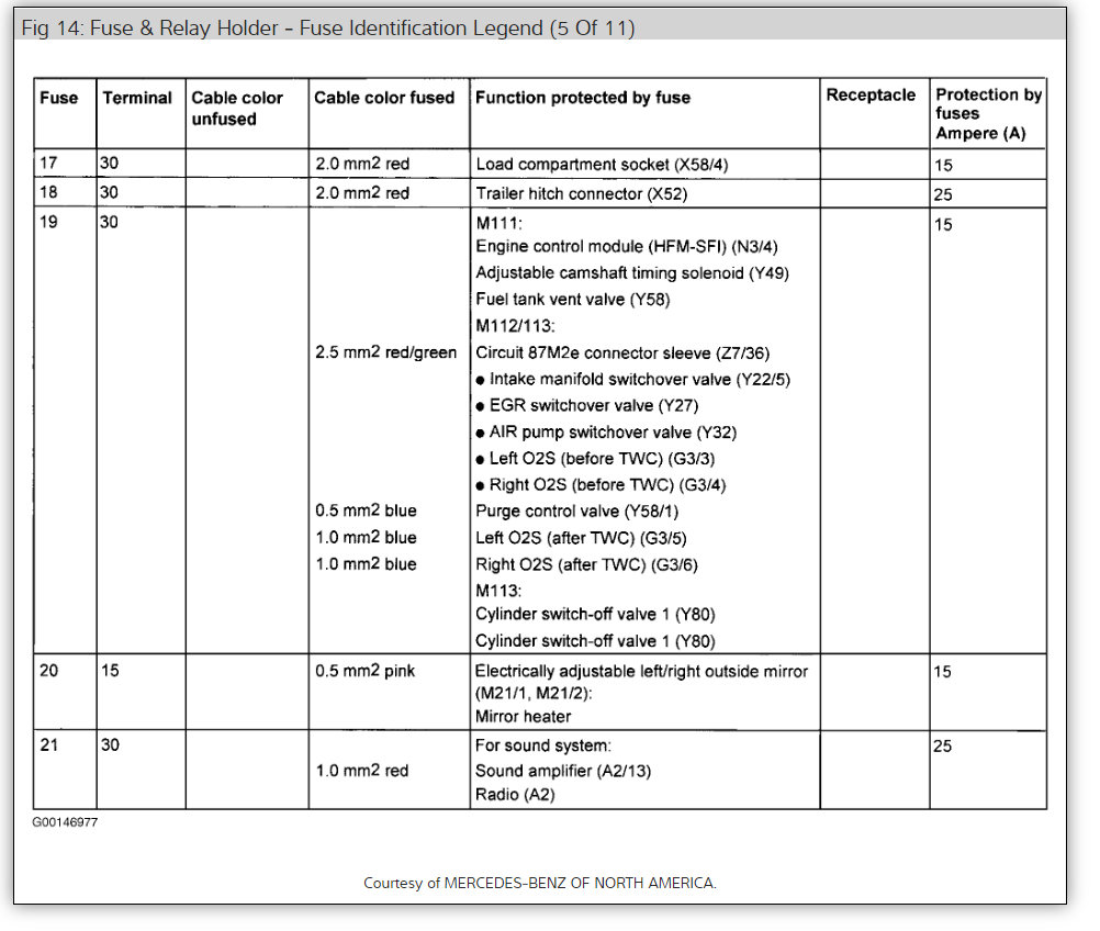

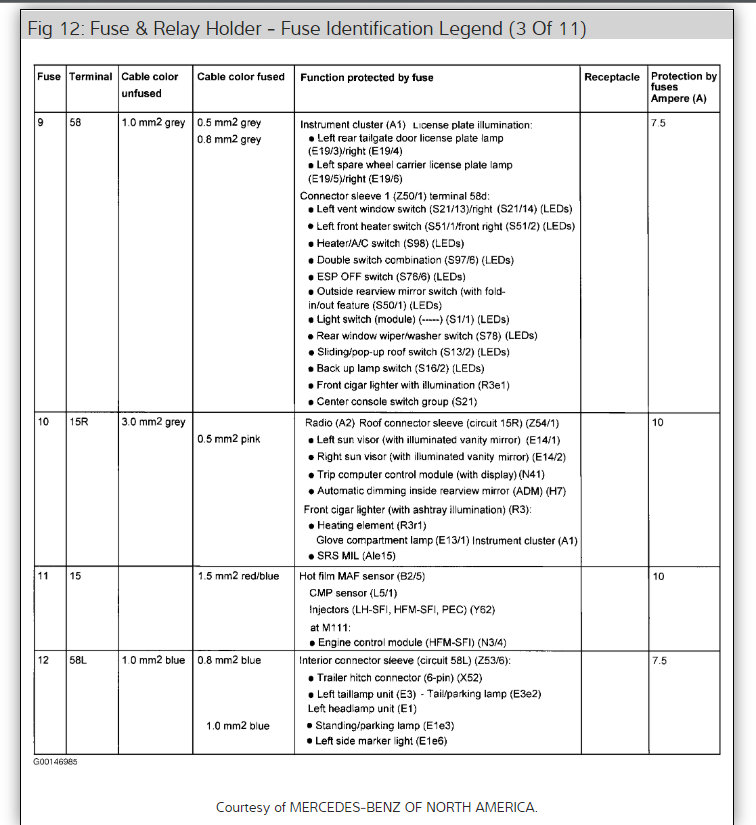

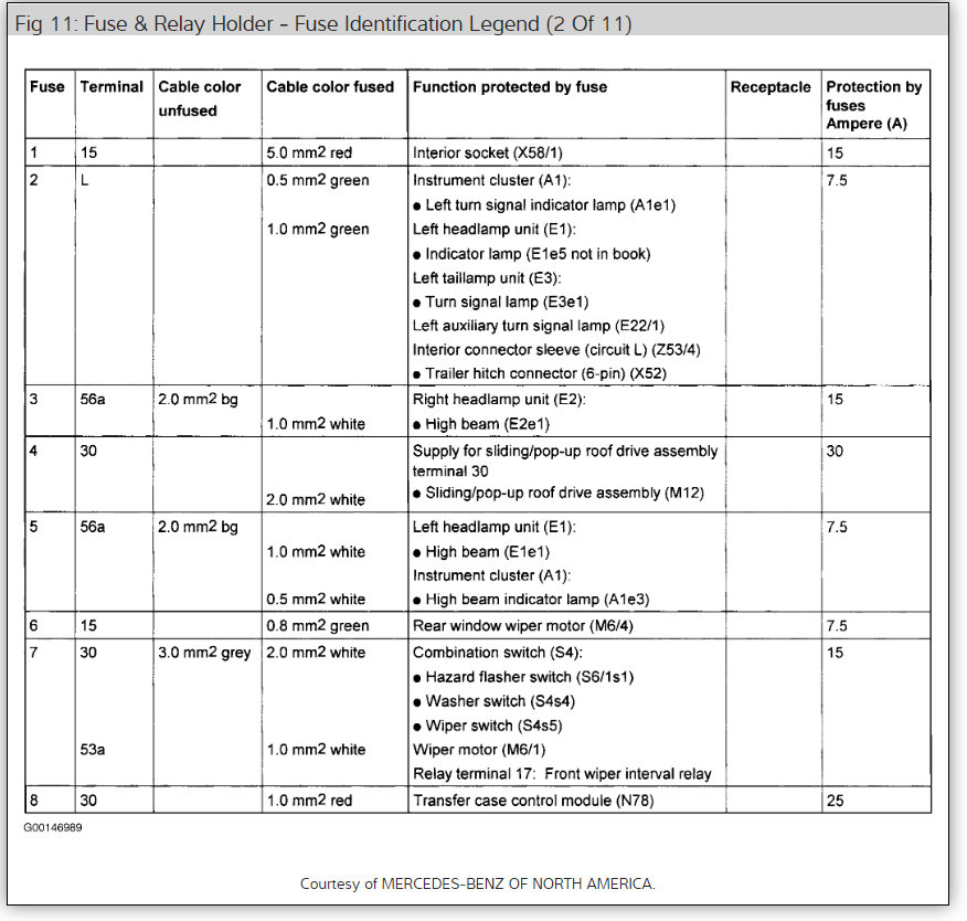

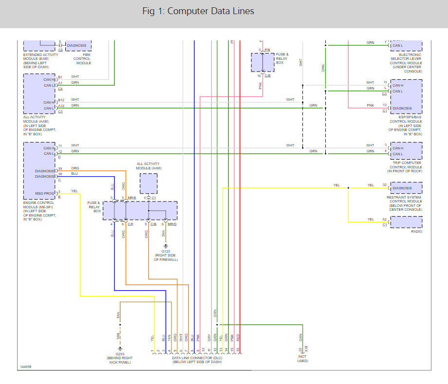

Can we check for power at fuse # 22 and #13. Here is guide to help you and the ALDL connector wiring diagrams so you can see how the system works:
Check out the diagrams (below). Please let us know what you find.

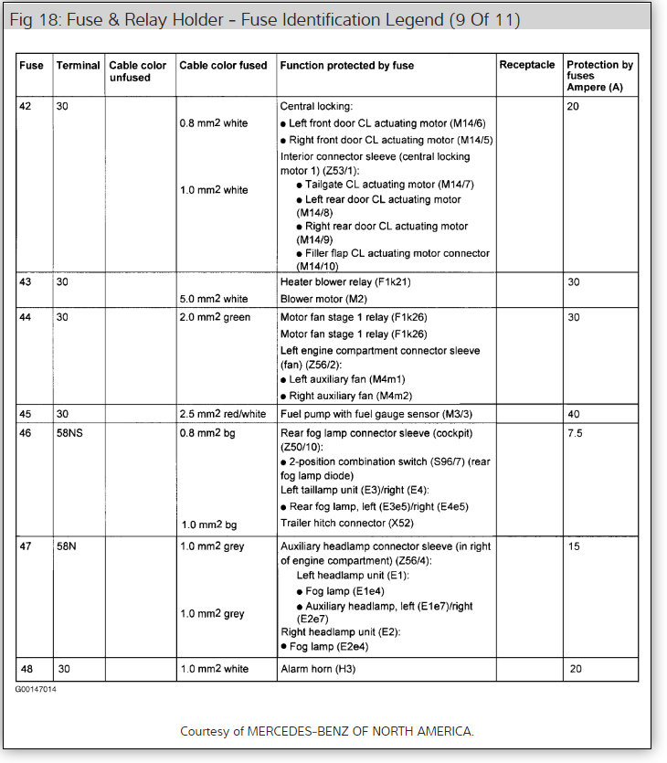

I rechecked all of fuse with key in 2, did as your link, all fuse are good, only F47 there is no power.
I am going to check headlamp housing, if the fog sockets have bad connection.
Anything else I should check over?
Peter
Dec 5, 2018 at 2:49 PM
  • 55,423 POSTS
Did you test #47 with the lights on? Has nothing to do with the non communication. What about fuses # 22 and #13?
Dec 6, 2018 at 1:39 AM
PETER HOU
  • 10 POSTS
Hi, Ken,
All fuses are good, voltmeter made beep sounds at both ends of each fuse, including 22 and 13, except #47 (front fog lamp). I turned the switch rod to the fog position no lights on, I believe it should be yellow lights. So, I think maybe there is a bad connection? What do you think?
Dec 6, 2018 at 4:12 AM
  • 55,423 POSTS
Yes, it does sounds like a bad connection to the ALDL connector. Here is a guide to help you run some test use the wiring diagrams above:
Dec 7, 2018 at 1:00 AM

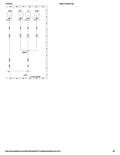

Peter, what kind of scan tool are you using?
On our OBD port the AAM handles most of the communication but if you are using a generic scan tool you are only accessing the engine module and the engine module can be the issue.
You need a Mercedes capable scan tool such as the icarsoft or startool found at www.mbstartool.com
or a high end Snap on or Matco.
With Mercedes there is no such easy task as no communication.
Having power at the OBD port is just a fraction of the things that need to be present.

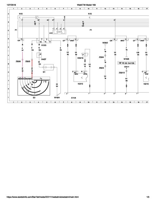

The wiring diagrams for the ML also changed every year so I would need the build date to get you the correct diagram for the car.
Also the diagrams are not easy to read if you are not familiar with them.
Here attached is the one for the 2000 built between 11/99 and 9/00.
Hope this helps.
It might be best to take this in, based on your replies you are shooting in the dark with your testing and it might be best. It can save you time and money having someone with Mercedes knowledge assist with this.

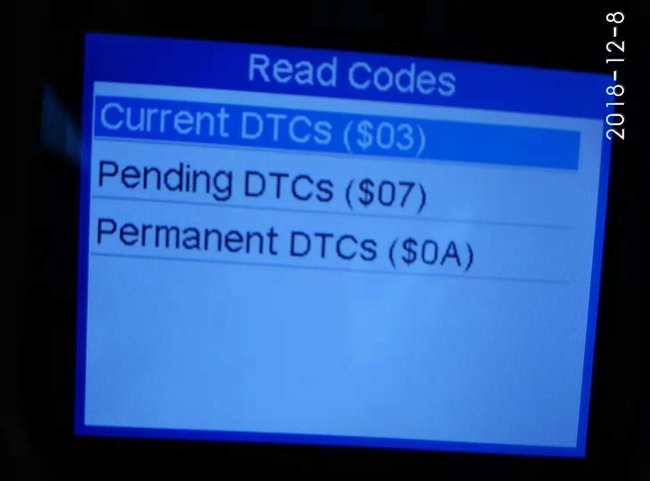

OBD II can be powered on.
Check engine light can be on with all other lights when key in position 2.
There no codes showed. (Visual Inspection PASS ?)
"There no communication to ECU ",
(see picture from OBD II Ancel AD410, as well as from O'Reilly Auto Parts's OBD II Botch.)
Thanks
Peter

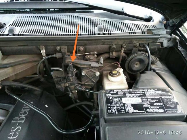

PETER HOU
  • 10 POSTS
Hi, All,
Is the communication successful? I did not see my OBD II show the lines before.
If it is, that means I fond it !
The wire is bad.
What is the part's name?
See two pictures,
Thanks all.
Dec 8, 2018 at 1:10 PM
  • 55,423 POSTS
That looks like an EVAP system control solenoid. Remove the unit it should have a part number on it. Nice work fixing the communication problem.

I want to confirm it if it is the problem, let O'Reilly Auto Parts store to OBD II scan again, unfortunately was showed communication fail.
And I checked it at home with key in position 2,
OBD II show the DTC again :
Review DTC >
Pending DTC's ($07) >

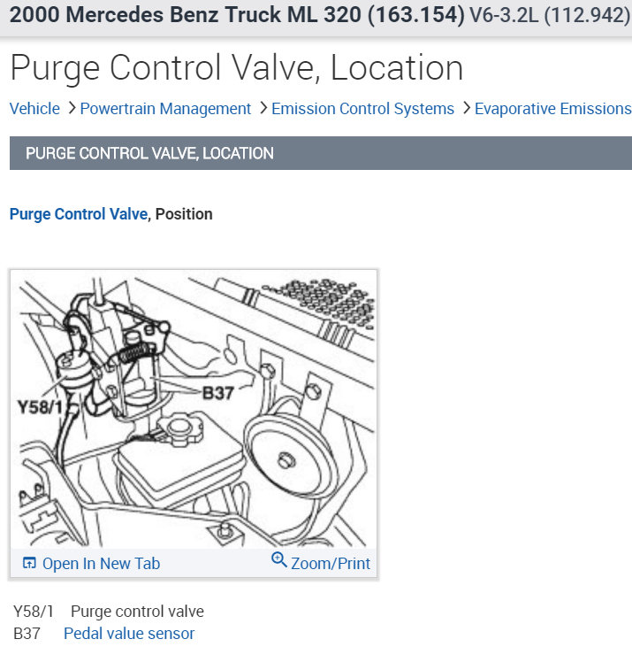

P0443 EVAP System Purge Control Valve A Circuit
Hi, Ken,
Should I replace the EVAP Purge Solenoid Control Valve ?
Dec 10, 2018 at 4:11 AM
  • 55,423 POSTS
Yes I would replace the purge solenoid and then clear the codes. Here is the location below.
