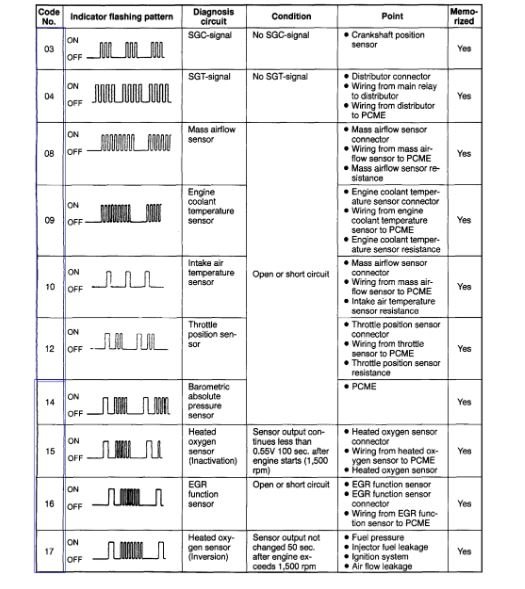

Can you send me the obdi check engine codes for the car listed above 1.6l dohc?
Thanks.
Att. Juan Marin
Jun 4, 2019 at 8:02 AM

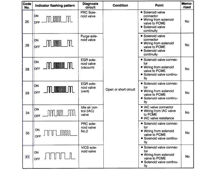

Good afternoon,
I attached a list of possible codes for you to view.

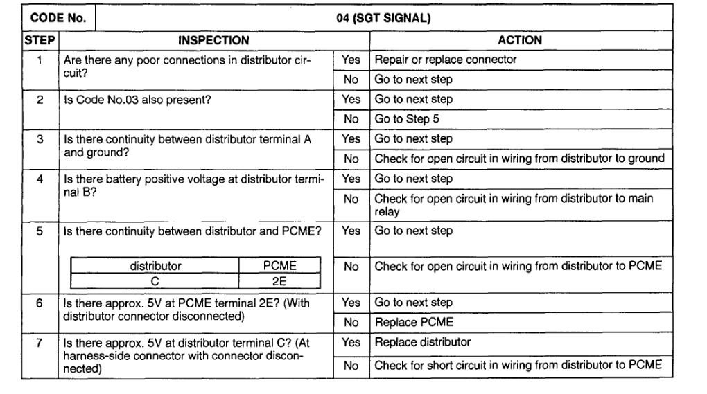

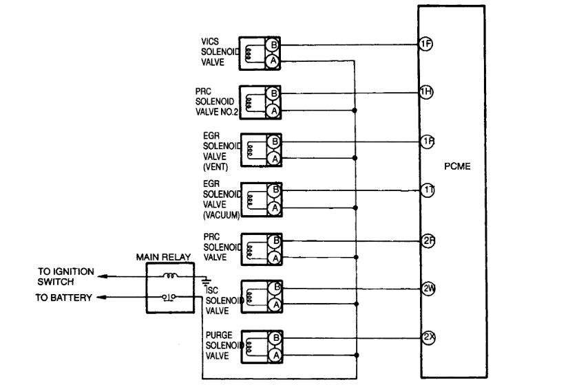

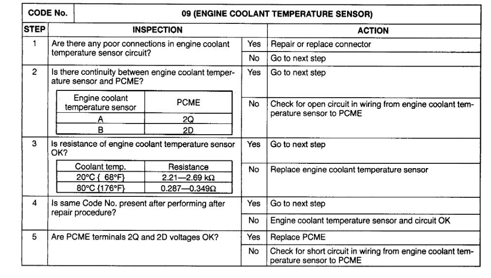

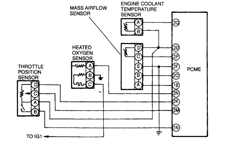

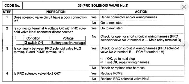

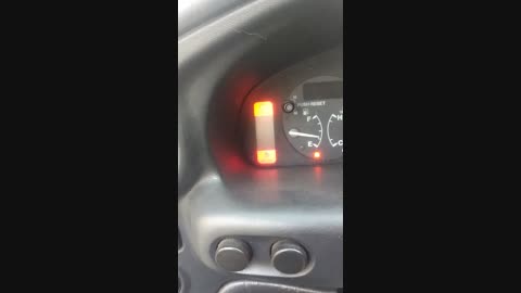

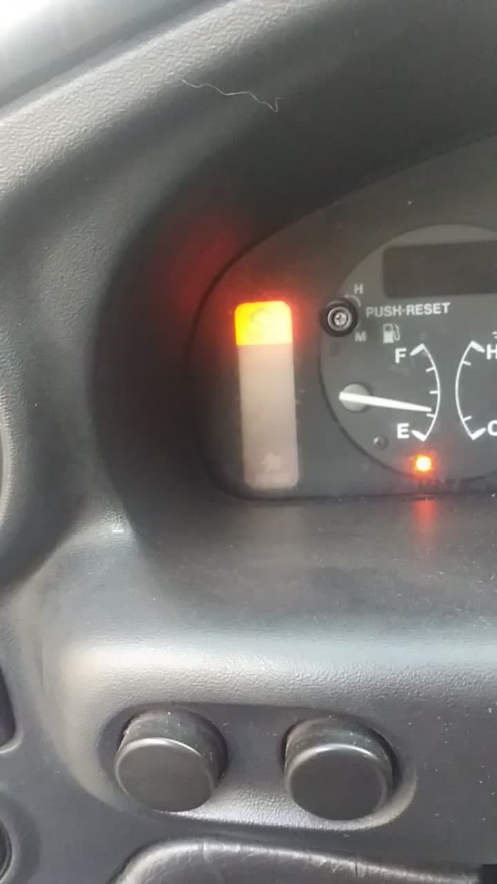

Thanks for the codes.
This are the codes:
4
9
35
41
I'm right??
That's the codes?
Jun 4, 2019 at 1:34 PM

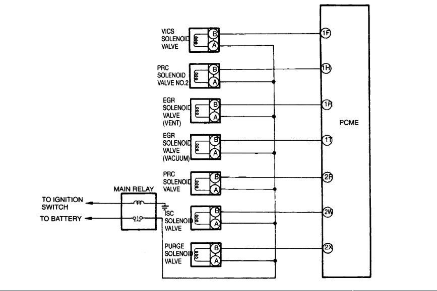

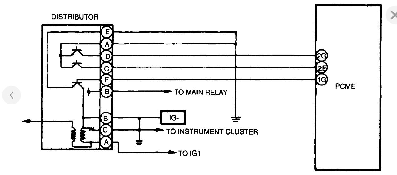

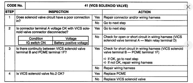

The flow charts for the codes are attached.
