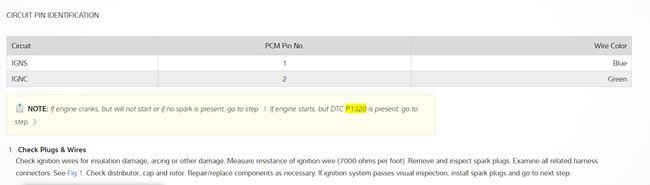

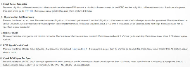

Service Engine Soon light showing. I used my OBD 2 code reader and it showed the following codes: I use a MaxiScan MS309. Below is what is showing on the reader.
Showing 1 of 2
P1320 ($0010)
Manufacturer control
P1320 ($0010pd)

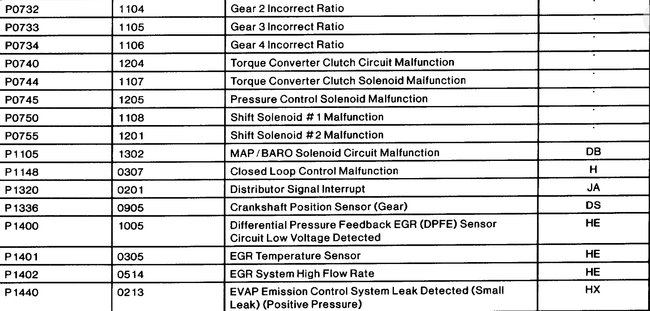

PLEASE, can you tell me what the codes mean? I can get on the internet and lookup what P1320 means, but when I add in the ($0010) I cannot find anything. The same thing happens when I put in ($0010pd).
Feb 25, 2019 at 4:10 AM
SCGRANTURISMO
  • 4,897 POSTS

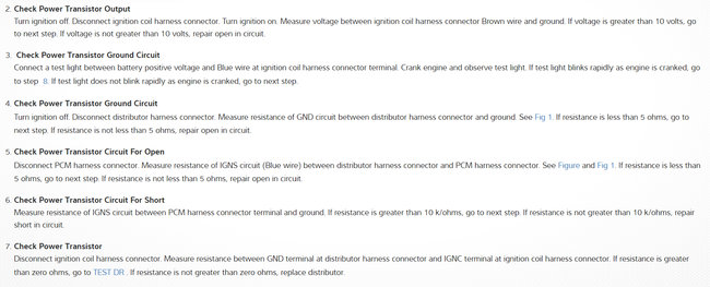

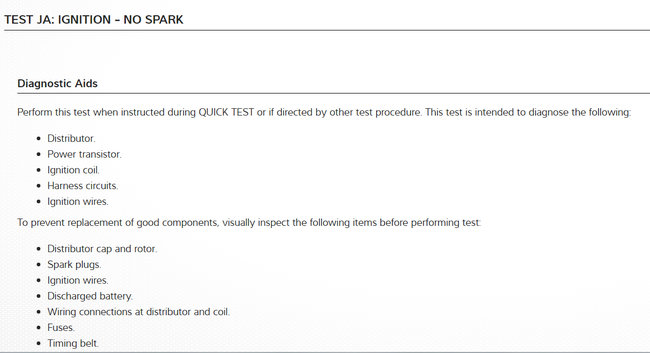

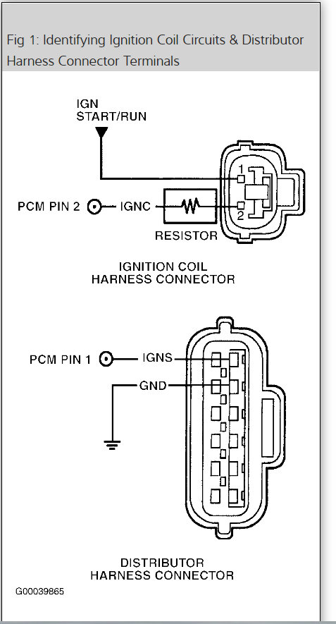

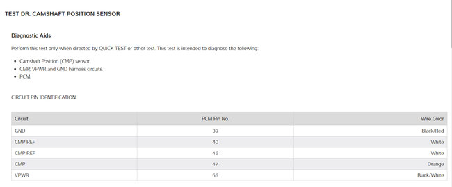

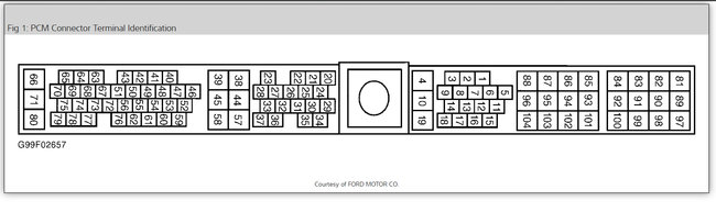

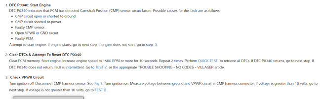

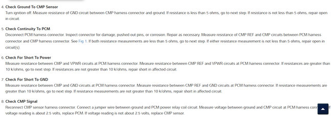

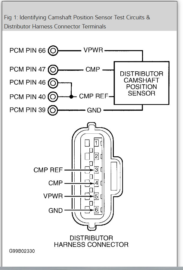

I have included in the diagrams below the definition and step by step troubleshooting for DTC 1320. The PD in the second DTC you pulled just means it is a pending DTC. Let us know what you find out.
Thanks,
Alex
