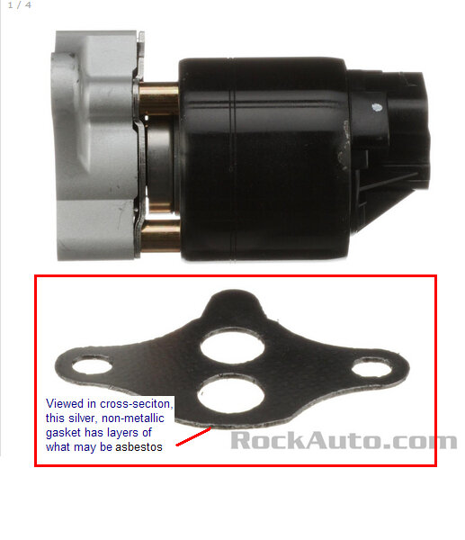

This afternoon, I attempted to remove, disassemble and scrub-clean the EGR, hoping clogged passages are the only problem. Unfortunately, I could not devise a way to take apart the EGR for a more thorough cleaning than simply squirting throttle body cleaner into both passages. Is it possible to disassemble an EGR for this GM engine? I found one TORX-type screw on the bottom-center, which seemed to be spring-loaded, but which simply rotated, and did not unscrew. And where two bolts appeared to pass through the EGR body, there was no visible opening for a nut or bolt head on either side of the body.
This EGR is the electronic type, with only a five-pin connector inserted into its top portion, and no other lines or connectors.
Here is a multi-view graphic for the part:
https://www.rockauto.com/en/moreinfo.php?pk=6698424&cc=1303287&pt=4968&jsn=9

This afternoon, I got the EGR, and plan to install it tomorrow.
Need your opinion on whether to use the stamped metal gasket which came with the part, or use an exact-fit, layered asbestos fabric (?) gasket for the same part, which I ordered separately, in case the EGR did not come with a gasket. The layered, fabric gasket is the more conventional kind of gasket, and may provide a better seal under extreme heat.
Feb 23, 2024 at 7:38 AM
  • 55,721 POSTS
The gasket it came with should work just fine.
