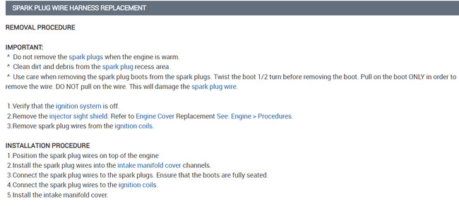

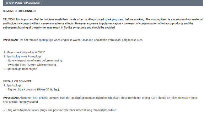

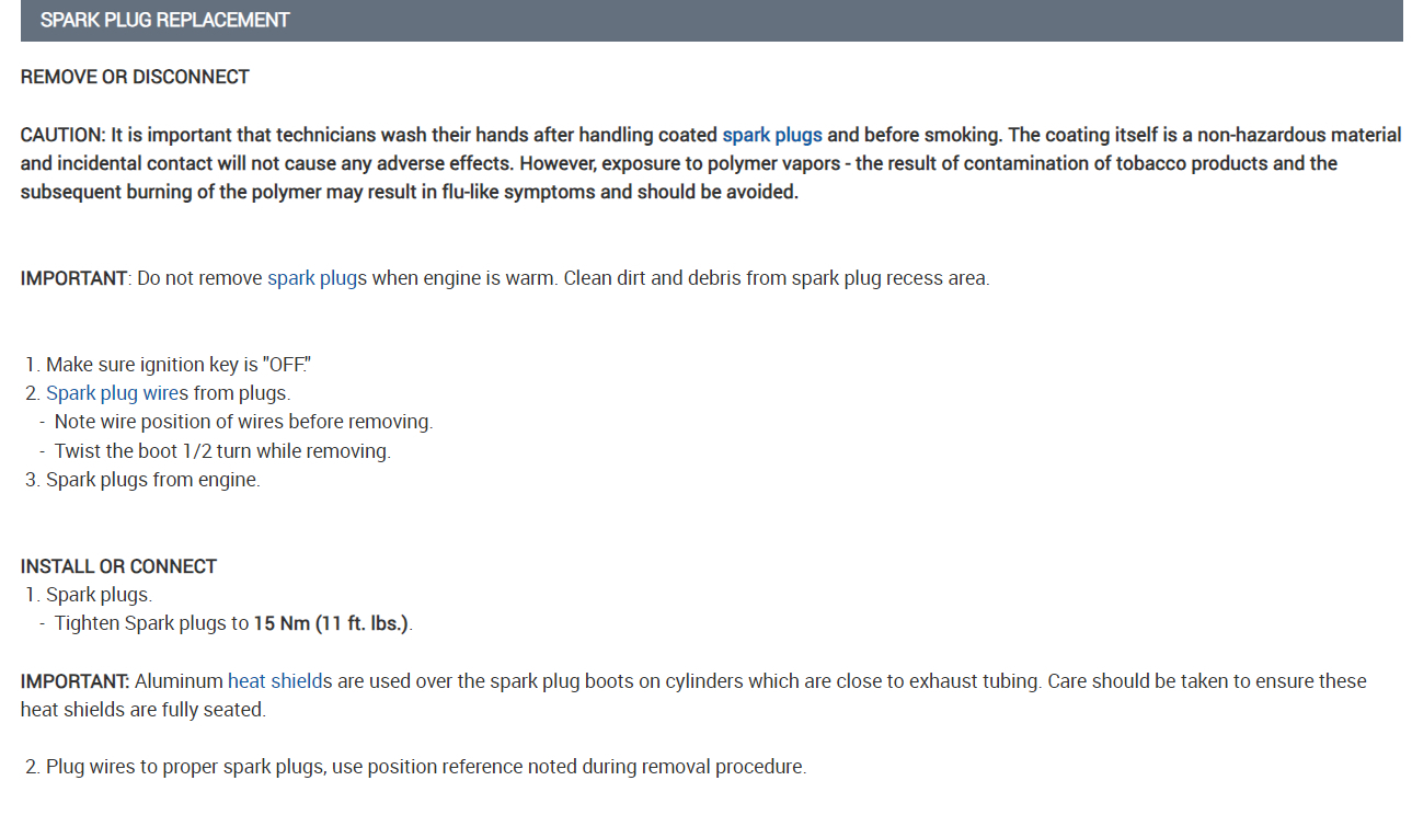

Error P0304-- misfire on cylinder 4. In checking this error with my local auto parts store, I was offered a single spark plug for a replacement, but since the old rule is to replace all plugs at the same time, do you recommend I replace all six plugs? (Of course, I can diagnose with only a single plug to determine whether it makes a difference.)

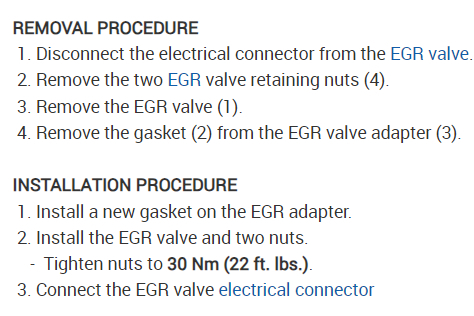

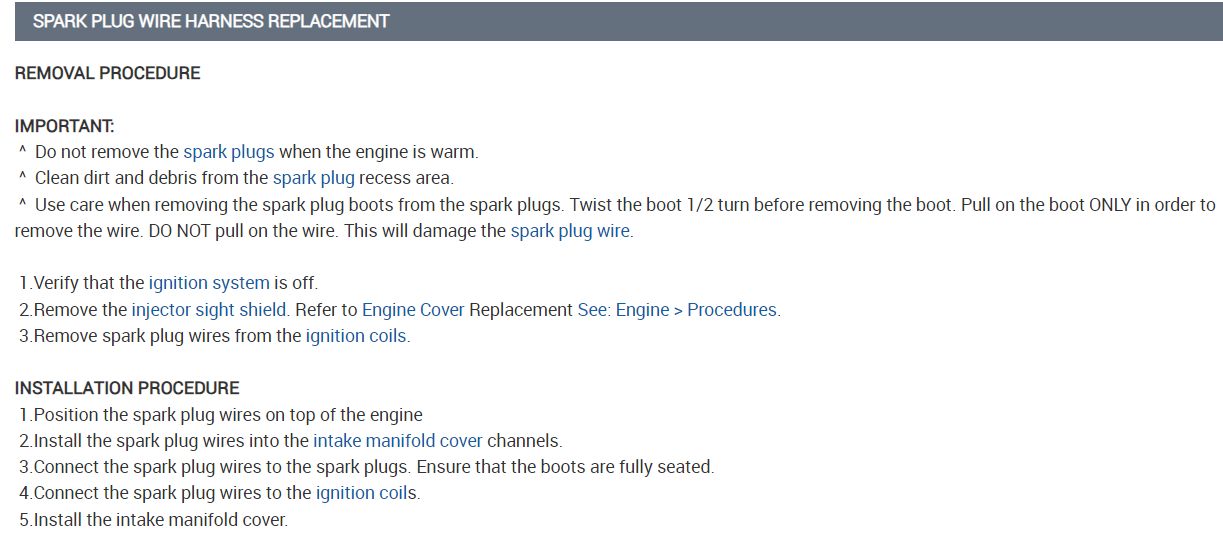

Yes, I would change all of the spark plugs and wires at once. Also, on the EGR I would try cleaning it like you have suggested and if that doesn't work replace the valve.
Here is a guide to help walk you through doing the spark plugs:
https://www.2carpros.com/articles/how-to-change-spark-plugs
AC Type .................... 41-921

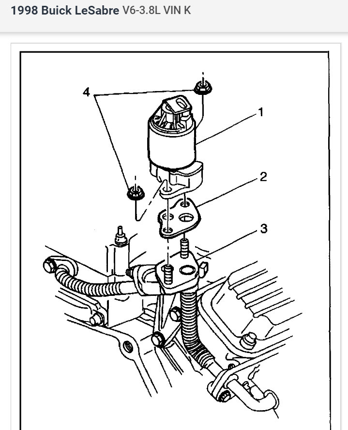

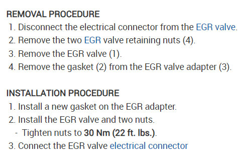

here is the location of the EGR and I can tell you with this type of valve you will probably end up replacing it, but you never know. Check out the images (below). Please let us know what happens.

This afternoon, I attempted to remove, disassemble and scrub-clean the EGR, hoping clogged passages are the only problem. Unfortunately, I could not devise a way to take apart the EGR for a more thorough cleaning than simply squirting throttle body cleaner into both passages. Is it possible to disassemble an EGR for this GM engine? I found one TORX-type screw on the bottom-center, which seemed to be spring-loaded, but which simply rotated, and did not unscrew. And where two bolts appeared to pass through the EGR body, there was no visible opening for a nut or bolt head on either side of the body.
This EGR is the electronic type, with only a five-pin connector inserted into its top portion, and no other lines or connectors.
Here is a multi-view graphic for the part:
https://www.rockauto.com/en/moreinfo.php?pk=6698424&cc=1303287&pt=4968&jsn=9

This afternoon, I got the EGR, and plan to install it tomorrow.

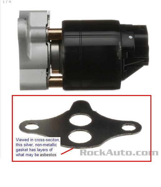

Need your opinion on whether to use the stamped metal gasket which came with the part, or use an exact-fit, layered asbestos fabric (?) gasket for the same part, which I ordered separately, in case the EGR did not come with a gasket. The layered, fabric gasket is the more conventional kind of gasket, and may provide a better seal under extreme heat.
Feb 23, 2024 at 7:38 AM
  • 55,224 POSTS
The gasket it came with should work just fine.
Feb 24, 2024 at 1:29 AM
ALPHAA10
  • 232 POSTS
Ken,
After installation of the EGR, an OBD2 system scan (O'Reilly's) showed no primary diagnostic trouble codes, which is good news. .
