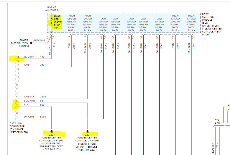

OBD2 Port isn't working. Scanners won't connect, Which fuse do I check?
Jun 24, 2024 at 1:18 PM
  • 110,194 POSTS
The data link connector (DLC) is powered by the HVAC control/ignition fuse in the body control module.
I attached three pics below. Pic 1 indicates the connectors to check:

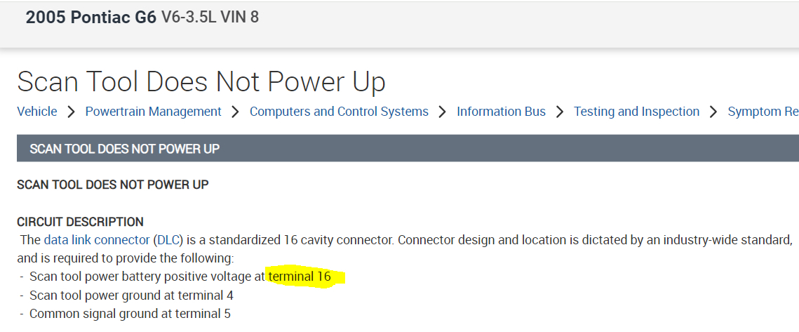

Pin16 for battery power
Pins 4 and 5 for ground.

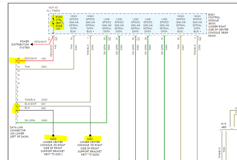

Pic 2 is the schematic to the connector

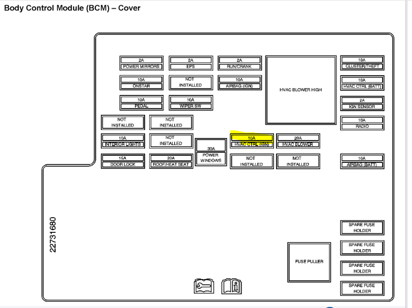

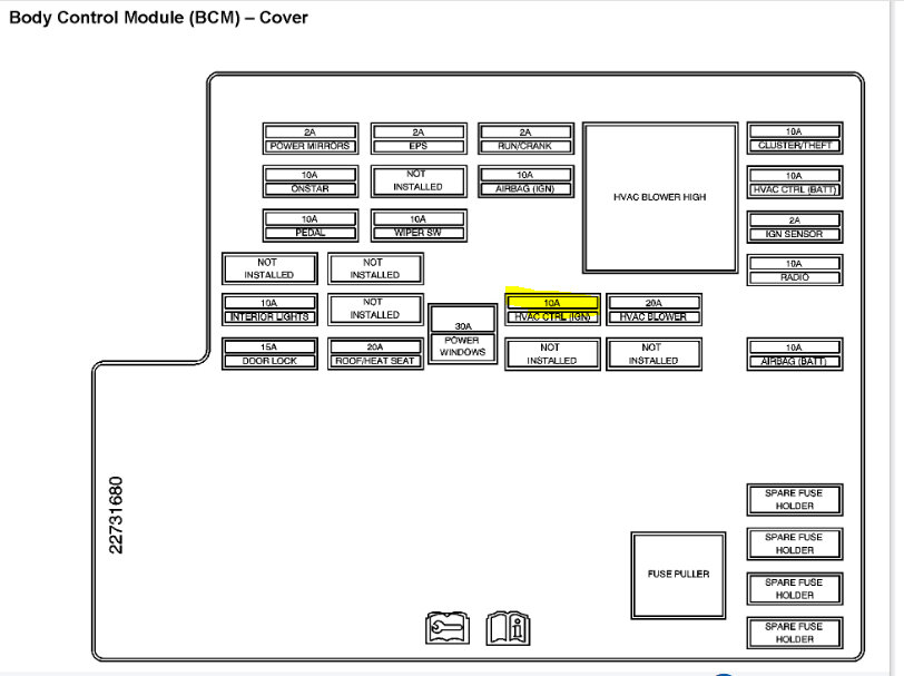

Pic 3 shows the fuse location.
When you check the fuse, make sure there is power to and from it. Note: It should have power at all times.
Let me know what you find.
