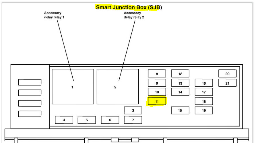

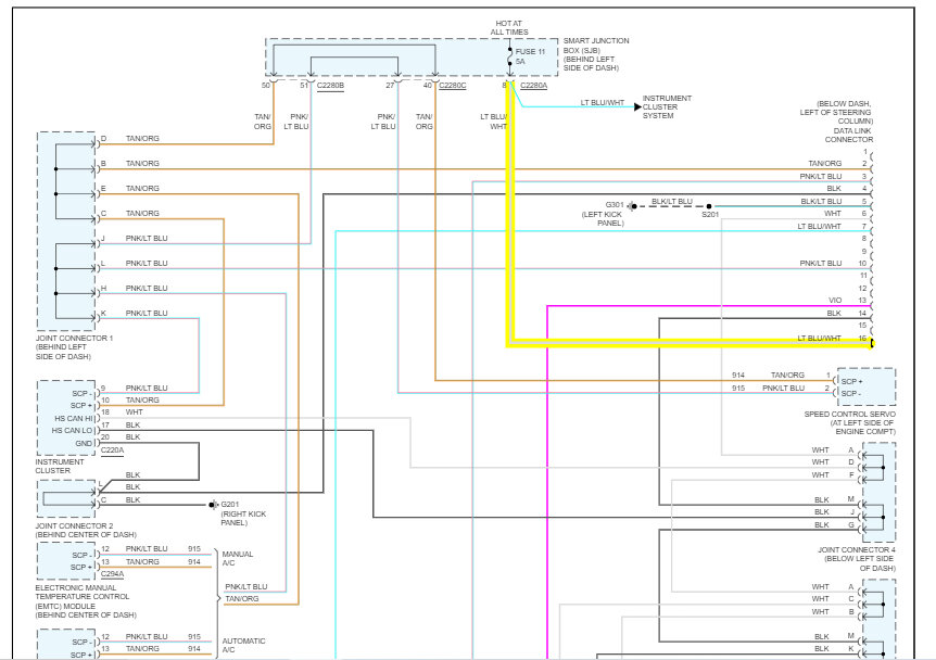

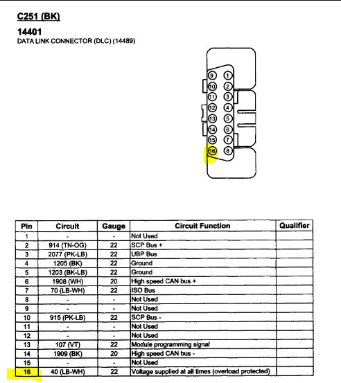

Power to pin 16 on the data link connector (DLC) comes from fuse 11 in the smart junction box under the left side of the dash.
I attached the Computer Data Line information schematic below and highlighted the supply. Also, I attached a pinout of the DLC connector and the fuse location within the box. Remember, pin 16 should have power at all times.
Let me know if this helps.

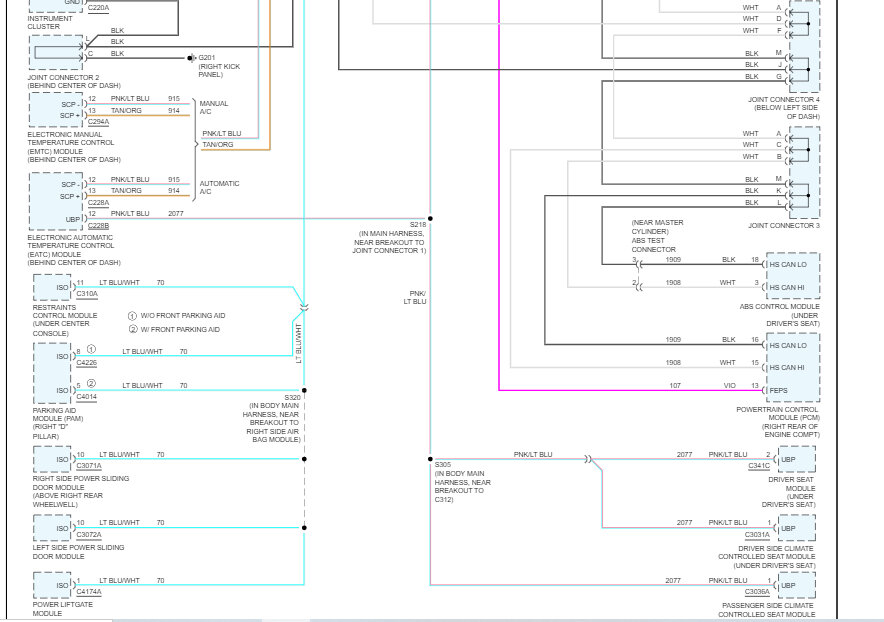

See pics below. Note I had to cut the schematic in half to make it readable.
