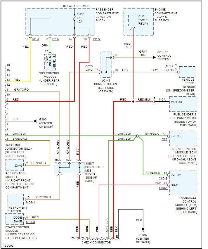

I think that my check engine light port is not working and that my light is not working either. I mean I do not think the light comes on even though there is a problem that should make the light come on. Can u tell me how to find out if my port has power and how to know if my obd2 is working? There are several electrical problems that my car has had for a while like the radio going back and forth from radio to cd just out of nowhere and the high mounted break light(the third brake light)not working. Also a while back someone riged a cable from my fuse box under the hood to my fuse box under my dashboard, and that made the port start working, but the cable fell off and i do not know which fuse it came from and which one it went to in order to try to re-right. So, I need help to check if my obd2 system is working and to fix it if it is not. And the radio and third brake light too but the obd2 is first priority.

It sounds like someone did some creative wiring but here is a guide to help you test for power and ground of the data port. Also, when you turn the key on without starting the engine does the check engine light come on?
Here is the port wiring diagram so you can see how the system works. Please test the red wire for power and the black wire for ground. Check out the images (below). Let us know how it goes. Also check the fuse #25 in the fuse panel inside the car.

Sorry for my late response. I checked the wires and the fuse, and they are good. And the check engine light does come on with key in on position.
Also, recently I had a check engine light come on for two days and then turn off. And also, recently I had to change the camshaft sensor but I never received a check engine light for that.
Also, while checking the fuses, I checked fuses #5,9&18 (ac sw, audio and c/light) for ground and they were showing a dim light. And I think they are related because my ac, audio and high mounted break light have problems. Could probably be something else but I thought I would mention it.

One more thing is that the rig job that was done before to the port had a yellow cable that was cut on the end down by the port and the other end goes to fuse #13(RR HTR) under dashboard. And then the yellow cable continued to the fuse box under the hood. Just thought I would mention it.

Can you please check to see if the red wire going to the OBD2 connector has power and if so, please check the black wire for ground, this guide can show you how:
Does it look like the wiring has been cut or damaged?

Yes, I checked the red one for power and it does have it and there are two black ones and they both have ground. The cables to the port look good, not damaged. But there is a yellow wire next to the connector that has been cut, and I do not know where it went to. But the other side of the yellow wire was rigged to one of the fuses inside the car.
Jun 7, 2024 at 1:24 PM
  • 55,423 POSTS
The yellow wire goes to the data input/output port for the SRS module though the junction box on the passenger side. Please go over the wiring diagrams above to see what I am talking about.
